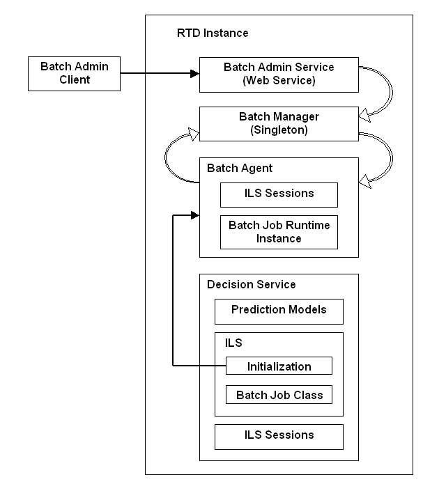

16.1.1 Batch Framework Components
The following diagram shows the components of the batch framework architecture on a single Oracle RTD instance.
Description of bf_arch_ovwx.gif follows
The main batch framework components and their functions are:
  • Batch Admin Client
    The Batch Admin Client provides a set of Java APIs that can be used by Java client applications to manage batches registered on remote Real-Time Decision Servers. This includes starting and stopping batches, and obtaining batch status information.
    Customers may create their own batch client application using the APIs provided in the Batch Admin Client.
    The Batch Console is a client side command line utility that manages batches registered on remote Real-Time Decision Servers. Internally, the Batch Console uses the APIs provided by the Batch Admin Client.
  • Batch Manager
    This is a cluster-wide singleton service, that executes client batch commands from client code from the Batch Admin Client.The Batch Manager manages each Batch Agent in the cluster.
    The Batch Manager also executes commands from the Batch Console.
  • Batch Agent
    The batch agent is the interface between a batch job and the batch framework. It is a service that registers batches with the Batch Manager when the batch-enabled Inline Service is deployed, and executes batch commands on behalf of the Batch Manager.
In a clustered environment, all the batch framework components appear in each Oracle RTD instance. However, the Batch Manager is only active in one of the instances, and that active Batch Manager controls all the Batch Admin Client and Batch Agent requests in the cluster.

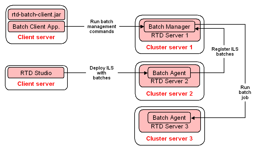

16.1.2 Use of Batch Framework in a Clustered Environment
The following diagram illustrates an example of the use of the batch framework in a clustered environment.
Description of bf_arch_cluster2.gif follows
A batch client application, such as the Batch Console, communicates with the Batch Manager, by invoking batch management commands, such as to start, stop, or pause a job.
Developers using Decision Studio can create and deploy Inline Services with batches to any instance where Oracle RTD is installed, such as that on Cluster server 2.
In a clustered environment, Inline Services are deployed to all servers running the Decision Service.
The diagram shows the Batch Agent on the Cluster server 2 instance registering batches with the Batch Manager.
The Batch Manager can then run batch jobs on any instance, such as that on Cluster server 3, so long as they were previously registered.
