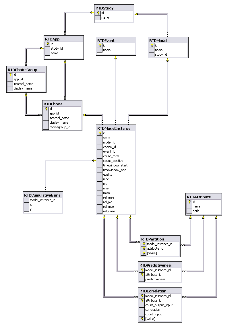

9.2 Model Snapshot Tables Schema
Oracle RTD exports its predictive model data using a multi-dimensional schema as described in the entity relationship model of Figure 9-1, which shows the model snapshot tables (except for RTDSnapshotSchemaVersion, SDDecisionLog, and SDChoiceEventLog), their columns, and the inter-table relationships, as represented by the connector lines.
Each connector represents a one-to-many relationship, from the table at the top end of the connector to the table at the lower end. In the reverse direction, the relationship from the lower table to the top table is one-to-one.
Figure 9-1 Model Snapshot Tables Schema
This image is described in the surrounding text.
The one-to-many relationships between the elements represented by the tables are as follows (each one-to-many relationship implies the corresponding one-to-one relationship in the reverse direction):
Oracle RTD exports its predictive model data using a multi-dimensional schema as described in the entity relationship model of Figure 9-1, which shows the model snapshot tables (except for RTDSnapshotSchemaVersion), their columns, and the inter-table relationships, as represented by the connector lines.
  • Each Study can have one or more Applications, and one or more Models.
  • Each Application can have one or more Choice Groups, and one or more Choices.
  • Each Choice Group can have one or more Choices.
  • Each Choice, Event, and Model can have one or more Model Instances.
  • Each Model Instance can have one or more Cumulative Gains.
There are also three many-to-many relationships between Model Instances and Attributes, namely Partition, Predictiveness, and Correlation.

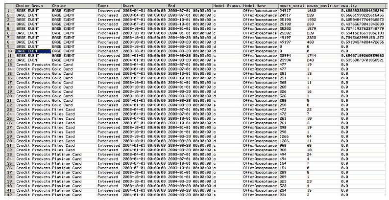

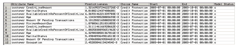

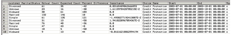

9.5 Creating Reports from the Model Snapshot Data
You can create reports from the model snapshot tables, typically by using standard SQL Select commands, or by sending the data to business intelligence products which produce reports similar to the following product sales driver report:
The rest of this section provides examples of scripts that extract information from several of the model snapshot tables. Each script example is followed by sample output. Notes are provided for some of the examples to help you to interpret the results.

9.5.1 Counts by Choice Query
The following query gets the counts for every Choice, for all time windows:
select g.display_name     as 'Choice Group',
       c.display_name     as 'Choice',
       e.name             as 'Event',
      mi.timewindow_start as 'Start',
      mi.timewindow_end   as 'End',
      mi.state            as 'Model Status',
       m.name             as 'Model Name',
      mi.count_total,
      mi.count_positive,
      mi.quality
from RTDApp a
     inner join RTDStudy s          on s.id=a.study_id
     inner join RTDModel m          on m.study_id=s.id
     inner join RTDModelInstance mi on mi.model_id=m.id
     inner join RTDEvent e          on mi.event_id=e.id
     inner join RTDChoice c         on c.id=mi.choice_id
     inner join RTDChoiceGroup g    on c.choicegroup_id=g.id
where a.name='CrossSell'
order by m.name,
         g.display_name,
         c.display_name,
       mi.timewindow_start
Figure 9-2 shows the results of the Counts by Choice query.
Figure 9-2 Counts by Choice Query Results
Notes on the Counts by Choice Query Results
  1. In row 13, Choice=Gold Card, Event=Interested, count_total=477, count_positive=19, and quality=0.0. This shows that, out of 477 users that were presented with the Gold Card offer, 19 were interested. The counts are small and the model quality with respect to the Gold Card Choice and the Interested Event is 0.
    In row 14, Choice=Gold Card, Event=Purchased, count_total=477, count_positive=1, and quality=0.0. This shows that one user purchased this offer. The model quality with respect to the Gold Card Choice and the Purchased Event is 0.
    Both row 13 and row 14 apply to the period of time from April 1, 2003 to July 1, 2003.
  2. In the columns Choice Group and Choice, the value BASE EVENT means "in general" or "overall."
    For example, in row 1, Choice=BASE EVENT, Event=Interested, count_total=24917, count_positive=1663, and quality is approximately 0.6882. This means that, in the period between the Start and End dates, a grand total of 24917 users were presented offers, and 1663 of these were interested. The overall model quality for this period of time was about 0.69.
    In row 2, Choice=BASE EVENT, Event=Purchased, count_total=24917, count_positive=220, and quality is approximately 0.5666. This means that, for the same period of time as for row 1, there were 220 Purchased events across all Choices, and the model quality was about 0.57.
9.5.2 Top Six Predictive Attributes Query
The following query selects the top six predictive attributes, for each time window, for the Credit Protection Choice resulting in the Purchased Event.
select a.name                'Attribute Name',
       p.predictiveness      'Predictiveness',
       c.display_name        'Choice Name',
from RTDApp app
     inner join RTDChoice c         on c.app_id=app.id
     inner join RTDStudy s          on s.id=app.study_id
     inner join RTDModelInstance mi on mi.model_id=m.id and mi.choice_id=c.id
     inner join RTDPredictiveness p on p.model_instance_id=mi.id
     inner join RTDAttribute a      on a.id=p.attribute_id
where app.name         = 'CrossSell'
  and   c.display_name = 'Credit Protection'
  and   e.name         = 'Purchased'
  and   m.name         = 'OfferAcceptance'
  and   7 > (select count(*)
             from RTDPredictiveness p2
             where p2.model_instance_id = p.model_instance_id
               and p2.predictiveness > p.predictiveness)
order by mi.timewindow_end desc,
          p.predictiveness desc
Figure 9-3 shows the results of the Top Six Predictive Attributes query.
Figure 9-3 Top Six Predictive Attributes Query Results
9.5.3 Difference Between Expected and Actual Counts Query
The following query shows, for people of different marital statuses, the number who actually purchased credit protection and the number who were expected to do so. The report also shows the difference between the two values, and the importance of the correlation for the offer acceptance.
select cor.value               'customer MaritalStatus',
       cor.count_output_input  'Actual Count',
       mi.count_positive*cor.count_input/mi.count_total 'Expected Count',
  100* (  (mi.count_total*cor.count_output_input)
        / (mi.count_positive*cor.count_input) - 1) 'Percent Difference',
       cor.correlation         'Importance',
from RTDApp app
     inner join RTDCorrelation cor  on cor.model_instance_id=mi.id
     inner join RTDAttribute a      on a.id = cor.attribute_id
    and a.name         = 'customer MaritalStatus'
        cor.correlation desc
Notes on the Difference Between Expected and Actual Counts Query
  1. The Actual Count, cor.count_output_input, is the actual number of people who purchased credit protection, for each marital status.
  2. The Expected Count is a simple linear projection of the total count of each marital status, cor.count_input, to those that purchased credit protection, as expressed by mi.count_positive/mi.count_total.
  3. The Percent Difference is 100 * (Actual Count - Expected Count) / Expected Count.
Figure 9-4 shows the results of the Difference Between Expected and Actual Counts query.
Figure 9-4 Difference Between Expected and Actual Counts Query Results
Notes on the Difference Between Expected and Actual Counts Query Results
  1. There are two rows for each marital status, each corresponding to one of the two time periods, April 1, 2003 - July 1, 2003 and July 1, 2003 - October 1, 2003.
