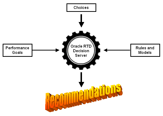

The overall principles and underlying elements described in the job hunting example are incorporated as basic features of Oracle RTD, as shown in the following table:
| Questions in the Decision Making Process | Oracle RTD Features |
| What are your choices? | Choices |
| What are your goals? | Performance Goals |
| What are your criteria for evaluating those goals? | Rules and Models |
The following diagram shows a high-level overview of how these features interact to fulfill the basic objective of Oracle RTD, namely to provide recommendations from a number of alternatives or choices.
For more information on these features and how to use them in Oracle RTD, see the following sections:

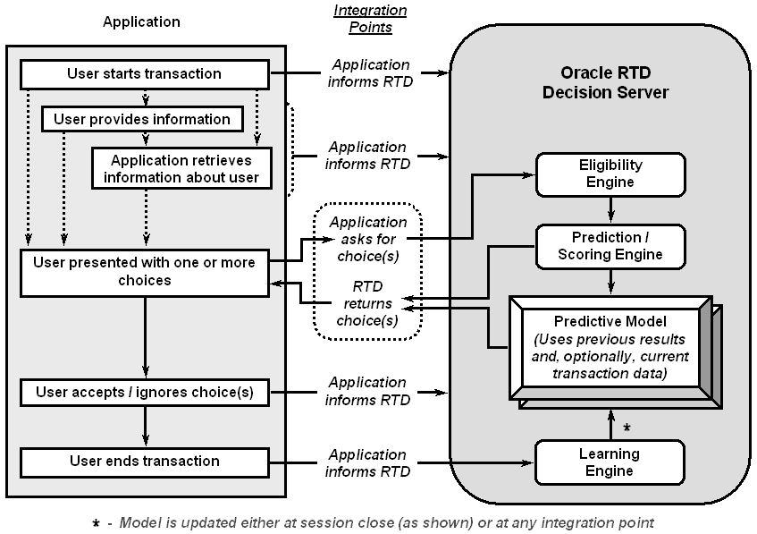

In general, Oracle RTD connects with other applications, and passes its recommendations to these external applications. See the next section for more information about how Oracle RTD integrates with external applications.
Applications that you develop to interact with Oracle RTD are referred to as external applications. Typically external applications consist of many processing steps and stages. The points at which external applications communicate with Oracle RTD are generically known as Integration Points.
There are two main types of Integration Point:
An Informant is a process that passes data from the external application to Oracle RTD
An Advisor is a two-way process, that both passes data from the external application to Oracle RTD, and also receives data sent back from Oracle RTD to the external application
Advisors are the main method by which an external application requests and receives recommendations from Oracle RTD.
Each external application can have many Informants and Advisors.
Many applications are based on a dialog with a user, which leads to the application presenting alternative strategies or choices to the user.
Typically, the dialog between the application and the user proceeds as follows:
The user starts a transaction.
The application retrieves information about the user.
Optionally, the user provides extra information concerning the transaction.
The application presents the user with one or more choices.
The user accepts or ignores the choice or choices.
Optionally, the previous two stages may be performed several times during the course of the transaction.
The user ends the transaction.
To determine which choices to present to a user, external applications can use various factors, such as:
Profile information about the user
Current information about the transaction
The user's preferences, if known
Past activities or transactions associated with the user
User access method, such as the Web or a custom interface
Time of day, month, or season
Oracle RTD provides a set of tools that can analyze all these factors, and recommend the best choices to the external applications. Through these recommendations, Oracle RTD enables the companies that run the external applications to make better business decisions.
Figure 3-1 shows, in outline form, how a typical application interfaces with Oracle RTD.
Figure 3-1 shows one Advisor and four Informants, the Informants corresponding to the following key stages in the application:
The user has started the transaction.
The external application has acquired more information about the user.
The user has accepted or rejected a choice.
The user has ended the transaction.

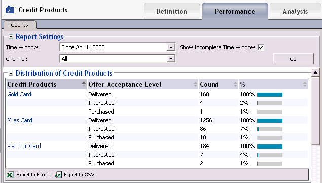

Choice Group Performance Counts
The Choice Group Performance Counts shows the total counts for each choice or choice event occurrence in a choice group.

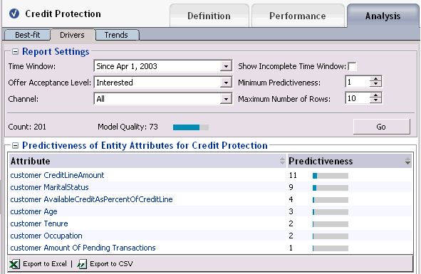

Choice Analysis Drivers
The Choice Analysis Drivers report identifies the attributes that are influential as drivers of predictiveness for each of the choices.
Predictiveness is a measure of the relationship strength between entity attributes, that are the model input, and choice and choice events, that are the model output.
A drilldown on any of the attribute hyperlinks will reveal additional reports about the attribute values themselves.

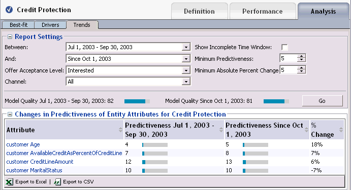

Choice Analysis Trends
The Choice Analysis Trends report shows the change of predictiveness for each of the attributes for a choice over two selected model time windows.

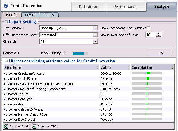

Choice Analysis Best Fit
The Choice Analysis Best Fit report shows all the attributes and values that are most likely to predict the specified event outcome.
