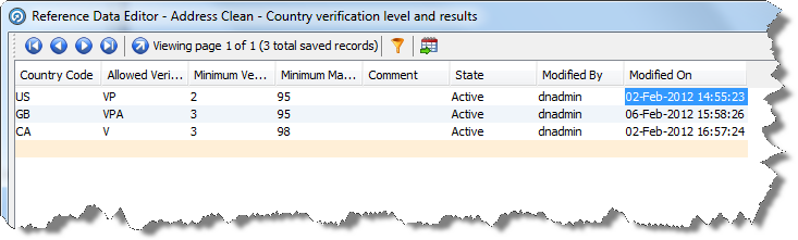

It is also possible to configure Address Cleaning on a per country basis, although this is not done using the Run Profile, see Section 2.4, "Address Cleaning Properties."The initialized Latin reference data and the cdslists-initialized-full.zip
file (supplied in the config.zip
file and located within the oedq.local.home/landingarea/cdslists/
directory) together contain initialized reference data for all supported languages.

The extent to which EDQ-AV can verify addresses varies depending on the country. Additionally, address data from certain countries may be trusted more than data provided for others.
To allow for this, it is possible to set different parameters for address cleaning on a per-country basis.
To set the required parameters:
Open the Director client.
In the Project Browser, select EDQ-CDS > Reference Data.
Open the Address Clean - Country verification level and results Reference Data.
In the Reference Data Editor, change the default settings for US, GB and CA, and add additional rows and settings for other countries as required.
Click OK to save changes, or Cancel to abandon.
Note :
For further details of the Verification settings, see Oracle Enterprise Data Quality Customer Data Services Business Services Guide.This section describes how to initialize reference data and start and stop real-time processes and jobs.
