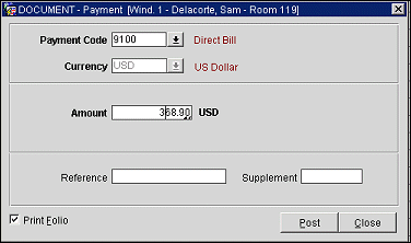

To check out to direct bill, select the Check Out (or Settlement) button from the Billing screen. The Payment screen appears, provided the active Billing screen window has a non-zero balance. (See Payment for details on using the Payment screen.)
Use the Payment Code field LOV to select the direct bill transaction code. (The direct bill payment code will not necessarily be called "Direct Bill". The transaction code attached to the Cashiering>AR Settle Code application setting determines which transaction code is used for the direct bill payment method.)
