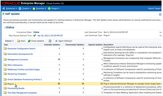

To download Enterprise Manager for Oracle Tuxedo, do the following steps:
1.
From Enterprise Manager console, click Setup > Extensibility > Self Update in the upper right.
2.
In the Self Update page, check if Connection Mode is Online; if not, click Connection Mode status to set online mode.
Figure 2‑1 Self Update Page

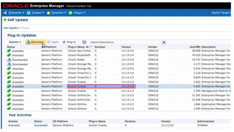

3.
In the Type column, click Plug-in, and then select Oracle Tuxedo of version 12.1.0.3.0.
Figure 2‑2 Plug-in Updates List
4.
Click Download.

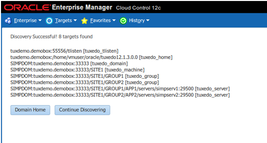

If only one domain is being monitored by tlisten, you will get a list of discovered targets; otherwise, select the domain on the page that appears and enter the parameters specific to the domain, then click Discover Now again.
Figure 2‑3 Successful Discovery

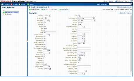

Administrative Functions for Tuxedo Targets
Enterprise Manager for Oracle Tuxedo allows you to perform administrative functions for Tuxedo Targets, such as starting up the target, configuring UBB parameters, shutting down the target, and so on. The administrative functions are listed in the target control menu.
For example, you can modify the UBB parameters for a Tuxedo domain target by right-clicking the domain target name in the Target Navigation panel and then clicking Control > Modify UBB.
Figure 2‑4 Modify UBB Page
