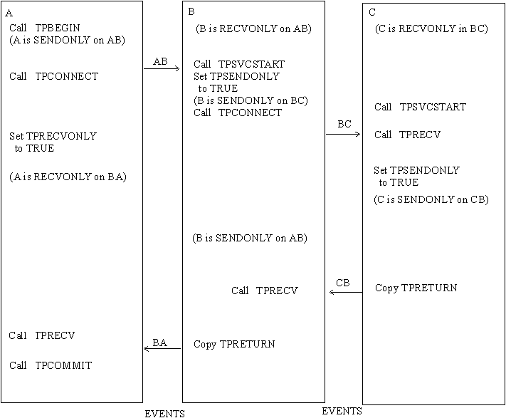

Figure 9‑1 illustrates a conversational connection hierarchy that includes a global transaction.
