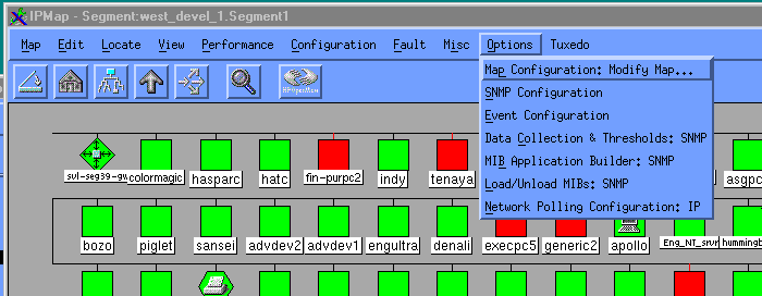

3. If you have not already done so, load the Oracle SNMP Agent bea.asn1 MIB file into your management framework.
a. Select Options−>Load/Unload MIBs: SNMP.Figure 4‑1 Selecting Load/Unload MIBs in HP OpenView

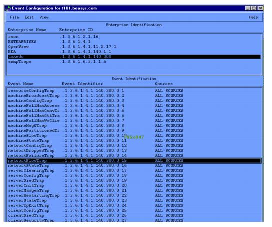

a. Select Options→Event Configuration.
b. Select the enterprise tuxedo.
c. Select an event type, such as networkFlowTrap in HP Open View.
d. Customize the management framework response to incoming events of that type. Select Edit→Modify Event in OpenView, which invokes the Event Configuration window shown in the following display.Figure 4‑2 HP OpenView Event Configuration WindowIn this example payrollagent is a logical agent name that identifies the agent to which the request is to be forwarded by the Oracle SNMP Agent Integrator.A polling rule is defined by a RULE_ACTION entry in the Oracle SNMP Agent beamgr.conf configuration file.
