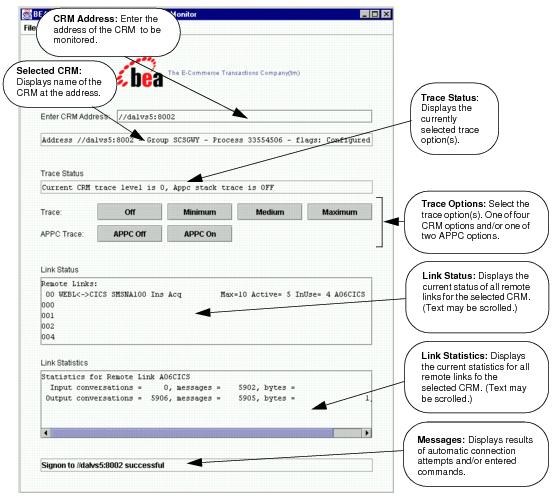

            | • | Choose Programs|BEA Weblogic E-Business Platform|Oracle Tuxedo Mainframe Adapter for SNA 10g R3|CRM Monitor  from the Start menu. |
      Figure 3‑1 shows an example of the CRM Monitor display.
      where host explicitly specifies the CRM host machine and
port specifies the port number of the CRM on the CRM host machine.
            | • | Stop CRM Trace disables CRM tracing and closes the trace file, if it exists. This option is trace level 0  as described in the Trace Options section for the “CRM”  command. |
            | • | Set Minimum CRM Trace establishes tracing of only major events. This level is sufficient only to determine the sequence of application conversations. This option is trace level 1  as described in the Trace Options section for the “CRM”  command. |
            | • | Set Medium CRM Trace establishes tracing of major events plus tracing of all I/O buffers. This option is trace level 2  as described in the Trace Options section for the “CRM”  command. |
            | • | Set Maximum CRM Trace establishes tracing of major events and all I/O buffers, plus tracing of all APPC verbs. This option is trace level 3  as described in the Trace Options section for the “CRM”  command. |
            | • | Start APPC Stack Trace establishes tracing of the APPC stack. This option generally shows the parameters and results of all API calls. Depending on the stack being used, other options such as vendor-specified environment variables also may have to be activated. This option may be selected along with any of the previous Trace Options. This option corresponds to the -s  option as described in the “CRM”  section. |
