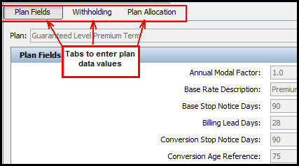

Plan Data has three panes: Plan Fields, Withholding and Plan Allocations. The fields that display on each pane can also be edited.
Plan Fields: Field data is extracted from the PlanScreen business rule and the values are stored in AsPlanField. Plan fields data represents the information that is generic to the plan, such as limits, factors, fees, etc. This information is then available to rule and transaction configuration via math or calls to the database via SQL statements. Refer to Plan Data Fields for more information on updating field information.
Withholding: The Withholding field data is extracted from the WithholdingScreen business rule and the values are stored in AsWithholdingField. The Withholding information represents the default Plan level withholding that will be applied to disbursements if policy or activity withholding is not defined.
Plan Allocation: Allocation data is extracted from the AllocationScreen business rule and the allocation values are saved in AsAllocation. The allocation information represents the default plan level allocations that will occur when plan allocations are defined via configuration. There are two options in Allocation Default Method and Model Supported Method. System Codes have either OIPA or NBU or both. (This determines what all the functionality we want to use for this plan.

Plan Data Tabs
