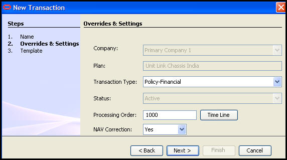

  1. Enter the following items: (Refer to Transaction Type and Processing Order for further information.)
    1. Select the transaction type.
      • A plan type transaction, such as Plan-Financial, when processed will apply to all policies in that plan. The plan type transaction will reside in the Plan Transactions folder under Transactions in the Main Explorer.
      • A policy type transaction, such as Policy-Financial, when processed will apply only to the policy it is added to. The policy type transaction will reside in the Policy Transactions folder under Transactions in the Main Explorer.
      • Client transactions when processed will apply to the specific client and will reside in the Company | Plans folder in the Main Explorer.
      • Client-Relationship transactions only apply to primary and secondary relationship types associated with the Customer that the transaction is being processed against. These relationship types are defined in the transaction in step 2 of the wizard.
      • Cycle transactions are processed in a batch during scheduled cycle processing. They will reside in the Cycle Transactions folder under Transactions in the Main Explorer.
      • Intake transactions...
    2. Enter the processing order for the transaction.
    3. Select Yes in the NAV Correction drop down box if the transaction is a financial transaction.
    4. Click Next.

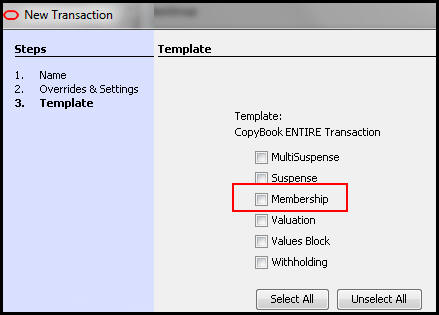

  1. Select the configuration sections needed to create the transaction. Use an entire CopyBook or select only the configuration sections needed to create the transaction. A sample configuration of the sections selected will be given as a starting point when the transaction’s XML file is first opened. All panes are available for configuration regardless of whether the pane is checked or not. Not checking a pane simply means that the pane will be a blank slate.
    1. If an entire Copybook is selected, a Copybook Lookup window will appear. Select the Copybook needed.
    2. If a partial Copybook is needed, click No. Select the individual tags from the list. The tags that are selected will be added to the transaction’s general pane.
    3. If sections are selected a sample of the configuration will be given as a starting point.
    4. All panes are available for configuration regardless of whether the pane is checked.
    5. Not checking a pane simply means that the pane will be a blank slate.

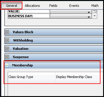

A membership option in the Template section allows a Membership section to appear in the General Pane General Pane of the transaction once it is created.
If this section is added, then at least one membership class must be added to the Membership section before the transaction can be checked-in.
Transaction Wizard with Membership Highlighted
Transaction General With Membership Section
Transaction General with Membership Section
