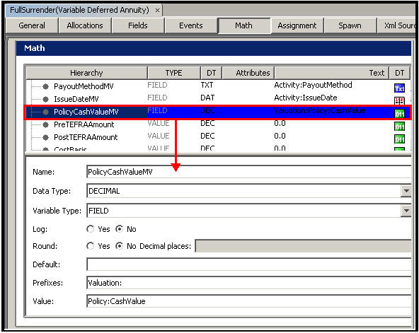

  5. Enter Valuation: in the Prefixes field and all node names separated by a colon (:).
  6. Enter the actual name of the field whose value is desired.
Math Pane of a transaction
Math Pane of a Transaction
