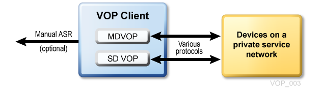

Figure 5-3 shows an example of a configuration using a standalone VOP client. In this customer environment, VOP is directly connected to various devices. This allows for all general VOP functionality. All devices reside on the private service network.
If the ASR component is enabled, then manual case creation can be performed through the DTS protocol to create the case and transfer logs. This protocol is sent through the secure layer.
