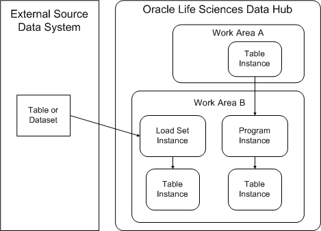

After a Work Area is installed, you can populate its underlying database schema with data in two basic ways:
To load data from an external system, define, install, and run a Load Set (see "Loading Data") in the Work Area.
To operate on data already stored in Oracle LSH, define a Program in the Work Area and map each of its source Table Descriptors to a Table instance in any Work Area in Oracle LSH (see "Operating on Data"). Then install and run the Program.
Therefore it is not necessary to load data into the same Work Area where it will be processed. You can load a set of data to one Work Area and read it from a Program in any Work Area afterward. Figure 3-2 represents data flow options graphically.

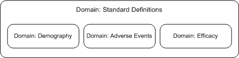

You can use child Domains to organize definitions by type. For example, create a child Demography Domain to store demography-related Tables, Programs, Report Sets, and Data Marts. Create an Adverse Events Domain and an Efficacy Domain, and so on.
You can create these definitions as needed in other Domains and move them to the standard definition Domain when they are ready, or you can create Application Areas and Work Areas inside these Domains for the purpose of creating and testing standard definitions.When you define and run a Load Set for the Oracle Clinical Global Library, the adapter automatically creates an Oracle LSH Domain into which it puts Oracle LSH Variables, lists of values, and Tables that it converts from user-defined Oracle Clinical Questions, DVGs, and Question Groups. For further information, see "Defining Load Sets" in the Oracle Life Sciences Data Hub Application Developer's Guide.

You can define any number of Domains, and each Domain can contain a library of object definitions of any validation status and/or any number of Application Areas. The number of levels of child Domains allowed is determined by your setting of the Domain Nest Value profile; see "Nested Domains" and "Setting the Maximum Number of Nested Domains" in the Oracle Life Sciences Data Hub System Administrator's Guide for further information.
Considerations Take the following into consideration:
Domains are an important part of the security and classification systems; read Chapter 4, "Designing a Security System" and Chapter 5, "Designing a Classification System for Searching and Browsing" before you reach a decision on Domain usage.
You can browse objects in only one Domain at a time in the Oracle LSH user interface. However, you can search for objects in any Domain at any time.

For normal usage, you need to create one Work Area in each Application Area.
Considerations In standard Application Area usage, as time goes on you will clone this Work Area to create a Quality Control Work Area, and then clone the QC Work Area to create a Production Work Area.
It is possible to use an Application Area for object definition storage without a Work Area. However, even if you are using the Application Area for definition storage, you may want a Work Area to install and test the definitions. See "Alternative Usage of Work Areas".
