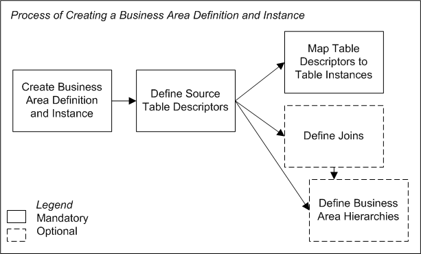

Creating a Business Area
When you create a Business Area in a Work Area, you are actually creating an instance of a Business Area definition.
Figure 11-1 Process of Creating a Business Area Definition and Instance
Description of Figure 11-1 follows
Description of "Figure 11-1 Process of Creating a Business Area Definition and Instance"
