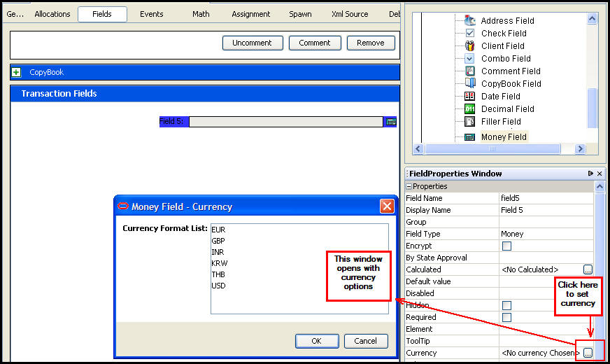

Activity Level Currency
Configure a transaction to always use a specific type of currency. Check-out the transaction and click the Fields pane. When the money field is clicked, the Field Properties window will open. Scroll through the properties to the Currency field. Select the currency from the drop down box. The currency set here will determine the currency that the OICE user will see when processing this transaction.
Currency Set at Activity Level

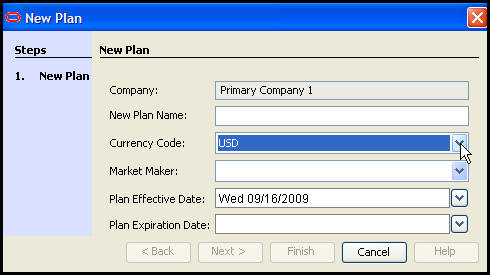

When OICE reads a money field it will check to see if a currency code has been assigned. OICE first checks the activity level. If no currency is set, OICE will check the plan level. Plan level currency codes can be set when a new plan is created. Currency codes assigned to a plan can also be updated.
When a new plan is created, select a currency from the currency code drop down box. This will associate the currency with all policies under that plan.
Plan Level Currency
New Plan Wizard

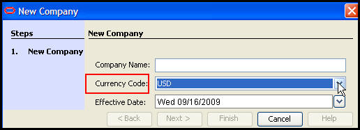

When OICE reads a money field it will check to see if a currency code has been assigned. OICE first checks the activity and plan levels. If no currency code is set, it will check the company level. Company level currency codes can be set when a new company is created. Currency codes assigned to a company can also be updated.
When a new company is created, select a currency from the currency code drop down box. This will associate the currency with all plans and policies under that company.
Currency Code in Company Wizard
New Company Wizard
