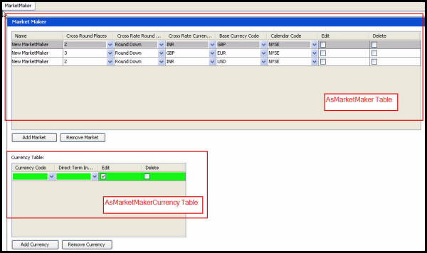

  4. Right-click the MarketMaker.xml file and select Check-out. The Market Maker file will open in the Configuration Pane. It is divided into two sections. The top table contains the AsMarketMaker table information. The bottom table contains the AsMarketMakerCurrency table information.

Market Maker file open showing the ASMarketMaker table and the ASMarketMakerCurrency table
Market Maker Editor in Rules Palette

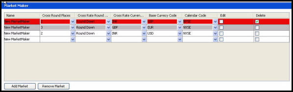

  6. Select the Remove Market button or the Remove Currency button. The deleted row will be highlighted in red.

Market Maker option selected for delete
Row Highlighted for Delete in Market Maker Editor
