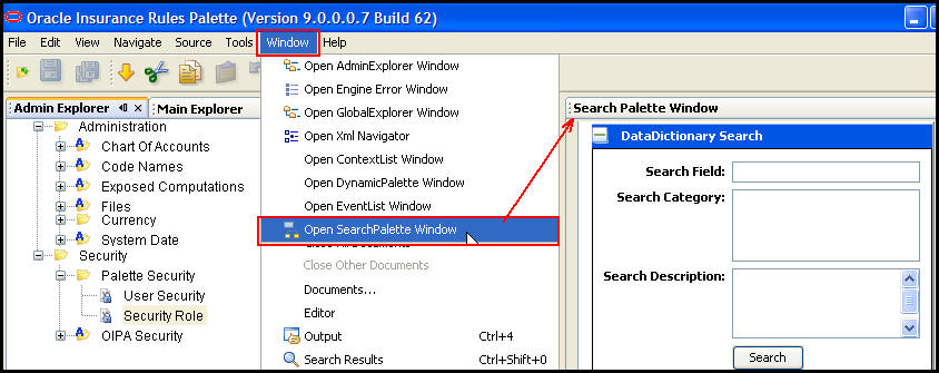

There are two ways to access the Data Dictionary:
  1. When configuring, access the Data Dictionary by clicking Window from the menu bar and selecting Open SearchPalette Window. Procedures for using the drag and drop functionality in the Configuration Area are described in the SearchPalette Window description.
    Open Search Palette Windown option from Tool Bar
Window Option on Tool Bar with OpenSearchPaletteWindow Option Selected

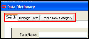

Open the Data Dictionary by clicking the Data Dictionary icon Data dictionary icon on the Main Menu. There are three tabs in the Data Dictionary window: Search, Manage Term and Create New Category.
In the Data Dictionary the word term refers to either a field or math variable.
Data Dictionary Tabs
