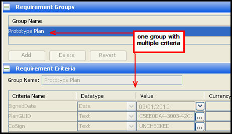

Requirement Groups: provides a method of attaching multiple criteria together. Each group listed will have its own set of criteria defined in the Requirement Criteria section below. You will only see the criteria associated with the group you have selected. Clicking a different group will reveal the specific criteria assigned to that group. You can create a group without any associated criteria. Groups are saved to the AsRequirementGroup table.

Requirement Criteria: used as a reference for the system when it is determining whether or not to generate requirements for an activity. These are the fixed criteria the math variables are matched to in the GeneratePendingRequirements business rule in order to determine if the requirement is needed. You can associate multiple criteria with a Requirement Group. Criteria are saved to the AsRequirementCriteria table.

Requirement Criteria should be configured to make the set of criteria within each Requirement Group mutually exclusive with respect to each other Requirement Group's set of Criteria. This would make it impossible for any given activity to satisfy more than one set of criteria. This is often done by using PlanGUID as one of the criteria in each group but it can be done using other methods as well.
Criteria Pane of a Requirement in Admin Explorer

From the Admin Explorer tab open Administration | Requirements and expand the relevant requirement node.
Expand the node for the relevant override level and check out the requirement.
Click on the Criteria pane.
Click Add in the Requirement Groups section and click in the highlighted field.
Type the Requirement Group name. This is required.
Criteria do not have to be added initially. The Rules Palette allows this section to remain empty; however, before the requirement can be used in OICE, criteria must be added.
Scroll down and click Add in the Criteria section then click inside the highlighted field. The Add button is only enabled if a requirement group was created.
Type the Criteria name. Criteria must have unique names within the same group. The Criteria names can be reused if they are used only once in each group.
Select a datatype.
Enter a value.
Select a Currency if the datatype is money.
Right-click on the XML file and select Check in to save the changes to the database.
