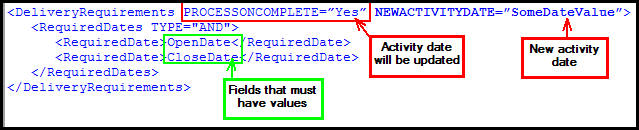

DeliveryRequirements Business Rule
DeliveryRequirements business rule serves two purposes:
  1. It identifies the fields that are required to have values before a requirement should be considered satisfied. The <RequiredDate> tag accomplishes this in the example below.
  2. It toggles a setting that determines whether the activity's effective date should be updated after completion of all pending requirements. The PROCESSONCOMPLETE attribute accomplishes this in the example below. When it is set to No or left blank, the activity will retain its original effective date. If it is set to Yes, the rule will update the effective date of the activity to the date defined in the NEWACTIVITYDATE attribute once all requirements are complete.
Refer to the XML Configuration Guide in the Rules Palette help menu for a detailed explanation of the elements and values available for configuration in this business rule. The business rule can be found in the Business Rules | Attached Rules folder.
DeliveryRequirements business rule XML
DeliveryRequirements Business Rule XML
