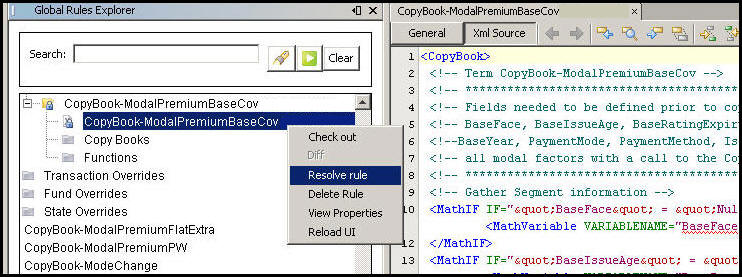

  1. Navigate to the rule and expand its folder.
  2. Right-click on the rule’s XML file.
  3. Select Resolve rule. If a policy transaction is being resolved, a Context window will appear. A state context must be selected.
The resolved rule displays in the Configuration Area.
Rules complete XML showing in Configuration Area
CopyBook Resolve Rule Right-Click Option
