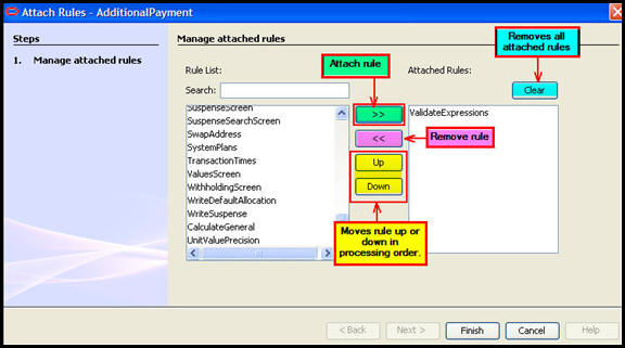

  4. Select the rule to attach from the Rule List.
  5. Use the Button to attach rule to transaction button to attach the rule.
  6. Repeat as necessary.
  7. Select Finish.
Attach Rules Manager
Attach Rules Window

  4. Select the rule to remove from the Rule List.
  5. Use the button to remove a rule button to remove a rule.
