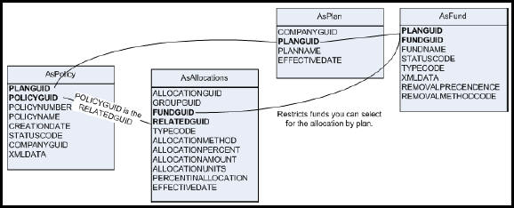

Allocation data is stored in the AsAllocation database table. The AsAllocations table is linked to the AsPolicy, AsPlan and AsActivity tables through the RelatedGUID column.
Allocation Table and Related Tables
