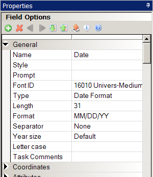

This example shows the date format as it looks in the FAP file. The easiest way to enter date formats is through Studio, on the field’s Properties window.
Studio will then create the date format in the FAP file for you.
When you choose Date Format as the type, you can choose from this list of date formats. The table also shows the corresponding date format code Studio creates in the FAP file:
