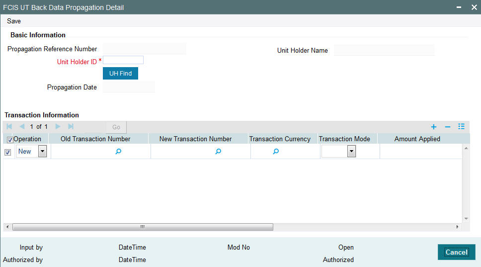

2.2 Propagating Back Data for UT

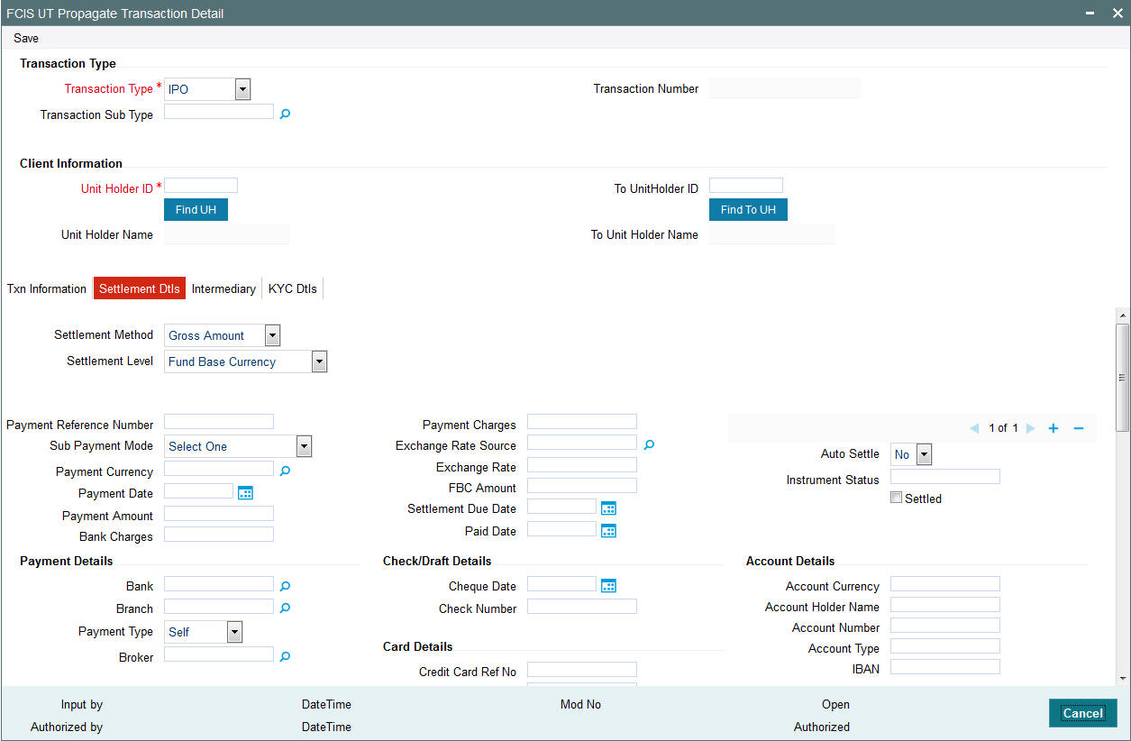

2.2.1 Invoking the FCIS UT Back Data Propagation Detail
You can create a transaction that has not been input for a unit holder,
delete existing erroneous data and modify certain details for an existing
record in the ‘FCIS UT Back Data Propagation Detail’ screen.
You can invoke by typing ‘UTDROPUT' in the field at the top right corner of
the Application tool bar and click the adjoining arrow button.
To modify
or delete a transaction, you can specify the required operation, the
original transaction number and change the details or delete the transaction
through the ‘UT Back Data Propagation’ screen. To create
a new record however, you are required to enter a new and unique transaction
number along with the other details of the transaction in the ‘UT
Propagate Transaction Detail’ screen. Subsequently, you need to
select the new transaction number in the ‘UT Back Data Propagation’
screen to propagate the new record.
You can enter the following details here:
Specifying Basic Information Details
Propagation Reference Number
Display Only
The system generates a unique number for each propagation process.
Unit Holder ID
Alphanumeric; Mandatory
Specify the UH for which the propagation is being done, You can use
the ‘UH Find’ button to select the required UH.
Unit Holder Name
Display Only
The system displays the name of the selected UH.
Propagation Date
Display Only
The system displays the application date here.
Specifying Transaction Information Details
Operation
Select from the adjoining drop-down list, the kind of propagation
operation that is to be done. The options are:
The data that you are required to enter from here on depends on the
type of operation you have selected.
Old Transaction Number
Alphanumeric; Mandatory only if Operation is ‘Delete’
Specify the transaction number of the transaction that you wish to
delete or modify. You can also select the transaction number from the
adjoining option list. The list contains the reference numbers of all
authorized transactions.
New Transaction Number
Alphanumeric; Mandatory for New Operation
Specify a new unique transaction number for a transaction that you
wish to create. You can also select the transaction number from the adjoining
option list. The list contains the reference numbers for all the transactions
that were created in the ‘FCIS UT Propagate Transaction Detail’
screen.
Transaction Currency
Alphanumeric; Mandatory only if Operation is ‘Modify’
Specify the currency in which the new transaction is to be reckoned.
Transaction Mode
Select, from the adjoining drop-down list, the mode of transacting.
The options are:
Amount Applied
Mandatory if Transaction Mode is ‘Amount’
If the transaction mode is amount, specify the amount for the transaction.
Percent
Numeric; Mandatory if Transaction Mode is ‘Percent’
If the transaction mode is percent, specify the percentage.
Units
Numeric; Mandatory if Transaction Mode is ‘Units’
If the transaction mode is units, specify the number of units for
the transaction.
After entering the requisite details, click ‘Save’. The
system will propagate the transactions (and commissions) as per the operation
specified and generate a detailed report. If any of the following transactions
have taken place during the data propagation period, the system will
take these into account along with the original data for reiteration:
- Dividend payout or re-investment transaction
- Applicable loads
- Periodic fees
- SI Transactions

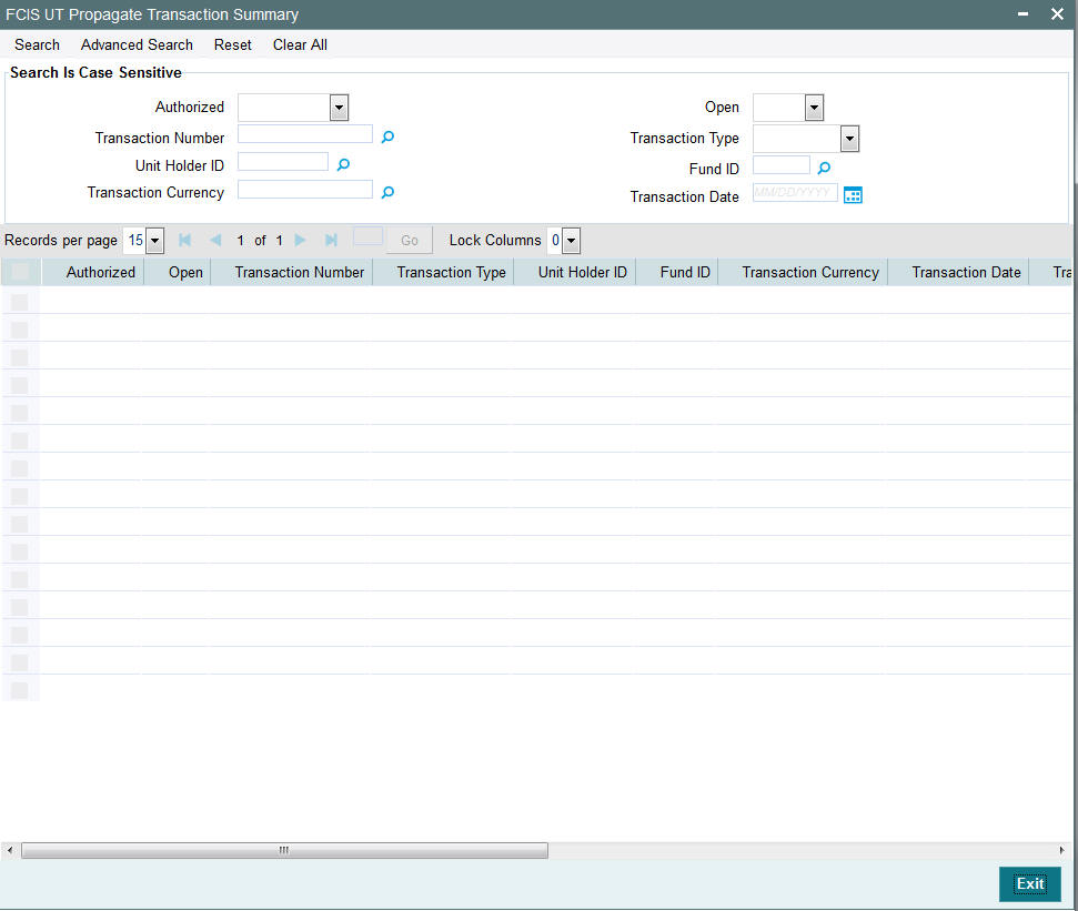

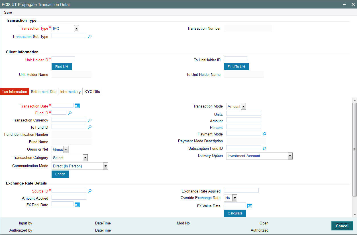

2.4 UT Transactions Creation
2.4.1 Creating UT Transactions

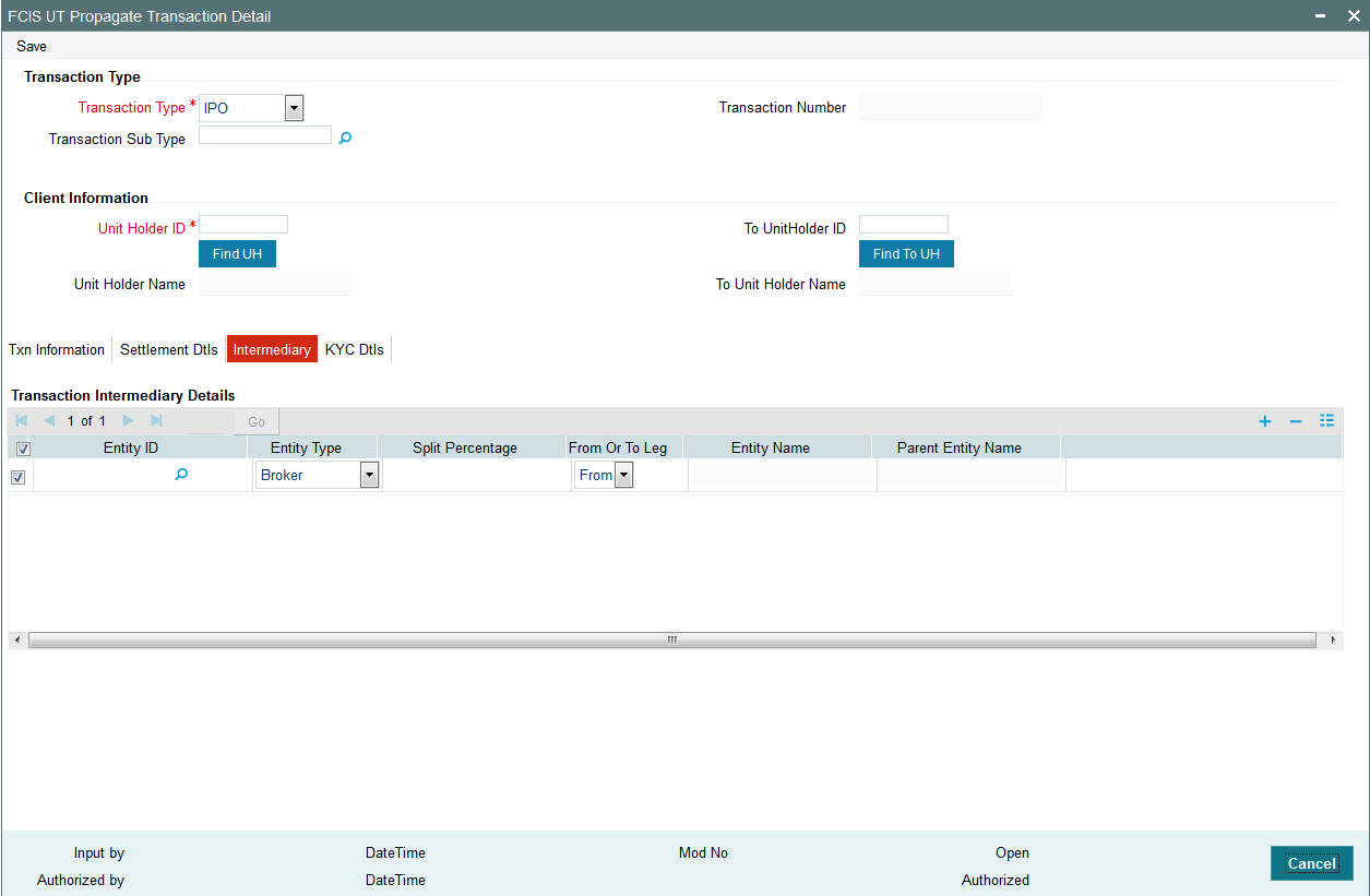

If you wish to create a record that has been missed out, you can do
so in the ‘FCIS UT Propagate Transaction Detail’ screen.
You can invoke the screen by typing ‘UTDPRTXN' in the field at the top right corner of
Enter
Transaction Type
Select, from the adjoining drop-down list, the kind of transaction
you want to create. The options are:
- IPO
- Subscription
- Redemption
- Switch
- Transfer
Transaction Number
Display Only
The system generates and displays a unique transaction number.
Transaction Sub Type
Display Only
The system will display the sub-type for the transaction.
Unit Holder ID
Specify the unit holder for the transaction. You can select the required
unit holder ID by clicking the ‘Find UH’ button.
Unit Holder Name
Display Only
The system will display the name of the unit holder selected.
To UnitHolder ID
Alphanumeric; Only for Transfer Transactions
Specify the unit holder to whom the units are being transferred. You
can select the required unit holder ID by clicking the ‘Find UH’
button.
To Unit Holder Name
Display Only
2.4.2 Transaction Information Tab
In this section, you can enter the basic details for the transaction
along with the exchange rates to be used..
2.4.3 Settlement Details Tab
In this section, you can capture the details of settlement and payment
made for the transaction in the case of IPO, subscription and redemption
transactions. Payment Details link is displayed on selecting any Payment
Mode other than ‘Cash’ and ‘Against Payment’.
Click the Payment Details link to invoke the Settlement Information screen.
2.4.4 Intermediary Tab
If a broker has been identified as an intermediary for the transaction,
then you must identify the same in this section, along with the commission
percentage split for the broker.
If brokers are designated as mandatory for the fund in which the transaction
is being put through, then you must specify at least one broker as mandatory
information in this section. If brokers are not mandatory for the fund,
and you do not specify any broker in this section, then the system reckons
the broker as DIRECT and designates the same as the default broker.

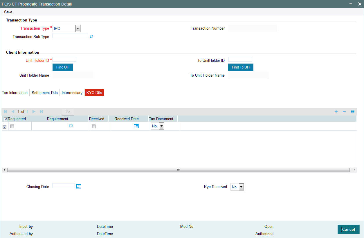

2.4.5 KYC Details Tab
You need to specify the list of required KYC documents for this transaction.
System allows you to save the transaction even if the unit holder has
not submitted all the required KYC documents. However, you will not be
allowed to perform the completion operation on that transaction unless
all the required documents have been received from the investor.
This feature will be available only if your installation has requested
for it.
Refer the chapters ‘Processing Transactions
– I’ and ‘Processing Transactions - II’ in the
Agency Branch User Manual for more details on the fields in this screen.
You can also modify details of a newly created record, delete and
authorize a record through this screen. Modification, however, will be
allowed only if the record has not been selected for data propagation
in the ‘UT Back Data Propagation’ screen.

2.5 FCIS UT Propagate Transaction Summary
2.5.1 Retrieving Record in FCIS UT Propagate Transaction
Summary screen
You can retrieve a previously entered record in the Summary Screen,
as follows:
Invoke the ‘FCIS UT Propagate Transaction Summary’ screen
by typing ‘UTSPRTXN' in the field at the top right corner of
the Application tool bar and clicking on the adjoining arrow button.
Specify any or all of the following details in the corresponding fields:
- The status of the record in the Authorized field. If you choose the
‘Blank Space’ option, then all the records are retrieved.
- The status of the record in the Open field. If you choose the ‘Blank
Space’ option, then all records are retrieved
- Transaction Number
- Transaction Type
- Unitholder ID
- Fund ID
- Transaction Currency
- Transaction Date
Click ‘Search’ button to view the records. All the records
with the specified details are retrieved and displayed in the lower portion
of the screen.

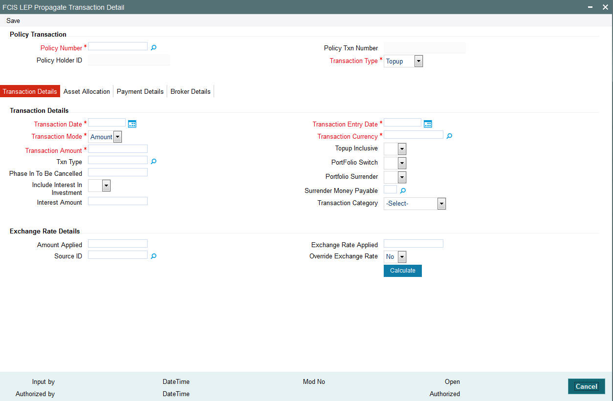

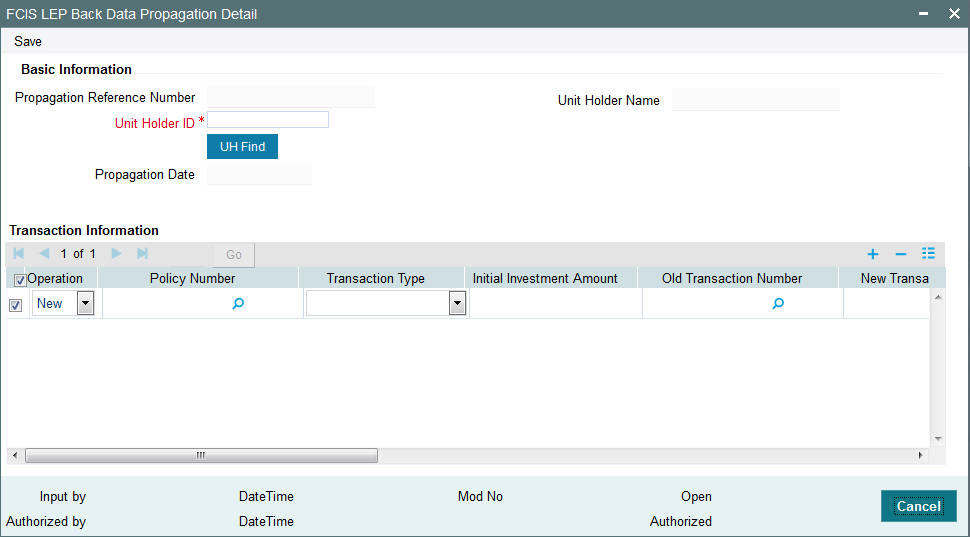

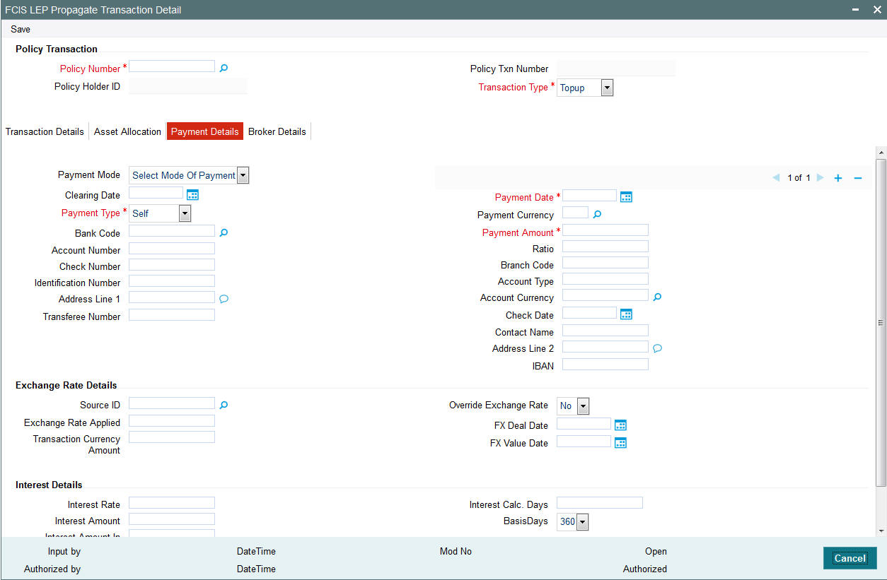

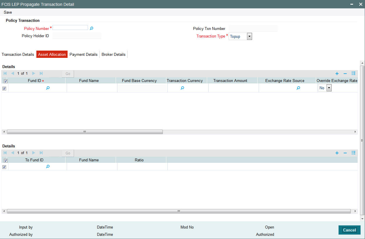

2.6 Back Data Propagation for LEP
2.6.1 Propagating Back Data for LEP
You can create transactions that have not been input for a policy
holder, delete existing erroneous data and modify certain details for
an existing record in the ‘FCIS LEP Back Data Propagation’
screen. You can invoke by typing ‘LEDROPLE' in the field at the top right corner of
To modify or delete a transaction, you can specify the required operation,
the original transaction number and change the details or delete the
transaction through the ‘FCIS LEP Back Data Propagation’
screen. To create a new record however, you are required to enter a new
and unique transaction number along with the other details of the transaction
in the ‘FCIS LEP Propagate Transaction Detail’ screen. Subsequently,
you need to select the new transaction number in the ‘FCIS LEP
Back Data Propagation’ screen to propagate the new record.
Display Only
Unit Holder ID
Specify the UH for which the propagation is being done. You can use
Unit Holder Name
Display Only
Propagation Date
Display Only
Operation
Policy Number
Alphanumeric; Mandatory only if the Operation is Modify
Specify the policy number for which you want to propagate back data.
You can also select the policy number from the adjoining option list.
The list contains the reference numbers of all authorized policies.
Transaction Type
Select, from the adjoining drop-down list, the type of transaction
to be propagated. The options are:
- Policy Initial Investment
- Topup
- Switch
- Surrender
- Annuity
- Premium
- Recurring Switch
Initial Investment Amount
Numeric; Mandatory if Transaction Type is ‘Policy
Initial Investment’
Enter the initial investment amount for the policy.
Old Txn Number
Alphanumeric; Mandatory if Operation is ‘Delete’
Enter the transaction number of the transaction that you wish to delete
or modify.
New Txn Number
Alphanumeric; Mandatory if Operation is ‘New’
that were created in the ‘FCIS LEP Propagate Transaction Detail’
screen.
Alphanumeric; Mandatory if Operation is ‘Modify’
Transaction Mode
The options are:
Amount Applied
Percent
Units

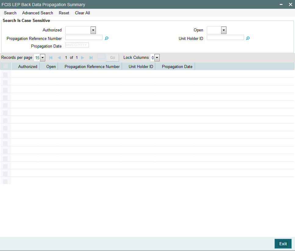

2.7 FCIS LEP Back Data Propagation Summary
2.7.1 Retrieving Record in FCIS LEP Back Data Propagation
Summary screen
as follows:
Invoke the ‘FCIS LEP Back Data Propagation Summary’ screen
by typing ‘LESROPLE' in the field at the top right corner of
- Propagation Reference Number
- Unitholder ID
- Propagation Date
of the screen.
You can also retrieve the individual record detail from the detail
screen by querying in the following manner:
- Press F7.
- Input the Propagation Reference Number.
- Press F8.
2.7.2 Viewing an FCIS LEP Back Data Propagation Record
To view a record that you have previously input, you must retrieve
the same in the FCIS LEP Back Data Propagation Summary screen as follows:
- Invoke the FCIS LEP Back Data Propagation Summary screen from the
Browser.
- Select the status of the record that you want to retrieve for viewing
in the Authorization Status field. You can also view all records that
are either unauthorized or authorized only, by choosing the Unauthorized/
Authorized option.
- Specify any or all of the details of the record in the corresponding
fields on the screen.
- Click ‘Search’ button. All records with the specified
fields are retrieved and displayed in the lower portion of the screen.
- Double click the record that you want to view in the list of displayed
records. The FCIS LEP Back Data Propagation screen is displayed in View
mode.
2.7.3 Authorizing an FCIS LEP Back Data Propagation Record
An unauthorized FCIS LEP Back Data Propagation record must be authorized
in the system for it to be processed. To authorize a record:
Browser.
- Select the status of the record that you want to retrieve for authorization.
Typically, choose the unauthorized option.
- Specify any or all of the details in the corresponding fields on
the screen.
details that are pending authorization are retrieved and displayed in
- Double click the record that you wish to authorize. The FCIS LEP
Back Data Propagation screen is displayed. Select Authorize operation
from the Action List.
2.8 New LEP Transactions
2.8.1 Creating New LEP Transactions
If you wish to create a new policy top-up, policy surrender or a policy
switch record that has been missed out, you can do so in the ‘FCIS
LEP Propagate Transaction Detail’ screen. You can invoke the screen
by typing ‘LEDPRTXN’ in the field at the top right corner
of the Application tool bar and click the adjoining arrow button.
Enter the basic details here. The system will default the rest:
Policy Number
Specify the policy number for the transaction.
Policy Holder ID
Display Only
The system displays the ID of the policy holder.
Policy Txn Number
Display Only
The system will generate the transaction number for the propagation
policy transactions.
Transaction Type
2.8.2 Transaction Details Tab
Click the ‘Transaction Details’ tab to enter the main
details for the transaction.
2.8.3 Asset Allocation Tab
Click the ‘Asset Allocation’ tab to enter the asset allocation
2.8.4 Payment Details Tab
Click the ‘Payment Details’ tab to enter the payment details

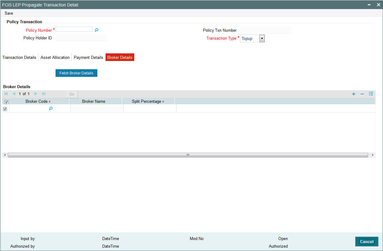

2.8.5 Broker Details Tab
Click the ‘Broker Details’ tab to enter details of brokers
Refer the following chapters for more details on the
- Policy
- Policy Transactions – Top Up
- Policy Transactions – Switch
- Policy Transactions – Surrender

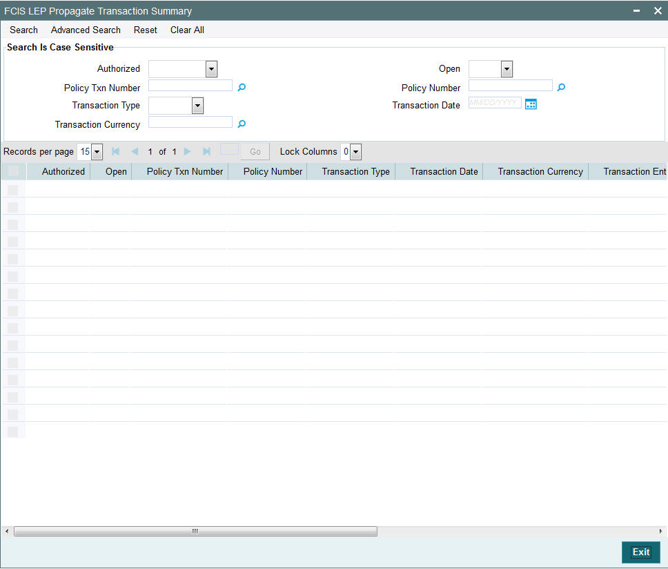

2.9 FCIS LEP Propagate Transaction Summary
2.9.1 Retrieving Record in FCIS LEP Propagate Transaction
Summary screen
as follows:
Invoke the ‘FCIS LEP Propagate Transaction Summary’ screen
by typing ‘LESPRTXN’ in the field at the top right corner
of the Application tool bar and clicking on the adjoining arrow button.
- Policy Txn Number
- Policy Number
- Transaction Type
- Transaction Date
of the screen.
- Press F7.
- Input the Policy Txn Number.
- Press F8.
You can perform Edit, Delete, Amend, Authorize operations by selecting
the operation from the Action list.

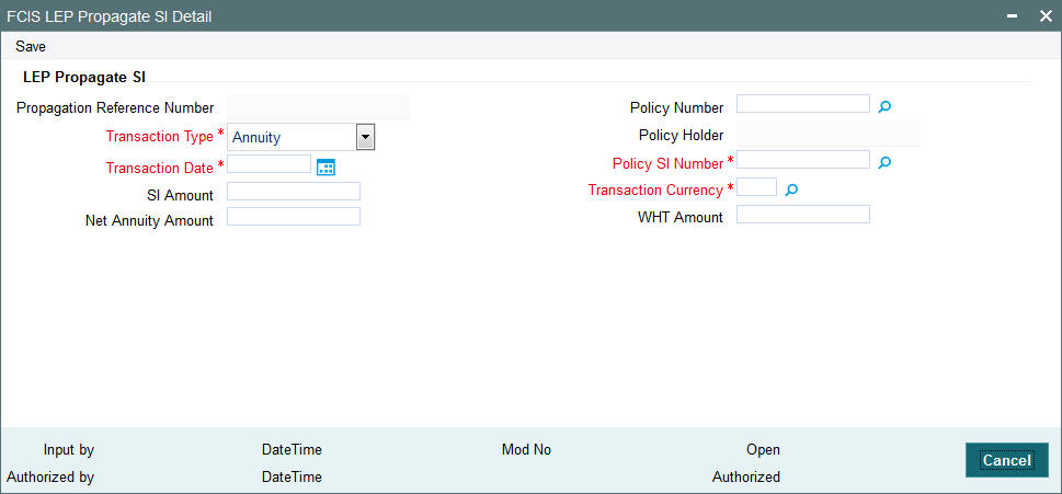

2.10 Annuities and Premium Transactions
2.10.1 Creating Annuities and Premium Transactions
Similar to the way policy transactions are entered in the system,
annuities and premium related transactions can be entered for propagation
in the ‘FCIS LEP Propagate SI Details’. You can invoke this
screen by typing ‘LEDPROSI’ in the field at the top right corner
Enter the following details:
Transaction Type
Select, from the adjoining drop-down list, the transaction type. You
have the following options:
- Annuity
- Recurring Premium
- Recurring Switch
Transaction Date
Date Format; Mandatory
Specify the date of transaction.
SI Amount
Numeric; Optional
This is the value for which the SI will be generated.. You can give
either SI amount or Net Annuity amount and WHT amount. If SI amount
alone is entered system will compute the WHT amount if applicable. If
SI amount is given, Net annuity amount and WHT amount should not be specified.
Net Annuity Amount
Numeric; Optional
You can enter either SI amount or Net Annuity amount and WHT amount.
If Net annuity amount and WHT amount are entered, the system will generate
an SI with Net annuity amount and a WHT redemption transaction for the
WHT amount.
Policy Number
Alphanumeric; Optional
Enter the policy number for which SI should be generated.
Policy Holder
Display
The system will display the Unitholder of the policy.
Policy SI Number
You need to choose the policy SI maintenance for which an adhoc SI
to be generated
Enter the transaction currency for the SI transaction.
WHT Amount
Numeric; Optional
If Net annuity amount and WHT amount is entered, the system will generate
WHT amount.

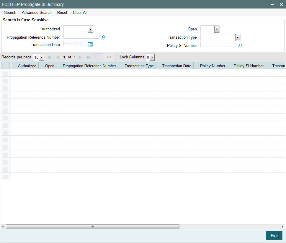

2.11 FCIS LEP Propagate SI Summary
2.11.1 Retrieving Record in FCIS LEP Propagate SI Summary
screen
as follows:
Invoke the ‘FCIS LEP Propagate SI Summary’ screen by typing
‘LESPROSI’ in the field at the top right corner
- Transaction Type
- Transaction Date
- Policy SI Number
of the screen.
- Press F7.
- Press F8.
2.11.2 Editing an FCIS LEP Propagate SI Record
You can modify the details of an FCIS LEP Propagate SI record that
you have already entered into the system, provided it has not been subsequently
authorized. You can perform this operation as follows:
- Invoke the FCIS LEP Propagate SI Summary screen from the Browser.
- Select the status of the record that you want to retrieve for modification
in the Authorized field. You can only modify records that are unauthorized.
Accordingly, choose the unauthorized option.
- Specify any or all of the details in the corresponding fields to
retrieve the record that is to be modified.
- Click ‘Search’ button. All unauthorized records with
of the screen.
- Double click the record that you want to modify in the list of displayed
records. The FCIS LEP Propagate SI screen is displayed.
- Select Unlock Operation from the Action list to modify the record.
Modify the necessary information.
- Click Save to save your changes. The FCIS LEP Propagate SI screen
is closed and the changes made are reflected in the FCIS LEP Propagate
SI Summary screen.
2.11.3 Viewing an FCIS LEP Propagate SI Record
the same in the FCIS LEP Propagate SI Summary screen as follows:
Authorized option.
records. The FCIS LEP Propagate SI screen is displayed in View mode.
2.11.4 Deleting an FCIS LEP Propagate SI Record
You can delete only unauthorized records in the system. To delete
a record that you have previously entered:
- Select the status of the record that you want to retrieve for deletion.
the screen.
- Double click the record that you want to delete in the list of displayed
- Select Delete Operation from the Action list. The system prompts
you to confirm the deletion and the record is physically deleted from
the system database.
2.11.5 Authorizing an FCIS LEP Propagate SI Record
An unauthorized FCIS LEP Propagate SI record must be authorized in
the screen.
Propagate SI screen is displayed. Select Authorize operation from the
Action List.
2.11.6 Amending an FCIS LEP Propagate SI Record
After an FCIS LEP Propagate SI record is authorized, it can be modified
using the Unlock operation from the Action List. To make changes to a
record after authorization:
You can only amend authorized records.
the screen.
Propagate SI screen is displayed in amendment mode. Select Unlock operation
from the Action List to amend the record.
- Amend the necessary information and click on Save to save the changes.
2.11.7 Authorizing an Amended FCIS LEP Propagate SI Record
An amended FCIS LEP Propagate SI record must be authorized for the
amendment to be made effective in the system. The authorization of amended
records can be done only from Fund Manager Module.
The subsequent process of authorization is the same as that for normal
records.
2.12 Processing Transactions
You can propagate different combinations of transactions and operations
in the back data propagation and transaction screens. The workflow for
each combination of transaction and operation is detailed in the table
below:
Transaction
Operation
Scenario
Workflow
Modify
Only initial investment amount modification
would be supported.
Policy captured with
wrong initial investment amount.
In LEP back propagation
screen, select the Investor, policy number and input the initial investment
amount.
Operation would be Modify and transaction
type would be “Policy Initial Investment”
Click ‘Save’.
Topup
Add
Top-up transaction
was missed.
In Propagate LEP Transaction
screen (Function ID: LEDPRTXN), capture a top-up transaction for the
appropriate policy and investor.
In LEP back propagation screen, select the
Investor, policy number and select operation as ‘New’ and
new transaction number should be the newly captured top-up transaction.
Transaction type should be ‘Top-up’
here.
Click ‘Save’.
Delete
Top-up transaction
captured in a wrong fund/investor.
screen, select the Investor, policy number and select operation as ‘Delete’
and old transaction number should be the top-up transaction in business
schema.
here.
Click ‘Save’.
Modify
Top-up transaction
captured in a wrong amount.
screen, select the Investor, policy number and select operation as ‘Modify’
schema. Transaction Amount/Transaction Units would be used to input the
modified value.
here.
Click ‘Save’.
Switch
Add
Missed policy switch transaction
screen (Function ID: LEDPRTXN), capture a switch transaction for the
new transaction number should be the newly captured Switch transaction.
Transaction type should be ‘Switch’
here.
Click ‘Save’.
Delete
Switch captured in
wrong fund.
and old transaction number should be the switch transaction which needs
to be deleted.
here.
Click ‘Save’.
Modify
Say switch transaction
was captured with wrong asset allocation details.
Add row in transaction
details grid, select the old transaction number as wrongly inputted switch
transaction number and operation should be selected as “Delete”.
In Propagate LEP Transaction screen (Function
ID: LEDPRTXN), capture a switch transaction for the appropriate policy,
investor and proper asset allocation.
new transaction number should be the newly generated Switch transaction.
here.
Click ‘Save’.
Surrender
Add
Missed Surrender
transaction
screen (Function ID: LEDPRTXN), capture the surrender transaction for
the appropriate policy and investor.
new transaction number should be the newly captured surrender transaction.
Transaction type should be ‘Surrender’
here.
Click ‘Save’.
Delete
Wrongly captured
surrender
and old transaction number should be the surrender transaction
in business schema.
here.
Click ‘Save’.
Modify
Surrender transaction captured
with wrong amount
in business schema. Transaction Amount/Transaction Units/Percentage
would be used to input the modified value.
here.
Click ‘Save’.
Annuity
Add
Missed Annuity
In LEP Propagation SI transaction
screen (Function ID: LEDPROSI) capture the missed annuity,
new transaction number should be the newly captured annuity transaction.
Transaction type should be ‘Annuity’
here.
Click ‘Save’.
Delete
Wrongly generated
Annuity
and old transaction number should be the Annuity transaction in business
schema.
here.
Click ‘Save’.
Modify
Not-revised Annuity
screen (Function ID: LEDPROSI) capture the not-revised annuity with proper
annuity amount,
here.
Add another row in transaction grid, select
in business schema.
here.
Click ‘Save’.
Premium
Add
Missed Premium
new transaction number should be the newly captured premium transaction.
Transaction type should be ‘Premium’
here.
Click ‘Save’.
Delete
Wrongly generated
Premium
and old transaction number should be the premium transaction in
business schema.
here.
Click ‘Save’.
Modify
Wrongly generated
with wrong value
screen (Function ID: LEDPROSI) capture the SI transaction with proper
premium amount.
here.

Recurring Switch
Add
Missed SI Switch
screen (Function ID: LEDPROSI) capture the missed recurring switch.
new transaction number should be the newly captured switch transaction.
Transaction type should be ‘Recurring
Switch’ here.
Click ‘Save’.
Delete
Wrongly generated
Switch
and old transaction number should be the recurring switch transaction
in business schema.
Switch‘ here.
Click ‘Save’.
Modify
Wrongly generated
with wrong value
screen (Function ID: LEDPROSI) capture recurring switch transaction
new transaction number should be the newly captured recurring switch
transaction.
Switch here.
in business schema.
Switch’ here.
Click ‘Save’.
2.13 Back Data Transactions Authorization
2.13.1 Authorizing Back Data Transactions
The system requires dual authorization for the transactions that have
been propagated. The first-time authorization is done from the ‘First
Verification’ screen and subsequently from the summary screens
for LEP and UT. You can invoke the ‘First Verification’ screen
by typing ‘CSSVERFY’ in the field at the top right corner
In this screen, you can retrieve records by specifying any of the
following parameters and clicking ‘Search’
- Function Id
- Maker
- Key Definition
The system will retrieve the records matching the parameters specified.
If you do not enter any parameter before clicking ‘Search’,
the system will display all the unauthorized UT and LEP records. Double-click
the required record and click ‘Accept’. The system will perform
the first level of authorization and redirect the record to the respective
summary screen, from where you can perform the second level of authorization.

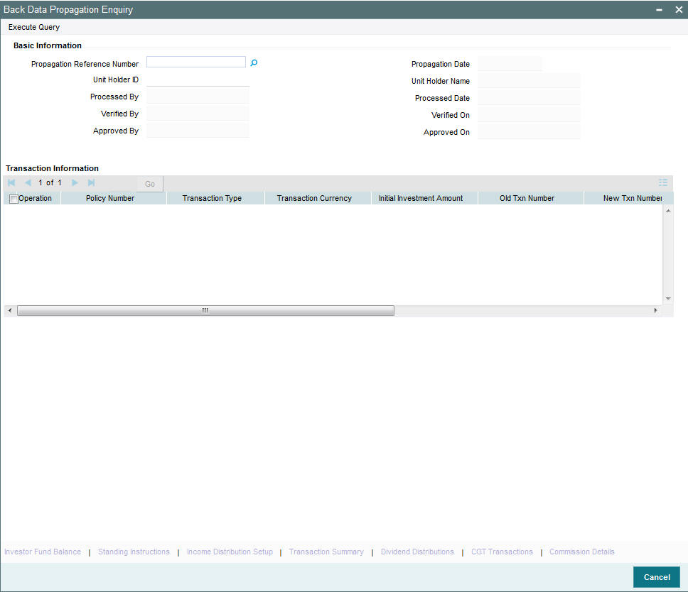

2.17 Back Data Propagation Details
2.17.1 Viewing Back Data Propagation Details
You can view the details that have been propagated using the ‘Back
Data Propagation Enquiry’ screen. You can invoke the screen by
typing ‘UTDPRQRY' in the field at the top right corner of
In this screen, press F7, enter the ‘Propagation Reference Number’
and press F8. The system will display the following details for the propagated
query:
- Operation
- Policy Number
- Transaction Type
- Initial Investment Amount
- Old Txn Number
- New Txn Number
- Amount Applied
- Units
- Percent

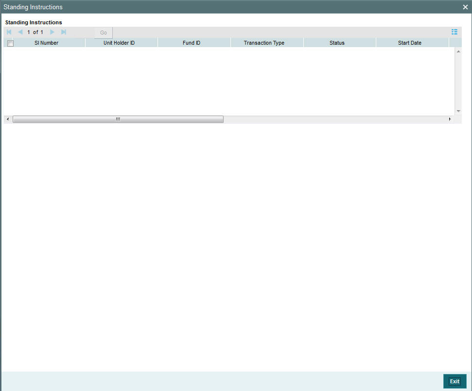

2.17.3 Viewing Standing Instruction Details
Click the ‘Standing Instructions’ button in the ‘Back
Data Propagation Screen’ to view the standing instructions details
propagated.
The following details are displayed:
- SI Number
- Unit Holder ID
- Fund ID
- Transaction Type
- Status
- Start Date
- End Date
- Escalation Start Date
- Escalation End Date
- Last Processed Date
- SI Description

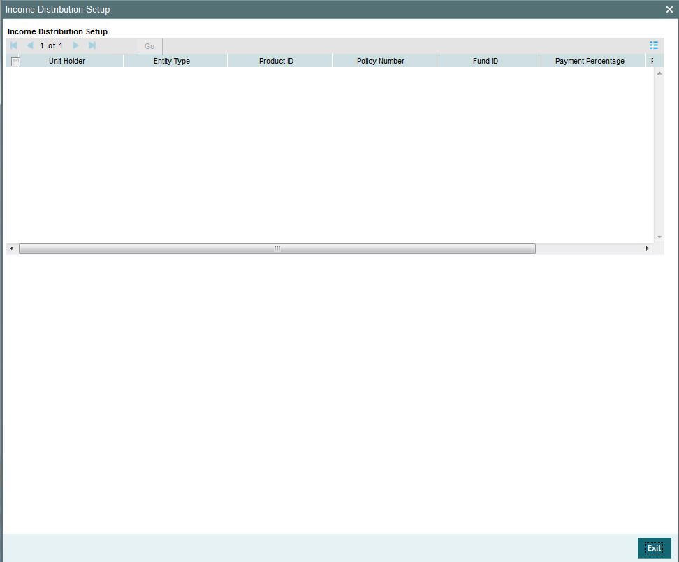

2.17.4 Viewing Income Distribution Setup Details
Click the ‘Income Distribution Setup’ button in the ‘Back
Data Propagation Screen’ to view details of the income distribution
propagated.
- Unit Holder
- Entity Type
- Product ID
- Policy Number
- Fund ID
- Payment Percentage
- Reinvestment Percentage

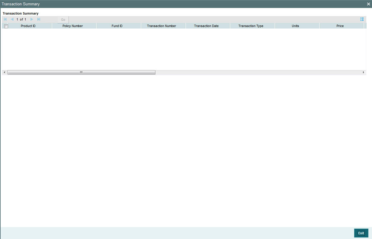

2.17.5 Viewing Transaction Summary
Click the ‘Transaction Summary’ button in the ‘Back
Data Propagation Screen’ to view a summary of the transactions
propagated.
- Product ID
- Policy Number
- Fund ID
- Transaction Date
- Transaction Type
- Units
- Price
- Book Value
- Running Total
- Status
- Gross Amt in FBC
- Net Amt in FBC
- Broker Commission
- Other Fees

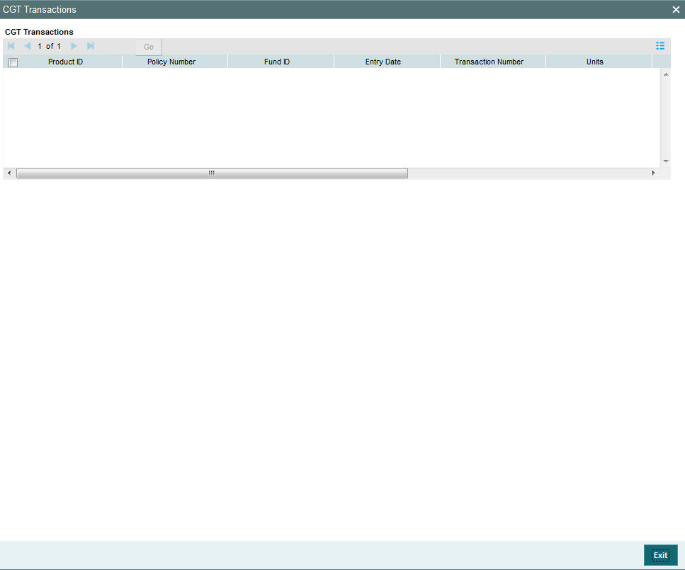

2.17.7 Viewing Capital Gains Transactions Tax Details
Click the ‘CGT Transactions’ button in the ‘Back
Data Propagation Screen’ to view the details of capital gains tax.
- Product ID
- Policy Number
- Fund ID
- Entry Date
- Units
- Transaction Date
- Reference Number
- Settled
