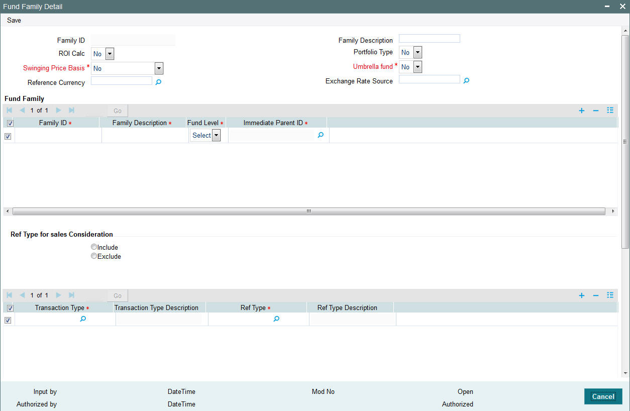

2.2.2 Invoking Fund Families Screen
You can use the ‘Fund Family Detail’ screen to maintain
fund families and umbrella fund hierarchies. The lower levels of the
fund hierarchy, for both Umbrella and non-umbrella funds may be set up
in this screen.
You can invoke this screen by typing ‘UTDFNDFM’ in the field at the top right corner
of the Application tool bar and clicking on the adjoining arrow button.
Select ‘New’ from the Actions menu in the Application
tool bar or click new icon to enter the details of a new fund family.
In the system,
switching transactions that involve switching of a unit holder’s
units from one fund to another are dependent on the fund family setup
for non-umbrella funds and the fund hierarchy for umbrella funds.
You can specify the following fields:
Family ID
Display
Enter a unique Identification for the fund family. This value should
not be a valid Family ID already existing in the system.
Portfolio Type
Optional
If the family being set up is to have a portfolio type, select Yes.
ROI Calc
Optional
If ROI calculation is applicable for the family which is being set
up, select Yes.
Swinging Price Basis
Mandatory
This field displays whether the swinging price is applicable for the
fund family or not. The available options are:
- No
- Swinging Price
- Semi Swinging
This field is applicable if swinging price is applicable for fund
families.
Reference Currency
Optional
This field displays the reference currency. This field is applicable
only when the swinging price basis is selected as ‘Swinging Price’
or ‘Semi Swinging’. The mid currency exchange rate is used
for currency conversion.
Exchange Rate Source
Optional
This field displays the Exchange Rate Source. This field is applicable
or ‘Semi Swinging’.
Umbrella Type
Optional
If the family being set up is to be an umbrella fund, select Yes.
If a fund is designated as an umbrella fund, the hierarchy must be maintained
up to level 3, i.e., fund families, umbrella funds and sub-funds.
Family ID
6 Characters Maximum, Alphanumeric, Mandatory
Family Description
20 Character Maximum, Alphanumeric, Mandatory
Enter a brief description of the fund family that is being set up.
Immediate Parent ID
Select the Immediate parent ID from the option list. The option list
contains list of all existing fund families. Select a valid entry for
the relevant Fund Family ID.
Fund Level
Display
Displays the level of immediate Parent ID selected.
Reference Types for Sales Consideration
Mandatory only if Swinging Price Basis is not ‘No’
Select include or exclude to indicate whether reference type needs
to be used for net sales computation or not.
Transaction type (for Sales Consideration)
Select the transaction type to be mapped for sales consideration computation
from the drop down list. The following values are listed in the drop
down list:
Transaction Type Description
The description of the selected transaction type is displayed in this
field.
Reference Type
Specify the reference type which is used for sales consideration computation.
Ref Type Description
The description of the selected reference type is displayed in this
field.
Transaction type for Swinging Price Consideration
Transaction Type
Select the transaction type for which the swinging price is to be
applied from the drop down list. The following values are listed in the
drop down list:
Transaction Description
The system displays a description of the selected transaction.

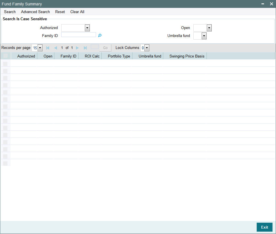

2.3 Fund Family Summary Screen
2.3.1 Retrieving Record in Fund Family Summary Screen
You can retrieve a previously entered record in the Summary Screen,
as follows:
Invoke the ‘Fund Family Summary’ screen by typing ‘UTSFNDFM’ in the field at the top right corner
Specify any or all of the following details in the corresponding fields:
- The status of the record in the Authorization Status field. If you
choose the ‘Blank Space’ option, then all the records are
retrieved.
- The status of the record in the Record Status field. If you choose
the ‘Blank Space’ option, then all records are retrieved
- Family ID
- Umbrella Type
Click ‘Search’ button to view the records. All the records
with the specified details are retrieved and displayed in the lower portion
of the screen.
Note
You can also retrieve the individual record detail
from the detail screen by querying in the following manner:
- Press F7.
- Input the Family ID.
- Press F8.
You can perform Edit, Delete, Amend, Authorize, Reverse,
Confirm operations by selecting the operation from the Action list.
You can also search a record by using a combination of % and alphanumeric

- Invoke the Fund Family Summary screen from the Browser.
- Select the status of the record that you want to retrieve for modification
in the Authorization Status field. You can only modify records that are
unauthorized. Accordingly, choose the ‘Unauthorized’ option.
- Specify any or all of the details in the corresponding fields to
retrieve the record that is to be modified.
- Click ‘Search’ button. All unauthorized records with
of the screen.
- Double click the record that you want to modify in the list of displayed
records. The Fund Family Detail screen is displayed.
- Select Unlock Operation from the Action list to modify the record.
Modify the necessary information.
- Click Save to save your changes. The Fund Family Detail screen is
closed and the changes made are reflected in the Fund Family Summary
screen.
- Select the status of the record that you want to retrieve for viewing
in the Authorization Status field. You can also view all records that
are either unauthorized or authorized only, by choosing the Unauthorized/
Authorized option.
- Specify any or all of the details of the record in the corresponding
fields on the screen.
- Click ‘Search’ button. All records with the specified
fields are retrieved and displayed in the lower portion of the screen.
- Double click the record that you want to view in the list of displayed
records. The Fund Family Detail screen is displayed in View mode.

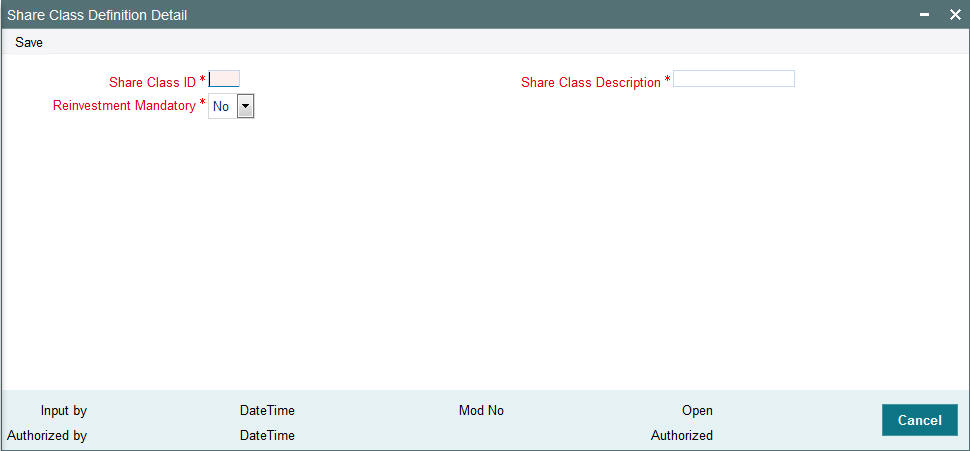

To maintain share classes, use the ‘Share Class Definition Detail’
screen. You can invoke this screen by typing ‘UTDSCDEF’ in the field at the top right corner
Select ‘New’ from the Actions menu in the Application tool
bar or click new icon to enter the details of the share class.
You
Share Class ID
2 Characters Maximum, Alphanumeric, Mandatory
Specify a unique ID that will identify the share class in the system.
Share Class Description
20 Characters Maximum, Alphanumeric, Mandatory
Specify a unique description for the share class.
Reinvestment Mandatory
1 Character Maximum, Mandatory
Select ‘Yes’ if reinvestment is to be mandatory for this
share class. If you select ‘Yes’ , and reinvestment is mandatory
for this share class, reinvestment is the only option that will be available
when a Corporate Actions profile is set up for this share class fund.

record after authorization:
- Invoke the Share Class Definition Summary screen from the Browser.
- Select the status of the record that you want to retrieve for authorization.
You can only amend authorized records.
- Specify any or all of the details in the corresponding fields on
the screen.
details that are pending authorization are retrieved and displayed in
- Double click the record that you wish to authorize. The Share Class
Definition screen is displayed in amendment mode. Select Unlock operation
from the Action List to amend the record.
- Amend the necessary information and click on Save to save the changes.
2.5.7 Authorizing Amended Share Class Definition Record
An amended Share Class Definition record must be authorized for the
amendment to be made effective in the system. The authorization of amended
records can be done only from Fund Manager Module.
The subsequent process of authorization is the same as that for normal
transactions.
2.5.8 Copying Attributes
If you want to create a new Share Class Definition with the same attributes
of an existing one, you can copy the attributes of an existing Share
Class Definition to a new one.
To copy the attributes:
- Retrieve the record whose attributes the new Share Class Definition
should inherit. You can retrieve the record through the Summary screen
or through the F7-F8 operation explained in the previous sections of
this chapter.
- Click on Copy
- Indicate the ID for the new Share Class Definition. You can, however,
change the details of the new maintenance.

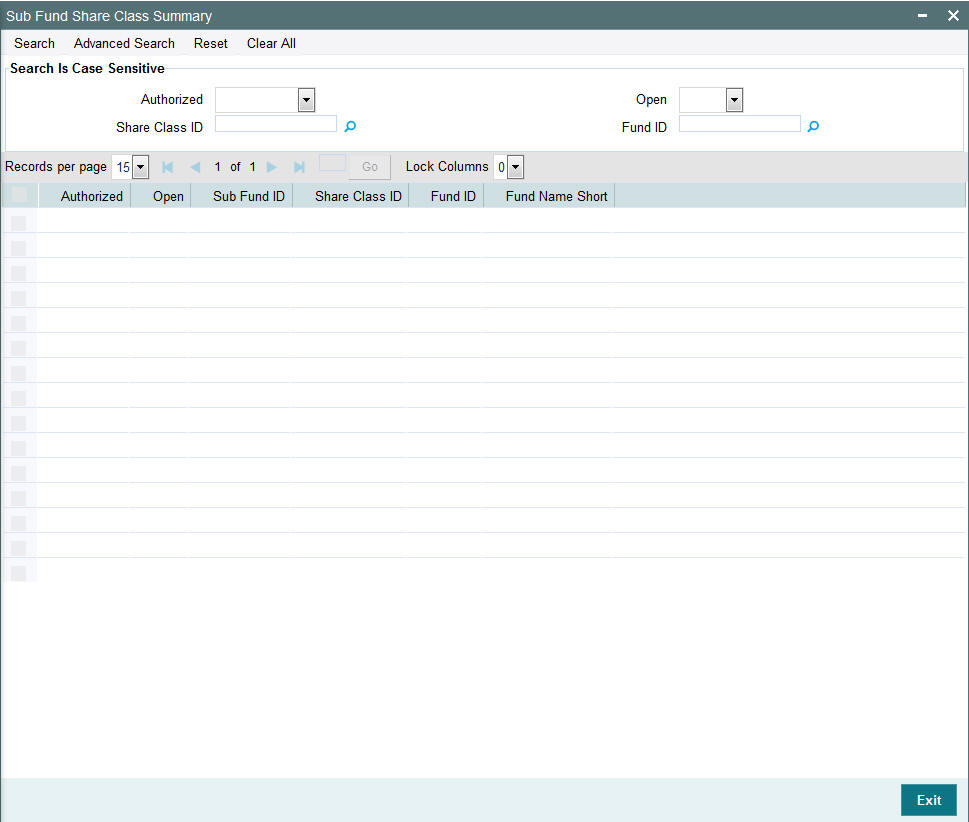

2.7 Sub-fund Share Class Summary Screen
2.7.1 Retrieving Record in Sub-fund Share Class Summary
screen
as follows:
Invoke the ‘Sub Fund Share Class Summary’ screen by typing
‘UTSSUBFN’ in the field at the top right corner of the Application
tool bar and clicking on the adjoining arrow button and specify any or
retrieved.
- Share Class ID
- Fund Id
of the screen.
You can also retrieve the individual record detail from the detail
- Press F7.
- Input the Share Class ID.
- Press F8.
You can perform Edit, Delete, Amend, Authorize, Reverse, Confirm operations
by selecting the operation from the Action list. You can also search
a record by using a combination of % and alphanumeric value.

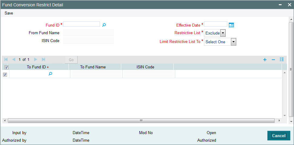

2.8 Fund Conversion Restriction
2.8.1 Invoking Fund Conversion Restriction Screen
You can restrict fund conversion details within the same fund family
and AMC using ‘Fund Conversion Restrict Details’ screen.
You can invoke this screen by typing ‘UTDFNCVR’ in the
field at the top right corner of the Application tool bar and clicking
You can specify the
following details.
From Fund ID
Alphanumeric; 8 Characters; Mandatory
Specify the valid From Fund ID for which the restriction is enabled.
From Fund Name
Display
The system displays the name of the fund for the selected fund ID.
Effective Date
Date Format; Mandatory
Specify the date from which the restriction is effective.
ISIN Code
Display
The system displays the fund ISIN code.
Restrictive List
Mandatory
Select the restrictive list from the adjoining drop-down list. Following
are the options available:
- Exclude List
- Include List
If you select ‘Include’, then the list of restrictive
funds will be enabled for the fund. If you select ‘Exclude’,
then the restrictive list will not be enabled for restriction and the
fund will be open for restricting any fund which is not in the restrictive
list.
Limit Restrictive List To
Mandatory
Select the restrictive list that is limited to from the adjoining
option list. Following are the options available:
- No Restriction
- Fund Family
- AMC
If you select ‘No Restriction’, then restriction will
happen based on the value selected in Restrictive List field. However,
if you select ‘Fund Family’ then system will do a validation
that it will show only the list of funds for restriction which are of
same fund family. If you select ‘AMC’, then the system will
do the validation that it will show the list of funds for restriction
which are of same AMC.
To Fund ID
Mandatory
Specify the To fund ID selected for restriction.
To Fund Name
Display
The system displays the name of the fund selected for restriction.
ISIN Code
Display
The system displays the ISIN code.
2.9 Fund Restriction Details Summary
2.9.1 Retrieving Fund Restriction Details
You can retrieve previously entered Fund Restriction Details as follows:
- Invoke the ‘Fund Conversion Restrict Summary’ screen
from the Browser. To invoke this screen, type ‘UTSFNCVR’
in the field at the top right corner of the Application tool bar.
- Specify any or all of the following details in the screen:
- The status of the transaction in the ‘Authorized’ field.
If you choose the blank space, then both the authorized and the unauthorized
status records will be retrieved for the specified criteria.
- The status of the records in the ‘Open’ field. If you
choose the blank space, then all the records are retrieved.
- From Fund ID
- Restrictive List
- Limit Restrictive List To. If you choose the blank space, then all
of the screen.
Note
- Press F7
- Input the From Fund ID
- Press F8
Example
You can search the record for Account Type by using the combination
of % and alphanumeric value as follows:
- Search by A%: The system will fetch all the records whose Account
Type starts from Alphabet ‘A’. For example, AGC17, AGVO6,
AGC74 and so forth.
- Search by %7: The system will fetch all the records whose Account
Type ends by numeric value’ 7’. For example, AGC17, GSD267,
AGC77 and so forth.
- Search by %17%: The system will fetch all the records whose Account
Type contains the numeric value 17. For example, GSD217, GSD172, AGC17
and so forth
2.9.2 Editing Fund Restriction Details
You can modify the Fund Restriction Details that you have already
entered into the system, provided it has not been subsequently authorized.
You can perform this operation as follows:
from the Browser.
in the Authorized field. You can only modify records that are unauthorized.
Accordingly, choose the unauthorized option.
of the screen.
records. The ‘Fund Conversion Restrict Detail’ screen is
displayed.
- Click Save to save your changes. The ‘Fund Conversion Restrict
Summary’ screen is closed and the changes made are reflected in
the ‘Fund Conversion Restrict Summary’ screen.
2.9.3 Viewing Fund Restriction Details
To view a record that you have previously input, you must retrieve
the same in the ‘Fund Conversion Restrict Summary’ screen
as follows:
from the Browser.
Authorized option.
2.9.4 Deleting Fund Restriction Details
You can delete only unauthorized records in the system. To delete
a record that you have previously entered:
from the Browser.
- Select the status of the record that you want to retrieve for deletion.
the screen.
- Double click the record that you want to delete in the list of displayed
displayed.
- Select Delete Operation from the Action list. The system prompts
you to confirm the deletion and the record is physically deleted from
the system database.
2.9.5 Authorizing Fund Restriction Details
An unauthorized fund restriction record must be authorized in the
system for it to be processed. To authorize a record:
from the Browser.

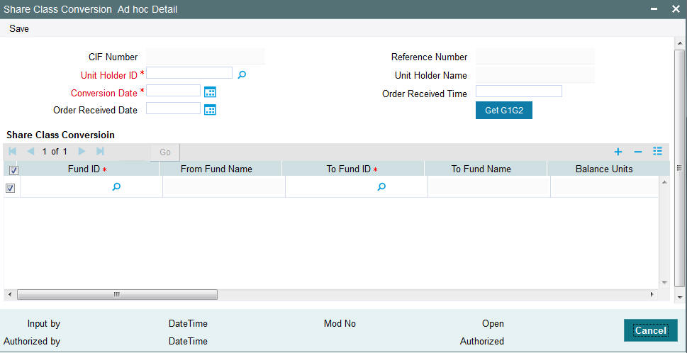

2.10 Share Class Ad-Hoc Conversion
2.10.1 Invoking Share Class Conversion Screen
You can specify the unit holder ID and enter one or more funds details
in the details sections for the units to be converted. On selecting the
fund, the system will default the current confirmed holdings of the customer
in the fund. You can change this value, if required.
During allocation of the conversion transactions, the system will
use the Switch-In price for allocation and conversion factor for converting
units into To Fund. There will be no settlement for conversion transactions.
During the allocation of conversion transaction, the system will calculate
the linked transactions G1/G2 split, and convert it to new G1/G2 split
using the conversion factor.
You can maintain Share Class Ad-hoc Conversion details using ‘Share
Class Conversion -Ad hoc Detail’ screen. You can invoke this screen
by typing ‘UTDSCADH’ in the field at the top right corner
tool bar or click new icon to enter the details of the Mapping.
You can specify the
following details:
CIF Number
Display
The system displays the CIF number in this field.
Unit Holder ID
Specify the unit holder ID. You can also select the valid UH ID from
the adjoining option list.
Unit Holder Name
Display
The system displays the unit holder name.
Conversion Date
Specify the conversion date.
Conversion Reference Number
Display
The system displays the conversion reference number.
Order Received Date
Date Format; Optional
Specify the order received date.
Order Received Time
Optional
Specify the order received time.
You can click the ‘GetG1G2’ button to view the G1 and
G2 details of the unit holder.
Share Class Conversion Details
From Fund ID
Alphanumeric; 8 Characters; Optional
Specify the From Fund ID details.
From Fund Name
Display
The system displays the From Fund Name for the selected From Fund
ID.
To Fund ID
Specify the To Fund ID details.
During transaction, if any ‘To’ fund is not maintained
at the fund level of ‘From Fund’ then the system will display
the following error saying
To Fund is not specified for conversion.
To Fund Name
Display
The system displays the ‘To Fund Name’ for the selected
To Fund ID.
Unit Balance
Display
The system displays the total unit balance.
Provisional Unit Balance
Display
The system displays the total provisional unit balance details.
Blocked Unit Balance
Display
The system displays the total blocked unit balance.
Conversion Units
Specify the conversion units.
G1 Unit
Display
The system displays the G1 Unit balance.
G2 Unit
Display
The system displays the G2 Unit balance.
G1/G2 balance of From Fund will be moved proportionately based on
the conversion factor and To fund.
Converted G1 Units
Display
The system displays the Converted G1 Units.
Converted G2 Units
Display
The system displays the Converted G2 Units.
Conversion Factor
Specify the valid conversion factor.
Transaction Category
Optional
Select the appropriate transaction category from the following values
of the drop down list:
- Select
- Advised Business
- Legacy
- Execution Only
Upon authorization of the entry, the system will internally create
one conversion transaction for each unit holder and fund combination
and generate authorized unit based conversion switch transactions.
If any SI/IDS are maintained in the system against unit holder accounts,
then you need to manually update or disable the SI as well as IDS details.
The system will not carry forward the SI, Deal or IDS details of ‘From
Fund’ to ‘To Fund’.
On authorization of the transaction, the system will generate conversion
transactions. For Ad hoc conversion, the system will perform different
modes of operation such as Add, Edit, Delete, and Reverse.
All ad hoc conversion transaction will be captured and authorized
without the conversion factor but only will be unitized once conversion
factor is available.
Upon authorization of share class conversion transaction, underlying
Conversion switch transactions will be generated. The system will generate
If any SI/ IDS are maintained in the system against unit holder accounts,
The system will not carry forward the SI, Deal or IDS details of From
Fund to To Fund.
If for a UH, both Ad hoc and Bulk conversion is entered then only
transaction will be considered for conversion, whichever is authorized
first (Ad hoc/Bulk).
The system will do a duplicate transaction check for a combination
of transaction date, unitholder ID, from fund and to fund combination
and if a similar transaction exists then the system will display the
following message:
Similar transaction exists for the Unit holder. Do you wish to continue?

2.11.2 Editing Share Class Adhoc Conversion Details
You can modify the Share Class Conversion - Adhoc details that you
have already entered into the system, provided it has not been subsequently
authorized. You can perform this operation as follows:
- Invoke the ‘Share Class Conversion - Adhoc Summary’ screen
from the Browser.
- The status of the transaction in the ‘Authorization Status’
field. If you choose the blank space, then both the authorized and the
unauthorized status records will be retrieved for the specified criteria.
- The status of the records in the ‘Record Status’ field.
If you choose the blank space, then all the records are retrieved.
- The Unit Holder ID in the ‘Unit Holder ID’ field. If
- The From Fund ID in the ‘From Fund ID’ field. If you
- Click ‘Search’ button to view the records. All records
of the screen.
- Double-click the record that you want to modify in the list of displayed
records. The ‘Share Class Conversion - Adhoc Detail’ screen
is displayed.
- Select Unlock operation from the Action list to modify the record.
- Click Save to save your changes. The ‘Share Class Conversion
- Adhoc Detail’ screen is closed and the changes made are reflected
in the ‘Share Class Conversion - Adhoc Summary’ screen.

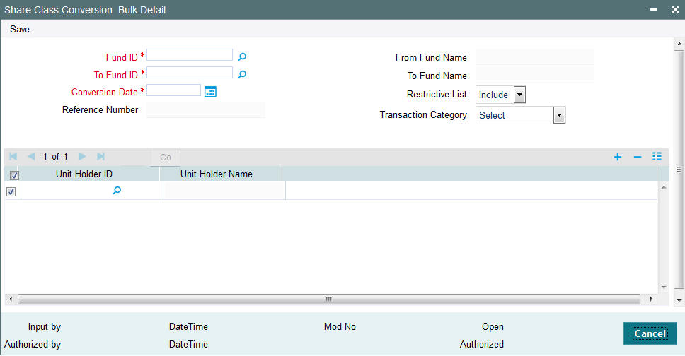

2.12 Share Class Bulk Conversion
This section contains the following topic:
2.12.1 Invoking Share Class Bulk Conversion
You can specify the fund ID and all the unit holders in the fund will
be considered by default for conversion. You can also specify the unit
holders to be included or excluded from the conversion. If ‘no
list’ is maintained, then all unit holders will be included, if
include list is maintained, only specified unit holders will be included
and if exclude list is maintained specified unit holders will be excluded.
one conversion transaction for each unit holder and fund combination.
A separate reftype (SB) under Switch transaction type will be used for
Bulk conversion transactions.
You can maintain Share Class Bulk Conversion details using ‘Share
Class Conversion - Bulk’ screen. You can invoke this screen by
typing ‘UTDSCBLK’ in the field at the top right corner
You can specify the
following fields:
From Fund ID
Specify the From Fund ID. You can also select the ‘From Fund
ID’ from the adjoining option list.
From Fund Name
Display
The system displays the From Fund Name details for the selected ‘From
Fund ID’.
To Fund ID
Specify the ‘To Fund ID’. You can also select the ‘To
Fund ID’ from the adjoining option list.
During transaction, if any ‘To fund’ is not maintained
the following error message:
To Fund Name
Display
The system displays the ‘To Fund Name’ details for the
selected ‘To Fund ID’.
Conversion Date
Display
Restrictive List
Select the appropriate value from the drop down list to include or
exclude the list of unit holders for conversion:
Optional
Select the transaction category from the following list of drop down
values:
- Select
- Advised Business
- Execution Only
- Legacy
Unit Holder ID
Unit Holder Name
Display
On authorization of the transaction, the system will do conversion
for Bulk transactions. All the bulk conversion transaction can be captured
and authorized without the conversion factor but only will be unitized
once the conversion factor is available. While conversion, if a rounding
difference of units occurs, then this will be handled manually.
The system will move the G1/G2 balance of ‘From Fund’
proportionately based on conversion factor to To fund.
Fund to To Fund. If for a UH, both Ad hoc and Bulk conversion is entered
then only one transaction will be considered for conversion, whichever
is authorized first (Ad hoc/Bulk).
If a bulk conversion is entered for the fund, the system will not
allow any inflow transactions but outflow transactions will be allowed.
However, system generated transactions will be allowed for inflow transactions.
of transaction date, unit holder ID, from fund and to fund combination
and if a similar transactions exists, then the system will display the
following message:

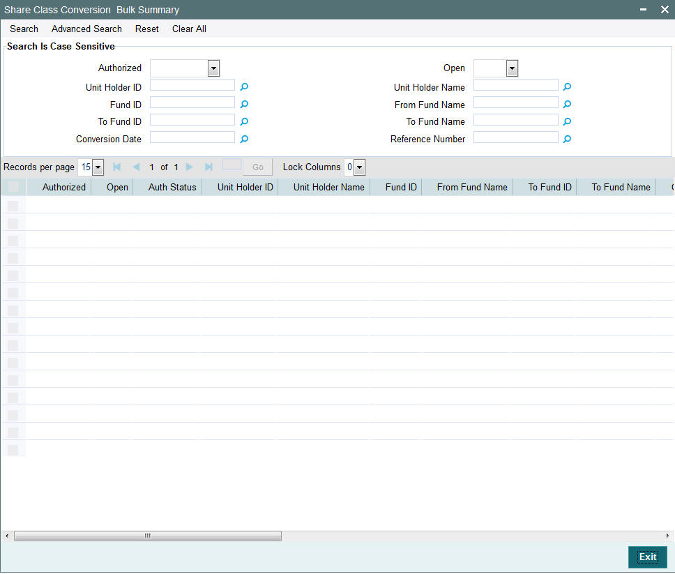

2.13.3 Viewing Share Class Bulk Conversion Details
To view a record that you have previously entered, you must retrieve
the same in the ‘Share Class Conversion - Bulk - Summary’
screen, as follows:
- Invoke the ‘Share Class Conversion - Bulk - Summary’
- The To Holder ID in the ‘To Holder ID’ field. If you
of the screen.
records. The ‘Share Class Conversion - Bulk - Detail’ screen
is displayed in the view mode.
2.13.4 Deleting Share Class Bulk Conversion Details
of the screen.
- Double-click the record that you want to delete. The ‘Share
Class Conversion - Adhoc -Detail’ screen is displayed.
- Select Delete operation from the Action list. The system prompts
you to confirm the deletion, and the record is deleted physically from
Note
The maker of the record can only delete the unauthorized
record.
2.13.5 Authorizing Share Class Bulk Conversion Details
Apart from the maker, someone else must authorize an unauthorized
global order record deal in the system for it to be processed. To authorize
a record:
- ‘The status of the transaction in the ‘Authorized’
field. Choose the ‘Unauthorized’ status.
- Click ‘Search’ button to view the records. All the records
with the specified details that are pending authorization are retrieved
- Select the Authorization operation from the Action list to authorize
the selected record.
2.13.6 Amending Share Class Bulk Conversion Details
After a global order record is authorized, it can be modified using
the Unlock operation from Action list. To make changes to a record after
authorization:
- Select the status of the transaction that you wish to retrieve for
amendment. You can only amend authorized records.
of the screen.
- Double-click the record that you want to amend. The ‘Share
Class Conversion - Bulk - Detail’ screen is displayed in the amendment
mode. Click the Unlock operation from the Action list to amend the record.
Amend the necessary information. Click the ‘Save’ button

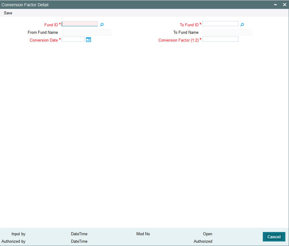

2.14 Conversion Factor
2.14.1 Invoking Conversion Factor Screen
You can specify conversion factor for the fund using ‘Conversion
Factor Detail’ screen. You can invoke this screen by typing ‘UTDCONVF’ in the field at the top right corner
You can specify the
following details.
From Fund ID
Specify ‘From Fund ID’ details. This adjoining option
list displays all valid ‘From Fund ID’ maintained in the
system. You can choose the appropriate one.
From Fund Name
Display
The system displays the ‘From Fund Name’ for the selected
‘From Fund ID’.
To Fund ID
Specify ‘To Fund ID’ details. This adjoining option list
displays all valid ‘To Fund ID’ maintained in the system.
To Fund Name
Display
‘To Fund ID’.
Conversion Date
Conversion Factor
Numeric; Optional
Specify the conversion factor.
