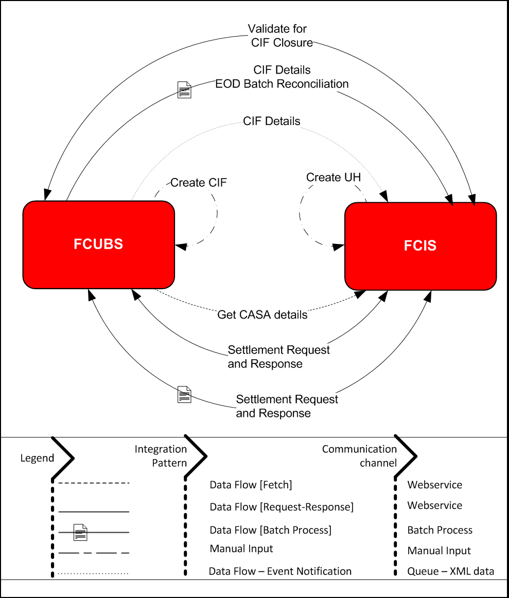

2.3 Data Flow and Integration Patterns
The following diagram provides a high-level information of the data flow and integration patterns used in FCIS-FCUBS integration.
The following table contains the integration processes, pattern of each process and the communication channels:
Integration Process
From
To
Integration Pattern
Communication Channel
Create CIF
FCUBS
NA
Manual input
Manual input
Create UH
FCIS
NA
Manual input
Manual input
Get CASA details
FCUBS
FCIS
Fetch (request-response)
Web service
CIF details
FCUBS
FCIS
Event processing
Queue - XML data
CIF details EOD batch reconciliation
FCUBS
FCIS
Transaction (batch process)
Batch process
Validate CIF closure
FCUBS/FCIS
FCIS/FCUBS
Transaction (request-response)
Web service
Settlement request and response
FCUBS/FCIS
FCIS/FCUBS
Web service
Settlement request and response - Batch
FCUBS/FCIS
FCIS/FCUBS
Batch process

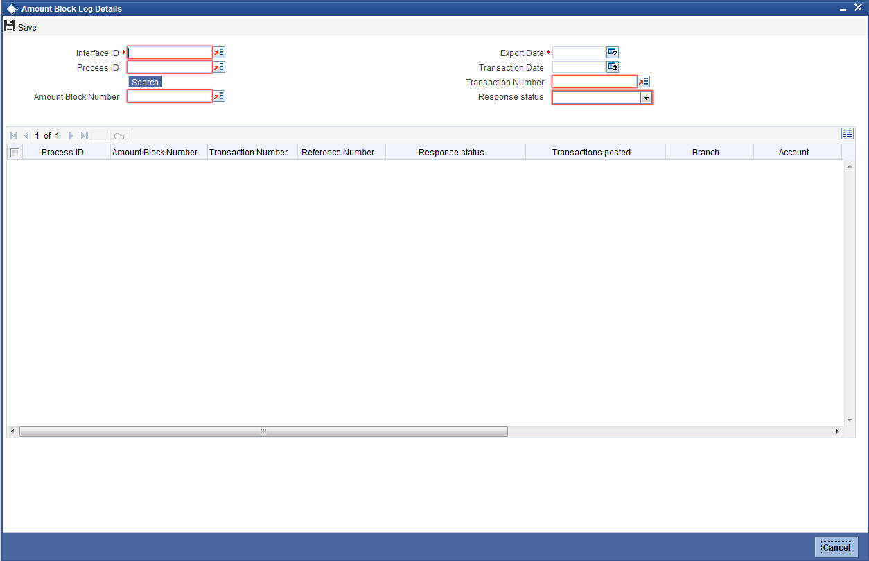

2.4.10 Amount Block Log Details
You can display status of Amount block Export and Import status for each transaction using ‘Amount Block Log Details’ screen. The screen will display any issues (along with the error description) encountered during amount block file creation and also error encountered (with error message) while importing response file for each transaction. You can invoke the ‘Amount Block Log Details’ screen by typing ‘UTDAMLOG’ in the field at the top right corner of the Application tool bar and clicking on the adjoining arrow button.
You can specify the following details:
Interface ID
Alphanumeric; 8 Characters; Mandatory
Specify the interface ID.
Process ID
Specify the process ID.
Amount Block Number
Numeric; 8 Characters; Mandatory
Specify the amount block number.
Export Date
Date Format; Mandatory
Specify the export date.
Transaction Date
Date Format; Optional
Specify the transaction date.
Transaction Number
Numeric; 16 Characters; Mandatory
Specify the transaction number.
Response Status
Mandatory
Select the response status from the drop-down list. The list displays the following values:
After specifying all the mandatory details clicking ‘Search’ button, the system displays the following details:
Systematic Investment Plans (SIP)
During BOD process, the FCIS system generates amount block creation flat file for the SIP transactions whose payment is due on that day. The file is sent to FCUBS system. Based on successful response of amount block creation from FCUBS, SIP subscription transactions are created in FCIS.
Amount Block Data Exchange
Source System
Target System
Operation
Action
Webservice/Notification Name
Synchronous/Asynchronous
FCIS
FCUBS
New Transac­tion -Amount block Crea­tion
Save
Webservice call from insulation layer
FCUB­SCustom­erService
Synchro­nous
FCIS
FCUBS
Transaction Amendment and Change in amount -Amount block amendment
Save
Synchro­nous
FCIS
FCUBS
Online Amount block failure recon­ciliation
Recon­ciliation
Flat file
NA
Asynchro­nous
FCIS
FCUBS
SIP process during BOD - amount block creation
BOD batch
Flat file
NA
Asynchro­nous

2.5 Investor Fund Details in 360 Degree Customer View
From Oracle FCUBS, you can view the fund details on an investment customer using ‘360 Degree Retail Customer View’ (STDCUSVW) screen.
FCIS system hands off the details of funds to FCUBS system during a query from ‘360 Degree Retail Customer View’ screen.
You can view the following investor fund details:
Data Exchange
Source System
Target System
Operation
Action
FCUBS
FCIS
360 degree customer view screen - unit hold­ing details
Query
Webser­vice
FCISCus­tomerInquiry
Synchro­nous
