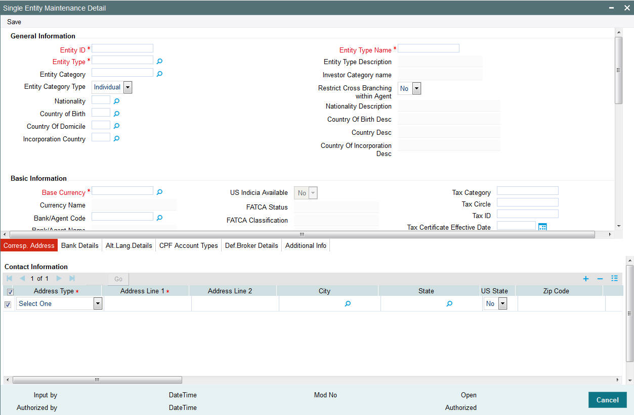

5.7 Bulk Account Clients Maintenance
5.7.1 Invoking Single Entity Maintenance Detail Screen
You can enter the record of a client for whom the bulk import facility would be used, into the system, by creating it as an entity.
You can set up a bulk client in the ‘Single Entity Maintenance Detail’ screen. You can invoke this screen by typing ‘UTDENTMN’ in the field at the top right corner of the Application tool bar and clicking on the adjoining arrow button.
To set up a bulk client, select the Bulk Client option from the option list in the Entity Type field in the General Information section, and then proceed to enter the details for the bulk client. You must specify all information such as the common information, basic information and contact details for any bulk client that you set up.
You must also capture the following additional details specifically for a bulk client:
Only those fields specific to bulk clients are detailed here.
Refer the chapter ‘Maintaining Reference Information’ of FC-IS system for a discussion of the other fields common to all entity type.

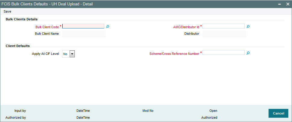

You can use this screen to map the default values for all information that must be applicable during bulk information import for a particular bulk client, for a particular AMC or Distributor.
For any import from any bulk client, the information specified in the hand-off file will be accepted and imported as part of the imported record, even if a specification exists in this screen for the same field or column name. Any information that is not specified in the hand-off file will be picked up from the specifications you make in this screen.
You can maintain default information for bulk imports relating to:
You can invoke this screen by clicking the Detail option under the Bulk Client Defaults menu in the Browser. Click new icon to enter the details.
5.8.2 Maintaining Default Information for Bulk Client Imports
In the Bulk Client Defaults Maintenance screen, you can maintain default information for bulk imports from a bulk client, to be applicable for a distributor institution. The specifications you make in any of the fields here, for each upload type, are accepted as the default values for the corresponding field or column name, for all bulk imports where the hand off files from the bulk client do not contain the corresponding information.
Accordingly, you must select the ID of the bulk client for whom the default information is applicable, in the Bulk Account Client Code field, and the AMC / distributor entity in the AMC / Distributor ID field.
For some of the upload types, the default information consists of fields from the corresponding maintenance in the system; therefore, the default information is very similar to a maintenance template or blueprint. For instance, when you define the defaults for fund rules import, you specify all the fund rules in the Bulk Clients Defaults screen. This is just like filling in the fund rules in the system for a new fund; validations for all fields are similar to those made in the Fund Rules screens when a new fund is entered.
The default information for each upload type is listed in this chapter; for field level information, you must refer the chapters in the user manual where the corresponding entry screen in the system is discussed.

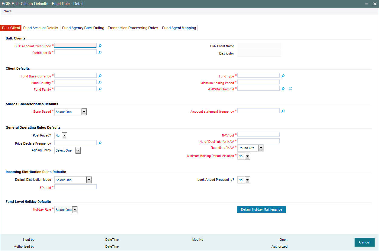

5.8.2.5 Default Information for Fund Rules Imports
You can invoke the FCIS Bulk Clients Defaults (Fund Rule) Detail screen by typing ‘UTDBLKFR’ in the field at the top right corner of the Application tool bar and clicking on the adjoining arrow button.
You must maintain the following default information for fund rules imports:
Client Defaults
Shares Characteristics
General Operating Rules
Transaction Processing Rules
Income Distribution Rules
Fund Entity Mapping
Fund Level Holiday Defaults
Fund accounts
Backdating rules for fund agency branches

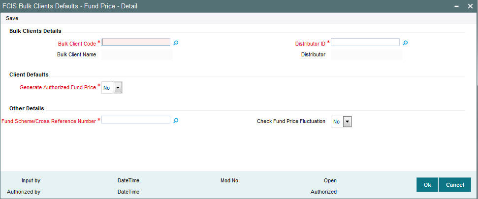

5.8.2.6 Default Information for Fund Price Imports
The only default information to be maintained for fund price import is whether authorized fund prices must be generated for the fund.
Specify this in the Generate Authorized Fund Price field. You must also specify the Fund Scheme / Cross Reference Number.
You can invoke the FCIS Bulk Clients Defaults (Fund Price) Detail screen by typing ‘UTDCDFP’ in the field at the top right corner of the Application tool bar and clicking on the adjoining arrow button.

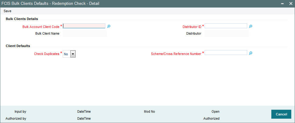

5.8.2.8 Default Information for Redemption Check Imports
You can invoke the FCIS Bulk Clients Defaults (Redemption Check) screen by typing ‘UTDBLKRC’ in the field at the top right corner of the Application tool bar and clicking on the adjoining arrow button.
For redemption check imports, you must maintain:

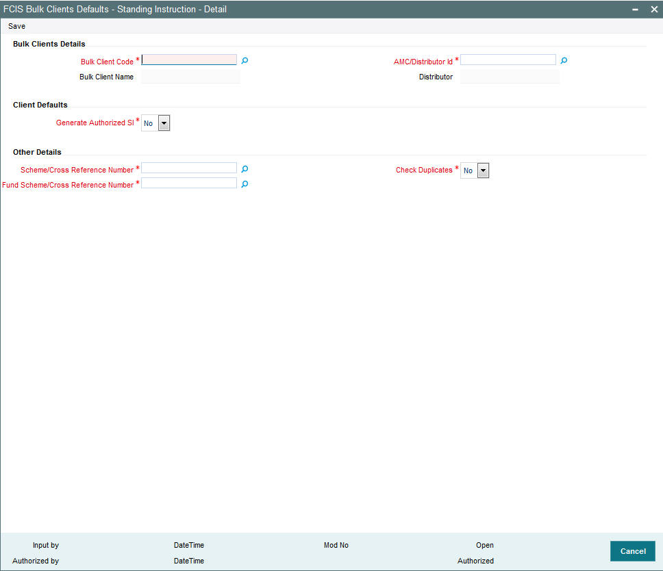

5.8.2.9 Default Information for Standing Instructions Imports
You can invoke the FCIS Bulk Clients Defaults (Standing Instruction) screen by typing ‘UTDBLKSI’ in the field at the top right corner of the Application tool bar and clicking on the adjoining arrow button.
For standing instructions imports, you must maintain:

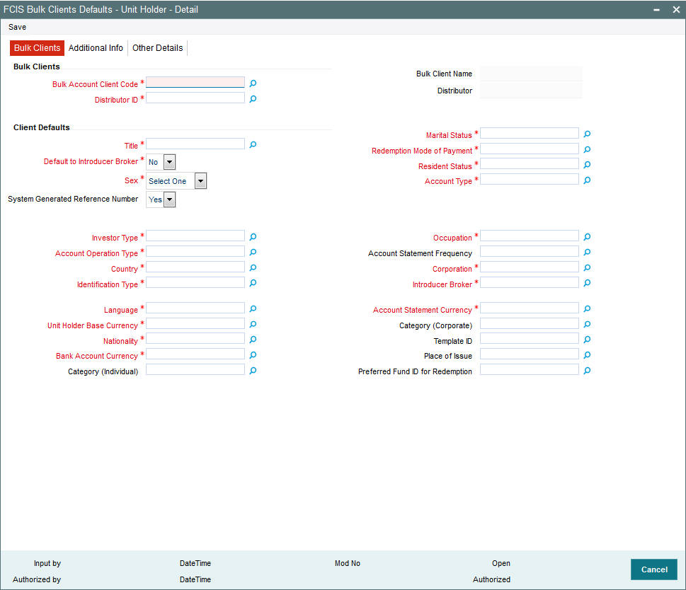

5.8.2.12 Default Information for Unit Holder Accounts Imports
You can invoke the FCIS Bulk Clients Defaults (Unit Holder) screen by typing ‘UTDBLKUH’ in the field at the top right corner of the Application tool bar and clicking on the adjoining arrow button.
For import of unit holder accounts, you must maintain:
Client Defaults

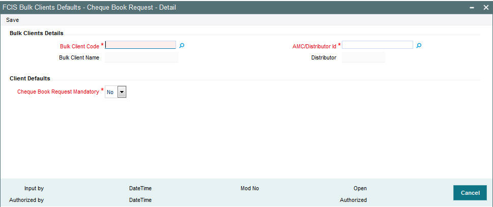

5.8.2.14 Default Information for Check Book Requests Imports
For check book request imports, you must maintain whether check book requests are mandatory.
You can invoke the FCIS Bulk Clients Defaults (Cheque Book Request) screen by typing ‘UTDBLCBR’ in the field at the top right corner of the Application tool bar and clicking on the adjoining arrow button.

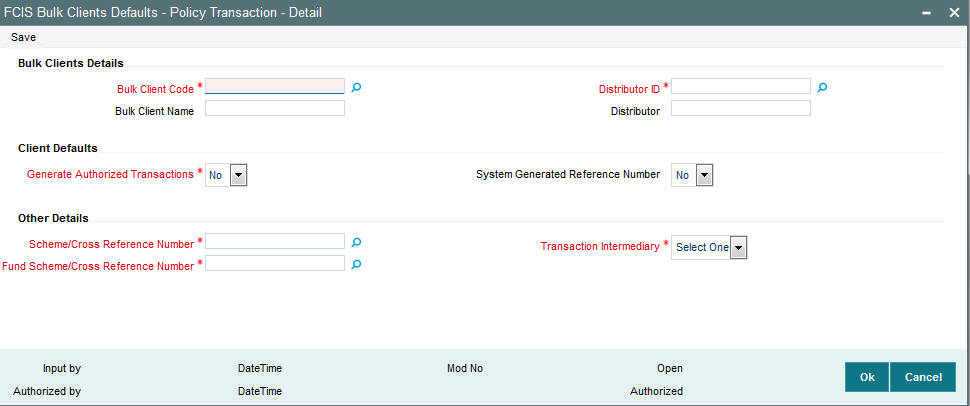

5.8.2.15 Default Information for Policy Transactions
You can invoke the FCIS Bulk Clients Defaults (Policy Transaction) screen by typing ‘UTDBLKPT’ in the field at the top right corner of the Application tool bar and clicking on the adjoining arrow button.
For policy transactions import, you must maintain:

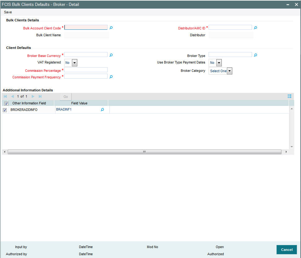

5.8.3 Maintaining Default Information for Broker
You can invoke the FCIS Bulk Clients Defaults (Broker) screen by typing ‘UTDBLCBD’ in the field at the top right corner of the Application tool bar and clicking on the adjoining arrow button.
For Broker import, you must maintain:
5.8.4 Maintaining Default Information for UH Deal Upload
You can invoke the FCIS Bulk Clients Defaults (UH Deal Upload) screen by typing ‘UTDBLUHD’ in the field at the top right corner of the Application tool bar and clicking on the adjoining arrow button.
For UH deal import, you must maintain:
Only those fields in the header portion of the screen are discussed here. For the other fields, depending upon the upload type, you must refer the user manual files for the corresponding maintenance in the system.
9 Characters Maximum, Alphanumeric, Mandatory
Select the bulk client for whom the bulk default information is being set up.
Once you select the Bulk Client Code, the name of the Bulk Client is displayed alongside.
AMC
6 Characters Maximum, Alphanumeric, Mandatory
Select the ID of the AMC or distributor for which this Bulk Client - AMC / Distributor combination defaults maintenance record is being setup in this screen.
Disable Bulk A/C Default Setup
1 Character Maximum, Boolean, Mandatory
You can use this option to disable the setup that you are defining in this record if its use is not imperative. If you disable the default setup for the Bulk Client - AMC / Distributor by checking this box, any of the imports for this Bulk Client -AMC / Distributor combination will not be carried out.
