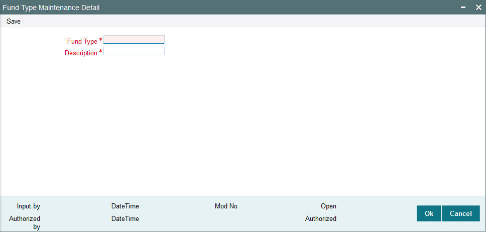

Before any fund may be set up in the system, the types of funds that can be maintained must be set up in the ‘Fund Type Maintenance Detail’ screen. You can invoke the ‘Fund Type Maintenance Detail’ screen by typing ‘UTDFNTYP’ in the field at the top right corner of the Application tool bar and clicking on the adjoining arrow button. The ‘Fund Type Maintenance Detail’ screen is displayed. Select ‘New’ from the Actions menu in the Application tool bar or click new icon to enter the Fund Type.
Fund Type
4 Character Maximum, Numeric, Mandatory
Specify an identification for the fund type that you wish to set up.
Description
Alphanumeric, Mandatory
Enter a brief description for the fund type.

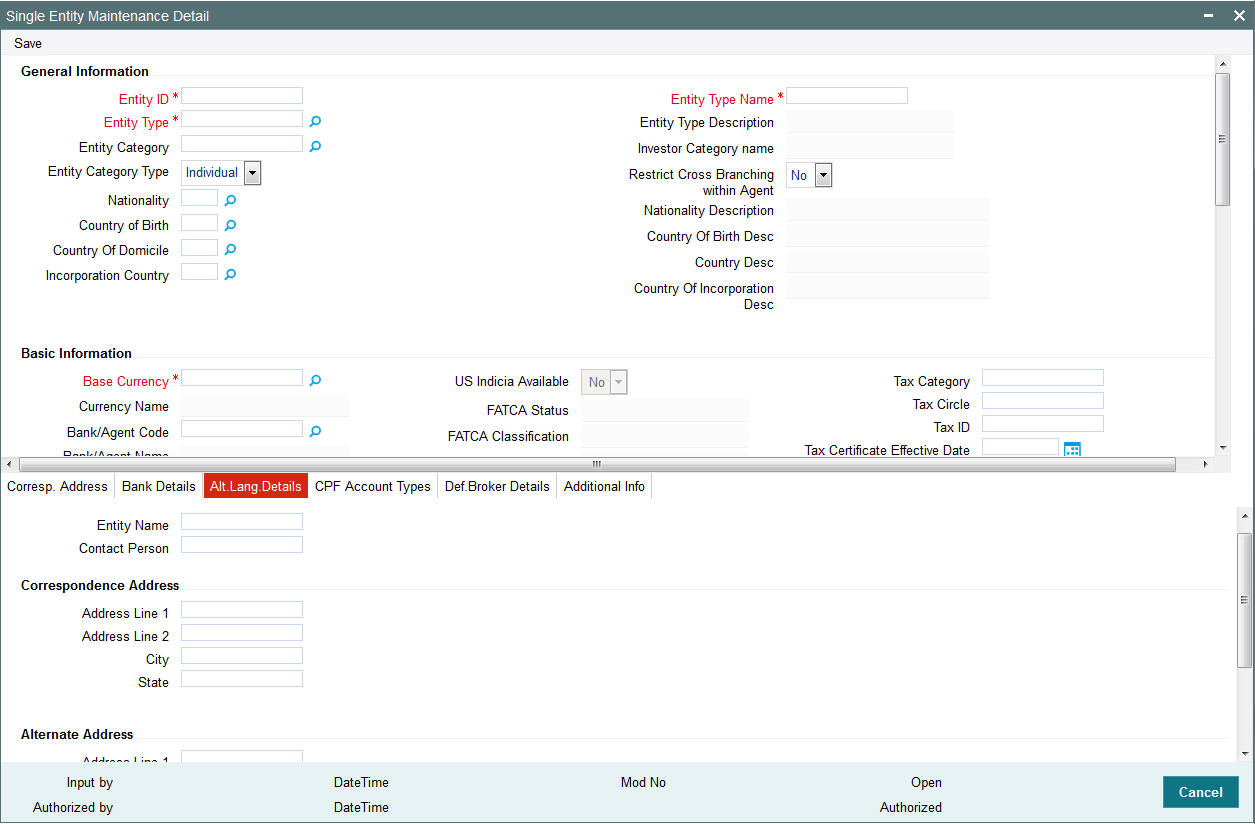

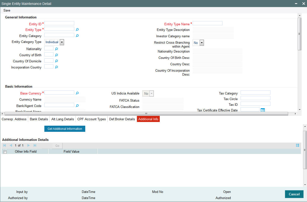

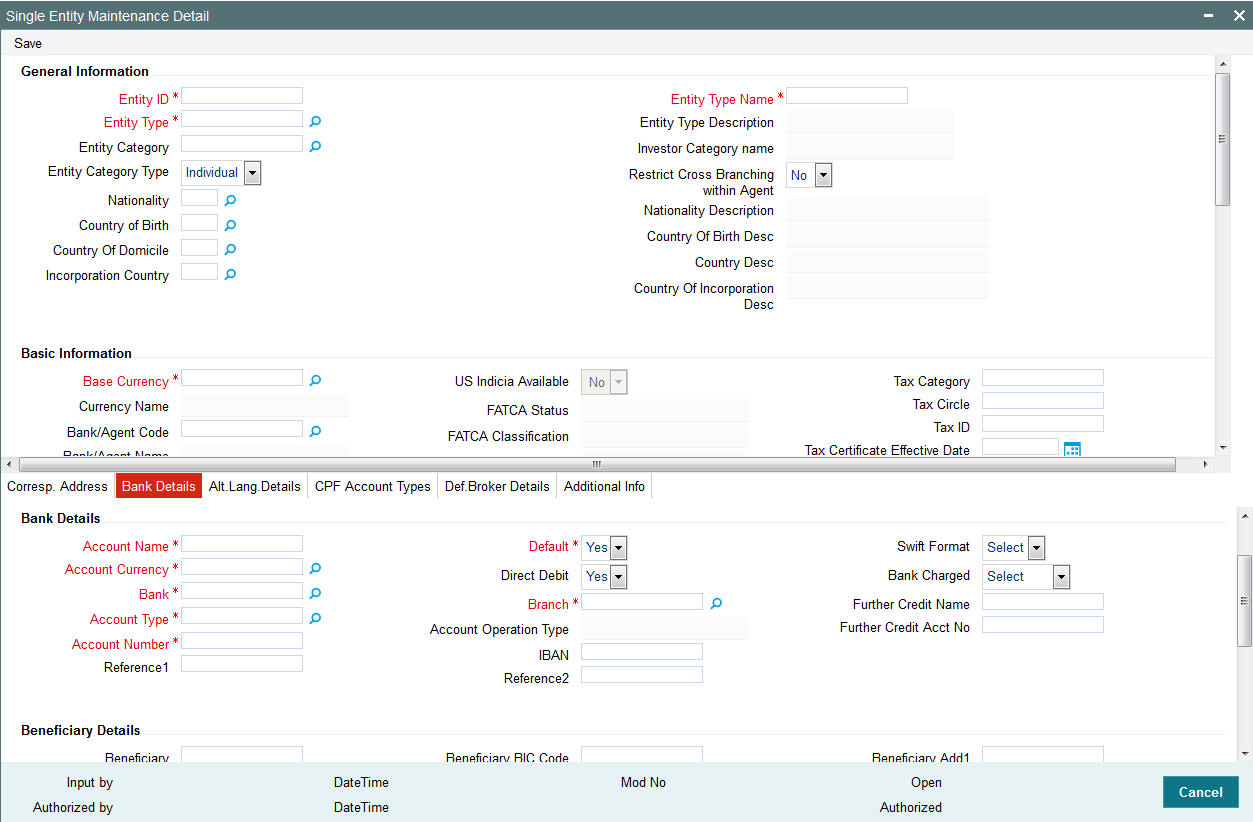

You can invoke the ‘Single Entity Maintenance Detail’ screen by typing ‘UTDENTMN’ in the field at the top right corner of the Application tool bar and clicking on the adjoining arrow button.
The ‘Single Entity Maintenance Detail’ screen is displayed. Select ‘New’ from the Actions menu in the Application tool bar or click new icon to enter the details of the entity.
Entity Type
Specify the type of entity being set up. This could be any of the following:
Entity Type Description
Display Only
The system displays description for the specified entity type here based on the details maintained in the system.
Entity ID
12 characters maximum, Alphanumeric, Mandatory
The Entity ID is a unique Identification for an entity in the system. Any detail regarding an entity is obtained by using the entity ID for reference. The ID you specify here must be unique and not already in use for any other entity in the system.
Entity Name
60 Character Maximum, Alphanumeric, Mandatory
Specify the name (or description) of the entity being set up in the system.
Entity Category Type
Alphanumeric; Optional
Specify whether the entity being maintained belongs to the Individual or Corporate categories. This specification is optional; if specified, you must also select the appropriate category in the Entity Category field.
Note
AMC entity supports only corporate category.
Entity Category
Alphanumeric; Conditional
From the drop down list, select the category to which the entity belongs.
Nationality
Select the nationality from the adjoining option list.
Country of Birth
Select the country of birth from the adjoining option list.
Country of Domicile
Select the country of domicile from the adjoining option list.
Country of Incorporation
Select the Incorporation country from the adjoining option list.
Country Code for all Telephone Numbers
Optional
Specify the country code for the telephone number.
Category Name
Display Only
The system displays investor’s category name here based on the details maintained in the system.
Base Currency
Select the base currency of the entity, from the drop down list. This is the currency in which the entity normally transacts.
Authorized Signatory
70 Character Maximum, Alphanumeric, Optional
Enter the name of the Authorized Signatory at the office of the AMC.
Bank/Agent Code
3 characters maximum, Numeric, Mandatory
An Agent Code is a unique Identification for an Agent in the system. Using the Agent code for reference can retrieve any detail with regard to an Agent. Select the Agent for whom you want to set the branch from the list provided.
An Agency Branch can be set up only after the Agent has been set up. The list will be populated with valid Agent codes existing in the system.
Bank/Agent Name
Display Only
The system displays the name of the specified Bank or Agent name here.
If you are maintaining Bank Branch as agent, then the system displays Bank name. If you are maintaining Agency Branch as agent, then the system displays Agent name.
MICR Code
Optional
Specify MICR code of the specified Bank here. This code is applicable for both Bank and Bank Branch entity.
Tax ID
Specify the tax identification.
Employer ID Number
Specify the employer ID number.
Tax Certificate Effective Date
Date Format
Specify the date from which the tax certificate is effective.
Tax Certificate Expiry Date
Date Format
Specify the expiry date of the tax certificate.
Tax Circle
Select the tax circle country from the adjoining option list.
FATCA Classification
Display
The system displays the FATCA classification type.
FATCA Status
Display
The system displays the FATCA Status based on the FATCA maintenance.
US Indicia Available
Display
The system defaults US Indicia Available as Yes or No depending on the following:
FATCA Sponsor Type
Optional
Select the FATCA sponsor type from the adjoining drop down list. The values are:
If you select ‘Sponsoring Entity’, you need to specify the sponsoring entity type and sponsoring entity ID.
If you select ‘Sponsored Entity’, you need not to specify the sponsoring entity type and sponsoring entity ID.
Sponsoring Entity Type
Numeric; 8 Characters; Mandatory
Specify the sponsoring entity type. You can also select the valid entity type from the adjoining option list.
Sponsoring Entity ID
Alphanumeric; 8 Characters; Optional
Specify the sponsoring entity for the FATCA entity type. You can also select the valid entity ID from the adjoining option list.
GIIN Issue Date
Date Format; Optional
Specify the GIIN issue date.
The GIIN issue date cannot be greater than the application date.
GIIN Expiry Date
Specify the GIIN expiry date.
The GIIN expiry date cannot be lesser than the GIIN issue date.
Global Intermediary Identification Number (GIIN)
You can select or specify the GIIN from the adjoining option list.
GIIN Verified Flag
Display
System displays the GIIN verified flag based on the GIIN. If you specify the GIIN then, GIIN verified flag gets displayed as ‘No’. If you select the GIIN then, GIIN verified Flag gets displayed as ‘Yes’.
WeekEnd
The Fund Manager System weekend options that were designated at the time of installation will be considered as default options for an AMC, but you can alter them, if necessary, while setting up the AMC record in the Single Entity Maintenance screen.
You can only specify two days as weekend days. The days you specify here are defaulted as weekend holidays for the AMC in the AMC calendar.
Section
Specify any descriptive text about or qualification for the AMC being maintained.
Cross Branching Allowed
Optional
Select ‘Yes’ if you want to allow cross branching for the specified entity ID from the adjoining drop-down list. If you need to disallow cross branching, then select ‘No’ from the adjoining drop-down list.
Online Interface
Optional
Select ‘Yes’ to utilize the created Bulk Client as online interface from the adjoining drop-down list, if you have maintained ‘Entity Type’ as ‘Bulk Client’. This field is not applicable for other entity types.
Module/Agent Type
Select the type of the Module that is being set up.
Module/Agent Desc
Display Only
The system displays description for the specified agent type.
Nature of Business
Specify the business avenues supported by the AMC, by selecting the desired option from the drop down list. This option is only available for entities where the entity type is AMC.
Finware Posting
Choose ‘Yes’ if you wish to allow FINWARE posting.
ISA Reference Number
Alphanumeric; 5 Characters; Optional
Specify ISA reference number.
Min ISA Transfer In
Specify the minimum ISA that is validated during the transfer in.
Min ISA Transfer Out
Specify the minimum ISA that is validated during the transfer out.
Switching Logic
Alphanumeric, Mandatory if Entity Type is AMC
Select the type of logic to be enforced by the AMC in accepting switch transactions. There are two possible approaches provided by the system:
For distributor installations, the switching logic will not be applicable.
Unit Holder Generation Logic
Click on the drop-down menu and choose any one of the options available. This option enables multiple AMC branches to opt for different unit holder ID generation logic. Therefore the UH Generation Logic field will be a valid value from UH generation table for a specific AMC, service provider, or a distributor.
If UHGENSEQ Param code is maintained then the first 6digits of the value maintained will be taken as the LeadingDigits followed by serial. If it is not maintained then the LeadingDigits will be LeadingZero followed by serial.
Note
The above option is applicable only for service provider installations.
FLEXCUBE-IS Installed
1 Character Maximum, Boolean, Mandatory
Click in the check box to check if Oracle FLEXCUBE Investor Servicing is installed at the Agency Branch.
Signed Off?
1 Character Maximum, Boolean, Display
This indicates whether the given Agent has signed off for the day. This is not used at setup time, but used only for EOD purposes. by default, when you set up an agent, the agent record is set up with the status ‘signed on’, which means this field has a ‘No’ value.
Customer Interface Key
This facility is to be used if customer information from an installation of Oracle FLEXCUBE Corporate (FCC) is to be imported into the FC-IS system using the bulk interface facility, for the creation of unit holder accounts.
The customer interface key determines the level at which unit holder account creation must take place in the FC-IS system, for a given Customer Information File (CIF) in Oracle FLEXCUBE Corporate – either at CIF level or at a customer account level. Accordingly, you can indicate either of the following two options:
The FC-IS system will create corresponding unit holder accounts when the customer information is imported from FCC, according to option you exercise in this field.
Note
If you select either FCR or FCC as the Bulk Client Type, then you must specify the Customer Interface Key as mandatory information.
Effective Date for Capital Gains Calculations
Date Format, Mandatory
Specify the date on which capital gains calculations must begin, for the AMC. This feature is only available if your installation has specifically requested for it.
It is mandatory for you to specify the effective date if EUSD average cost is to be computed.
Restrict Cross Branching with Agent
Select Yes Cross Branching is allowed at this branch. By enabling this, the agency branch will be allowed to view details, perform transactions pertaining to the unit holders created by the other agency branches in the system. If this field is not clicked, the agency branch will be able to view details and transact for the unit holders created by him only.
As part of correspondence details, you can capture correspondence address, alternate address and SWIFT address. Click ‘Corresp Address’ tab to maintain the correspondence details.
Address Type - Correspondence Address
Address Lines 1-2
Each line is 80 Characters Maximum, Alphanumeric. Address Line 1 is Mandatory
Enter the address of the entity being set up in the system.
City
20 Character Maximum, Alphanumeric, Optional
Enter the city where the entity is located. You can select the city from the drop down list provided. The available options depend on the values defined at the params maintenance. If the city is not available in the list, you can specify the city in the field provided alongside.
State
Enter the State where the City is located. You can select the state from the drop down list provided. The available options depend on the values defined at the params maintenance. If the state is not available in the list, you can specify the city in the field provided alongside.
Country
Select the country in which the entity is based, from the drop-down list. If the Address type is SWIFT Address, enter the country of the SWIFT address for the entity.
US State
Optional
Check this box to indicate that the specified state is a US (United States) state.
Zip Code
6 Characters Maximum, Alphanumeric, Optional
Enter the Zip Code of the Address of the entity being set up.

Click ‘Bank Details’ tab to capture the bank details in the Bank Details section in the Single Entity Maintenance screen.
Account Name
Specify the name in which the entity holds the specified bank account.
Account Currency
From the list, select the currency that the specified bank account uses. You can maintain any number of accounts in each currency; however, you must designate one default bank account for each currency.
Bank
From the list, select the name of the bank in which the account is held.
Branch
From the list, select the name of the branch of the bank in which the account is held.
Account Type
From the list, select the nature of the account held by the entity.
The list provides all account types that have been set up in the Account Type Maintenance records.
Account Number
15 Character Maximum, Alphanumeric, Mandatory
Specify the number of the account held by the entity in the selected bank.
Swift Format
Indicate one of the following swift formats from the drop-down list:
Beneficiary
Enter the beneficiary Details
Beneficiary Address1
Specify the first line of beneficiary address
Beneficiary Address2
Specify the second line of beneficiary address
Beneficiary Address3
Specify the third line of beneficiary address
Beneficiary IBAN
Specify the beneficiary IBAN
Intermediary
Specify the intermediary
Intermediary Add 1
Specify the first line of beneficiary intermediary
Intermediary Add 2
Specify the second line of beneficiary intermediary
Intermediary Add 3
Specify the third line of beneficiary intermediary
Intermediary IBAN
Specify the intermediary IBAN
Further Credit Name
Specify the further credit name
Reference 1
Enter the first reference
Default
Use this check box to identify the bank account that is to be reckoned as the default bank account for the entity in the system, for the selected currency.
Direct Debit Allowed
Optional
You can use this field to indicate whether direct debits may be raised in respect of the bank account you are defining for the entity. Check the box to indicate that direct debits are allowed; leave it unchecked to indicate that they are not.
IBAN
36 Characters Only; Alphanumeric; Optional
Specify the IBAN (International Bank Account Number) of the account holder.
Bank Charged
Indicate one of the following from the drop-down list:
Beneficiary Acct No
Specify the account number of the beneficiary.
Beneficiary Code
Specify the code of the beneficiary.
Beneficiary BIC Code
Specify the BIC code of the beneficiary.
Beneficiary Info
Specify the information about the beneficiary.
Intermediary Acct No
Specify the account number of the intermediary
Intermediary Code
Specify the code of the intermediary.
Intermediary BIC Code
Specify the BIC Code of the intermediary.
Intermediary Info
Specify the information about the intermediary.
Further Credit Acct No
Specify the further credit account number.
Reference2
Specify the second reference
The system allows you to capture entity details in an alternate language of your desire. These fields are captured for information purposes only and no processing would be done on them. Click ‘Alt Lang Details’ tab to maintain the alternate language details.
You can maintain the following information in an alternate language provided you have captured the information in the default language.
Entity Name
Specify the name of the entity being set up in the system.
Contact Person
Enter the name of the contact person at the entity’s offices.
Address Lines 1-2
Enter the default postal address that is to be used for correspondence with the entity being set up in the system.
City
State
Address Lines 1-2
Enter the alternate postal address that is to be used for correspondence with the entity being set up in the system.
City
State

Check against the following fields in the additional tab:
Click on the Get Additional Information button in the screen.
After saving the above listed details in the single entity maintenance screen, click on the Exit button.

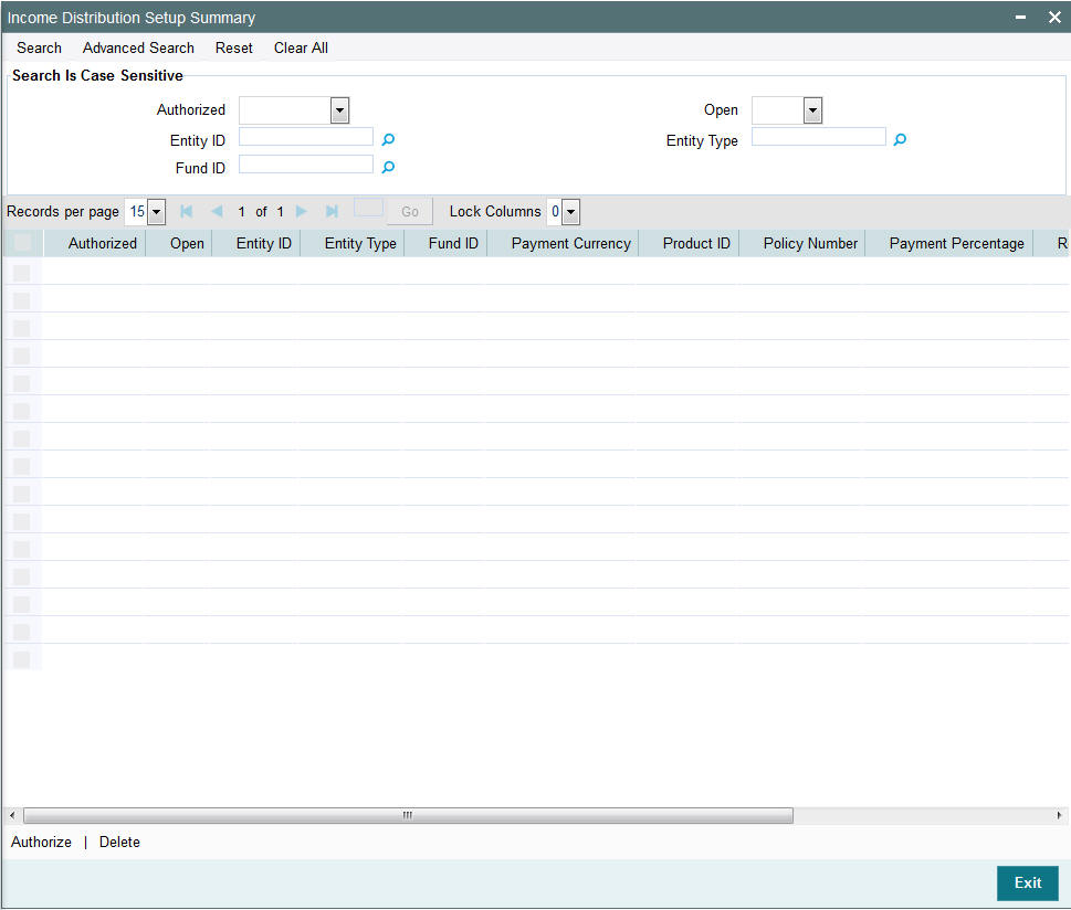

The different entities involved in transactions in funds of the AMC avail of earnings resulting from their involvement. For instance, an intermediary (such as a broker) derives commission earnings from the transactions in the funds of the AMC.
Each of the entities could opt for any of the following ways of using earnings from transactions:

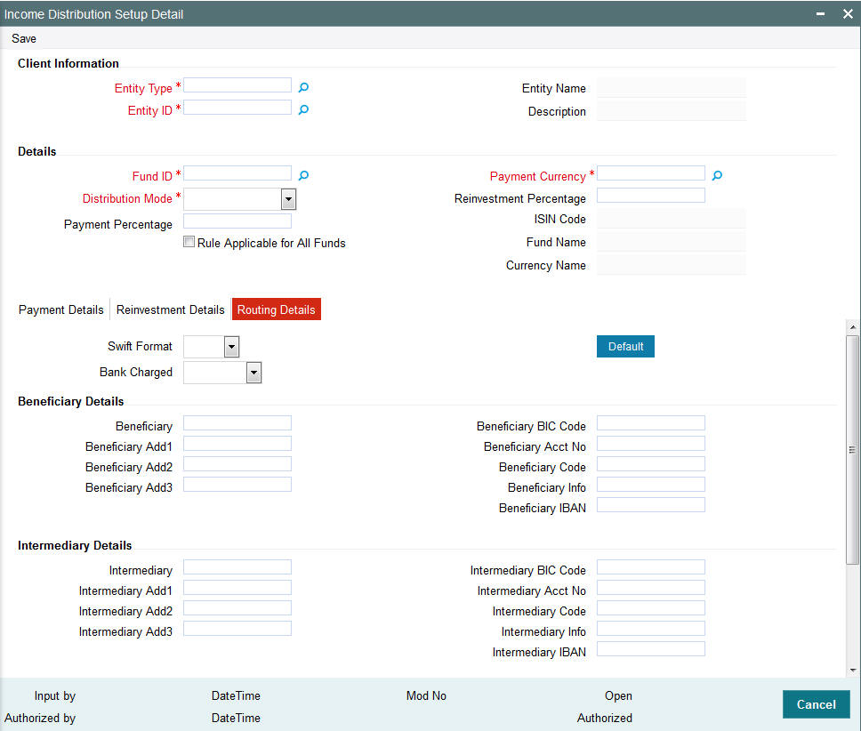

The pattern chosen by the entity to use earnings is known as the Income Distribution Setup pattern or the IDS pattern for the entity.
You can capture this pattern for any entity in the Oracle FLEXCUBE Investor Servicing system, in the ‘Income Distribution Setup Detail’ screen. You can invoke this screen by typing ‘UTDBRIDS’ in the field at the top right corner of the Application tool bar and clicking on the adjoining arrow button.
Select ‘New’ from the Actions menu in the Application tool bar or click new icon to enter the details.
In this screen, you set up the IDS pattern by:
In this section, select the code of the broker for whom you are creating an income distribution setup record.
Entity Type
Alphanumeric; Mandatory
Select the type of entity for which you are setting up Income Distribution options. You can select any of the following entity types, as applicable:
For entities other than brokers, the IDS options that you set up in this screen are applicable for commission payments only, and only the ‘Payment’ distribution mode can be set.
Entity ID
Specify the ID of the entity for whom you are creating the income distribution options in this screen. The name of the entity that you select is displayed alongside the field.
Entity Name
Display Only
Based on your selection for Entity ID, the system displays the corresponding Entity Name.
Description
Display Only
The system displays description of the specified entity here based on the details maintained at ‘Single Entity Maintenance’ level.
In this section, you can indicate the fund, the income earnings from which will be distributed according to the IDS options you are creating for the selected entity. You can also indicate the manner in which the income must be distributed.

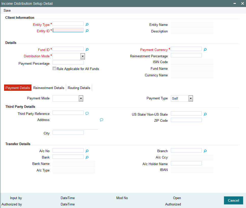

As part of maintaining the payment details, you can define the pattern in which the entity can receive income earnings in the form of payment. The entity can receive the payment income either in the form of checks or through account transfers.
If you have chosen either Both or Full Payment as the distribution mode, you must specify all information in this section.
Click ‘Payment Details’ tab in the ‘Income Distribution Set Up Detail’ screen to specify the payment details for the entity.
Payment Mode
From the list, select the mode in which the entity prefers to receive the paid portion of the income earned – either in the form of a check or an account transfer.
Payment Type
From the list, indicate whether the check payment instrument must be addressed to the entity (self) or a third party.
You will be allowed to maintain the third party details if you have selected ‘Third Party’ for Payment Type.
Third Party Reference
Alphanumeric, Mandatory for ‘Third Party’ payment
Specify the name or reference of the third party for which the check instrument must be made out.
Address
Specify the address of the third party for which the check instrument must be made out.
City
Select the city of residence of the third party for which the check instrument must be made out.
Zip Code
9 Characters Maximum, Alphanumeric, Mandatory for ‘Third Party’ payment
Specify the zip code of the city of residence of the third party for which the check instrument must be made out.
US State/Non-US State
Select the state of residence of the third party for which the check instrument must be made out.
Select Bank Account
Mandatory for Self payment type
Select the bank account to which the transfer payment of the income must be made.
The details of the account you select are displayed in the bank account details fields.
You must select a bank account for which the currency is a valid fund bank account currency so that the income payment transfer can be affected.
Note
For commission payments for entities other than brokers, the account you specify here is used as the default settlement account. If IDS options have not been set for an entity, (and this account is not specified), settlement of commission payment is made to the entity’s default bank account, specified in the Entity Maintenance.
Bank Name
Numeric, Mandatory for Third Party transfer payment
Select the name of the bank in which the transfer account is present, from the drop down list.
Branch
20 Character Maximum, Alphanumeric, Mandatory for Third Party transfer payment
Specify the branch name of the bank in which the transfer account is present.
A/C Type
1 Character Maximum, Alphanumeric, Mandatory for Third Party transfer payment
Select the account type (Fixed, Savings or Current) of the transfer account.
A/C No
16 Character Maximum, Alphanumeric, Mandatory for Third Party transfer payment
Specify the number of the transfer account.
A/C Ccy
Specify the currency of the transfer account. The currency specified here must be a valid fund bank account currency.
A/C Holder Name
Specify the name of the holder of the third party account.
IBAN

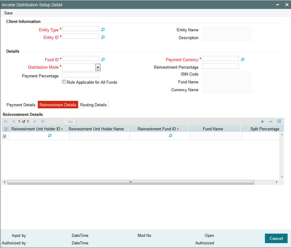

As part of maintaining the reinvestment details, you can define the pattern in which the entity can reinvest income earnings back into the funds of the AMC. The entity can reinvest earned income in any of the following ways:
Note
Reinvestment is only allowed into or out of a fund if so designated in the Corporate Actions profile for the fund and corporate action type.
If you have chosen either Both or Full Reinvestment as the distribution mode, specifying all information in this section is mandatory.
Click ‘Reinvestment Details’ tab to capture the details.
Reinvestment Unit Holder ID
12 Character Maximum, Alphanumeric, Optional
Specify the ID of the unit holder in whose account the income is to be reinvested. When you select the ID of the reinvestment unit holder, the name of the unit holder is displayed in the Reinvestment Unit Holder Name field.
The entity’s default Unit Holder ID is displayed here. If necessary, you can change it.
Re-investment Unit Holder Name
Display Only
The system displays the name of the Unit Holder based on the Reinvestment Unit Holder ID.
Reinvestment Fund ID
6 Character Maximum, Alphanumeric, Optional
Select the ID of the fund in which the income is to be reinvested.
Fund Name
Display Only
The system displays name of the specified reinvestment fund based on the details maintained at ‘Fund Maintenance’ level.
Split Percentage
Numeric, Optional
Specify the percentage of the derived income that is to be reinvested in the specified reinvestment unit holder's account, in the specified reinvestment fund. You can make any number of such entries, specifying a percentage for each combination. The sum total of all split percentages for all reinvestment unit holder – reinvestment fund ID combinations you have specified must be equal to one hundred percent.
Click on the Routing Details tab to enter routing details.
You need to maintain the following details:
Swift Format
Optional
At the time of transaction input, the routing details specified here are picked up for the combination of fund, transaction type and transaction currency.
Bank Charged
Optional
Indicate whether the bank charges must be levied upon the beneficiary, the remitter or must be shared between the two.
Beneficiary
Specify the beneficiary name.
Beneficiary Add 1
Specify the beneficiary address. There are three lines available for the same.
Beneficiary Acct No
Beneficiary Code
Beneficiary Info
Enter more information about the beneficiary.
Intermediary
Specify the intermediary detail.
Intermediary Add 1
Specify the intermediary address. There are three lines available for the same
Specify the BIC code of the Intermediary.
Specify the account number of the Intermediary.
Intermediary Code
Specify the code of the Intermediary.
Intermediary Info
Enter more information about the Intermediary.
Save all the details to proceed or click cancel button to cancel the operation.
After you set up the IDS options for an entity in the Income Distribution Setup screen, you can perform any of the following operations before the record is authorized:
After authorization, you can make changes to the options through an amendment operation. To perform any of these operations – Edit, Delete, Authorize or Amend, use the Income Distribution Setup Summary screen.
Invoke the ‘Income Distribution Setup Summary’ screen by typing ‘UTSBRIDS’ in the field at the top right corner of the Application tool bar and clicking on the adjoining arrow button.
You can retrieve a previously entered record in the Summary screen, as follows:
You can also retrieve the individual Income Distribution Setup detail from the Detail screen by doing a query in the following manner:
You can perform Edit, Delete, Amend, Authorize, Reverse, Confirm operation by selecting from the Action list.
You can also search the record by using combination of % and alphanumeric value.
Example
You can search the record for Entity ID by using the combination of % and alphanumeric value as follows:-
You can modify the details of Income Distribution Setup parameters that you have already entered into the system, provided it has not been subsequently authorized. You can perform this operation as follows:
To view a record that you have previously entered, you must retrieve the same in the Income Distribution Setup Summary screen, as follows:
You can delete only unauthorized records in the system. To delete a record that you have previously entered:
An unauthorized Income Distribution Setup must be authorized in the system for it to be processed. To authorize a record:
When the checker authorizes a record, details of validations, if any, that were overridden by the maker of the record during the Save operation, are displayed. If any of these overrides results in an error, the checker must reject the record.
After an Income Distribution Setup is authorized, it can be modified using the Unlock operation from Action list. To make changes to an income distribution setup after authorization:
An amended Income Distribution Setup record must be authorized for the amendment to be made effective in the system. The authorization of amended records can only be done from Fund Manager Module and Agency branch Module.
The process of authorization is subsequently the same as that for normal transactions.
If you want to create a new Income Distribution Setup having the same attributes of an existing Setup, you can copy the attributes of an existing Income Distribution Setup to a new Income Distribution Setup.
To copy the attributes:

You can set up an Agent in the Single Entity Maintenance screen. You can invoke this screen by clicking the Detail option under the Entity menu item in the Maintenance menu category of the Browser menu.
To set up an agent in the Single Entity Maintenance screen, select the Agent option from the drop down list in the Entity Type field in the Common Information section, and then proceed to enter the details for the agent.
The attributes specific to maintaining agents are:
Refer to the section ‘Fields in the Single Entity Maintenance Screen’ in this chapter for details.

After you have set up an entity of any type in the system, you must have another user authorize the record so that it would be effective in the system.
Before the entity record is authorized, you can edit it as many times as necessary. You can also disable an entity before the entity record is authorized.
After authorization, you can only make changes to the entity details through an amendment.

You can map entity details using ‘Entity Mapping Detail’ screen. You can invoke this screen by typing ‘UTDENTMP’ in the field at the top right corner of the Application tool bar and clicking on the adjoining arrow button.
You can specify the following details:
Entity Type
Alphanumeric; 1 Character; Mandatory
Specify the entity type. Alternatively, you can select entity type from option list. The list displays all valid entity type maintained in the system.
Display
The system displays the description for the selected entity type.
Entity ID
Alphanumeric; 12 Characters; Mandatory
Specify the entity ID. Alternatively, you can select entity ID from option list. The list displays all valid entity ID maintained in the system.
Entity Name
Display
The system displays the description for the selected entity ID.

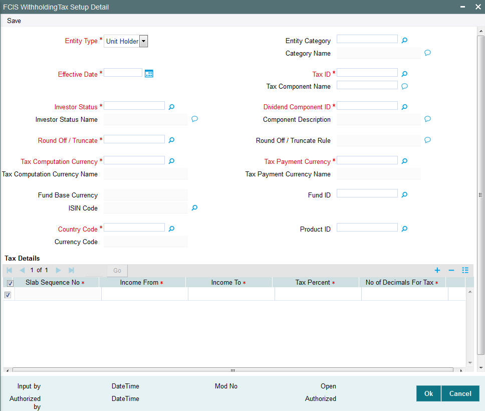

You can configure the system to perform withholding tax (WHT) deductions out of the earnings derived from any investor or a broker. To do this, you must specify the slabs according to which the rates will be determined. WHT is deducted from the earnings of an investor or a broker, according to the WHT slabs that you maintain in the system, before the net earnings are paid out or reinvested depending upon the Income Distributions Setup.
You can maintain such slabs for earnings from cash dividends that involve capital gains as well as income earnings.
In the system, you maintain the slab details for WHT Input in the ‘FCIS Withholding Tax Setup Detail’ screen. You can invoke this screen by typing ‘UTDWHTAX’ in the field at the top right corner of the Application tool bar and clicking on the adjoining arrow button. Select ‘New’ from the Actions menu in the Application tool bar or click new icon to enter the details.
You can use this screen to enter the Withholding Tax component slab details that are applicable:
You can either to choose to set up tax slabs at the fund level or at the product level. Product level WHT applies to all funds available in that product portfolio.
You can also give each set of slabs a separate tax component ID.
You can define slabs for different income ranges and give each of the slabs a sequence number. You cannot, however, set up duplicate tax slab sequences for the same investor category.
Before you set up the Withholding Tax details for an investor category for a country, it is desirable to ensure that the following information is already set up in the system:
Specify the following fields in this screen:
Entity Type
Indicate whether the WHT slabs are being maintained to be applicable to an Unit Holder or a broker.
Entity Category
Alphanumeric
Specify a valid category of the unit holder you need to assign to specified entity type. The adjoining option list displays all valid entity categories maintained. You can select the appropriate one.
If the ‘Entity Type’ is ‘Unitholder’, then maintain ‘Entity Category’ as ‘UH’. If the ‘Entity Type’ is ‘Broker’, then maintain the ‘Entity Category’ as ‘Broker’.
Category Name
Display only
The system displays unit holder’s category name, if the ‘Entity Type’ is maintained as ‘Unitholder’.
Effective Date
DD/MM/YYYY, Numeric, Mandatory
Specify the date the system should consider for calculating tax.
Tax ID
From the list, select the tax ID to be used for application of withholding tax according to the slabs maintained, for the entity type. The system displays the associated Tax Component Name.
Each set of slabs can be given an ID that reflects the nature of the slabs.
The value list for the Tax ID’s is obtained from the system parameter values maintained for the Tax ID system parameter code.
Investor Status
You will be allowed to select the status if the entity type is ‘Unit Holder’. Select the status for which this tax slab is applicable. The system displays the corresponding ‘Investor Status Name’. This will enable the system to decide which tax slab needs to be applied depending on whether the unit holder is a foreign / resident unit holder.
If the entity type is a broker, the system defaults the investor status. You will not be able to modify the status.
Dividend Component ID
Specify whether the tax slab details being maintained apply to capital gains earnings from cash dividends or income earnings from cash dividends, for the fund.
The system defaults the Dividend Component ID and Description for brokers. You will not be able to modify the ID.
Roundoff/Truncate
AlphaNumeric, Mandatory
Indicate whether the decimal portion of the amount should be rounded off or truncated.
Round Off/ Truncate Rule
Indicate the rule which the system should use to round off or truncate the decimal portion of the amount.
Tax Computation Currency
Specify the currency in which the tax must be computed for the selected tax ID. By default, it is reckoned to be the currency of the selected country. You will be allowed to specify the currency only for Unit Holders.
Tax Payment Currency
Specify the currency in which the tax must be paid for the selected tax ID. By default, it is reckoned to be the fund base currency. You will be allowed to specify the currency only for Unit Holders.
Tax Payment Currency Name
Display
The system displays specified tax payment currency name based on the details maintained at ‘Currency Maintenance’ level.
ISIN Code
12 Characters Maximum; Alphanumeric; Mandatory
Select the ISIN Code of the fund for which you are setting up the tax slabs, from the options provided. This is applicable only for Unit Holder type of entity .If you specify the ISIN Code of a fund, the ID of the fund is displayed in the Fund ID field.
Fund Base Currency
Enter the currency in which you would like the fund to be denominated.
Fund ID
Select the fund for which you are setting up the tax slabs. The base currency of the fund is displayed in the Fund Base Currency Code field.
Country Code
When you select the ID of the fund, the country associated with the fund is displayed in this field, and you can change it by choosing from the drop down list.
This is the country for which the tax slabs that are being set up must be applicable. All tax deductions and computations will be done in this currency.
Currency Code
Display Only
Depending on the Country, the system displays the corresponding currency.
Product ID
Select the product for which you are setting up the tax slabs. The option list contains all valid products maintained in the system. With-Holding Tax will be applicable to all funds mapped to the product. GL entries will be populated with the respective product Id and policy number along with the dividend payment details and tax details.
In the lower grid portion of the screen, maintain the details of each slab, as follows:
Slab Sequence No
3 Characters Maximum, Numeric, Mandatory
Enter the slab number for this investor category tax definition.
Income From
Numeric, Mandatory
Specify the minimum income for which this tax slab definition is applicable, for the specified investor category. This slab will apply to incomes that range between the values you specify in this field and the Income To field for the specified investor category.
Income To
Numeric, Mandatory
Specify the maximum income for which this tax slab definition is applicable, for the specified investor category. This slab will apply to incomes that range between the values you specify in this field and the Income From field, for the specified investor category.
Tax Percent
5 Characters Maximum, Numeric, including two decimal places, Mandatory
Enter the Tax Percent that is applicable to the given Investor category in the specified slab. This percentage may be equal to or below one hundred percent, but not greater.
Number of Decimals for Tax
1 Character Maximum, Numeric, Mandatory
Indicate the rounding precision or the number of decimals to be applied on the withholding tax amount pertaining to the slab. The decimal portion of the amount will be rounded off or truncated to the number of decimal places you specify here.
Withholding tax is computed for funds for cash dividend corporate action types only. This is applicable for normal UT investments. Dividend tax can be computed based on the source product and With-Holding Tax maintained for the product. For stock dividends, the TDS Basis maintained in Corporate Actions profile is “Tax-exempt”, and the tax is not computed.
For each tax component, the computation currency and payment currency may be specified as two different currencies, so as to enable payment to be made in the desired currency. By default, when you set up a withholding tax record for a fund, investor category and country combination, the computation currency is deemed to be the currency of the country and the payment currency is deemed to be the fund base currency.

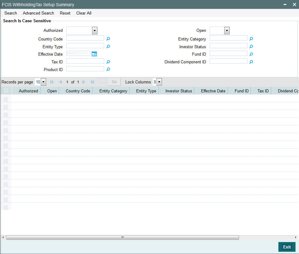

The With-Holding Tax Find screen can be used for the following operations on WHT details:
Invoke the ‘FCIS Withholding Tax Setup Summary’ screen by typing ‘UTSWHTAX’ in the field at the top right corner of the Application tool bar and clicking on the adjoining arrow button.
You can retrieve a previously entered entity in the Summary screen, as follows:
Note
You can also retrieve the individual Withholding Tax record from the detail screen by doing query in the following manner:

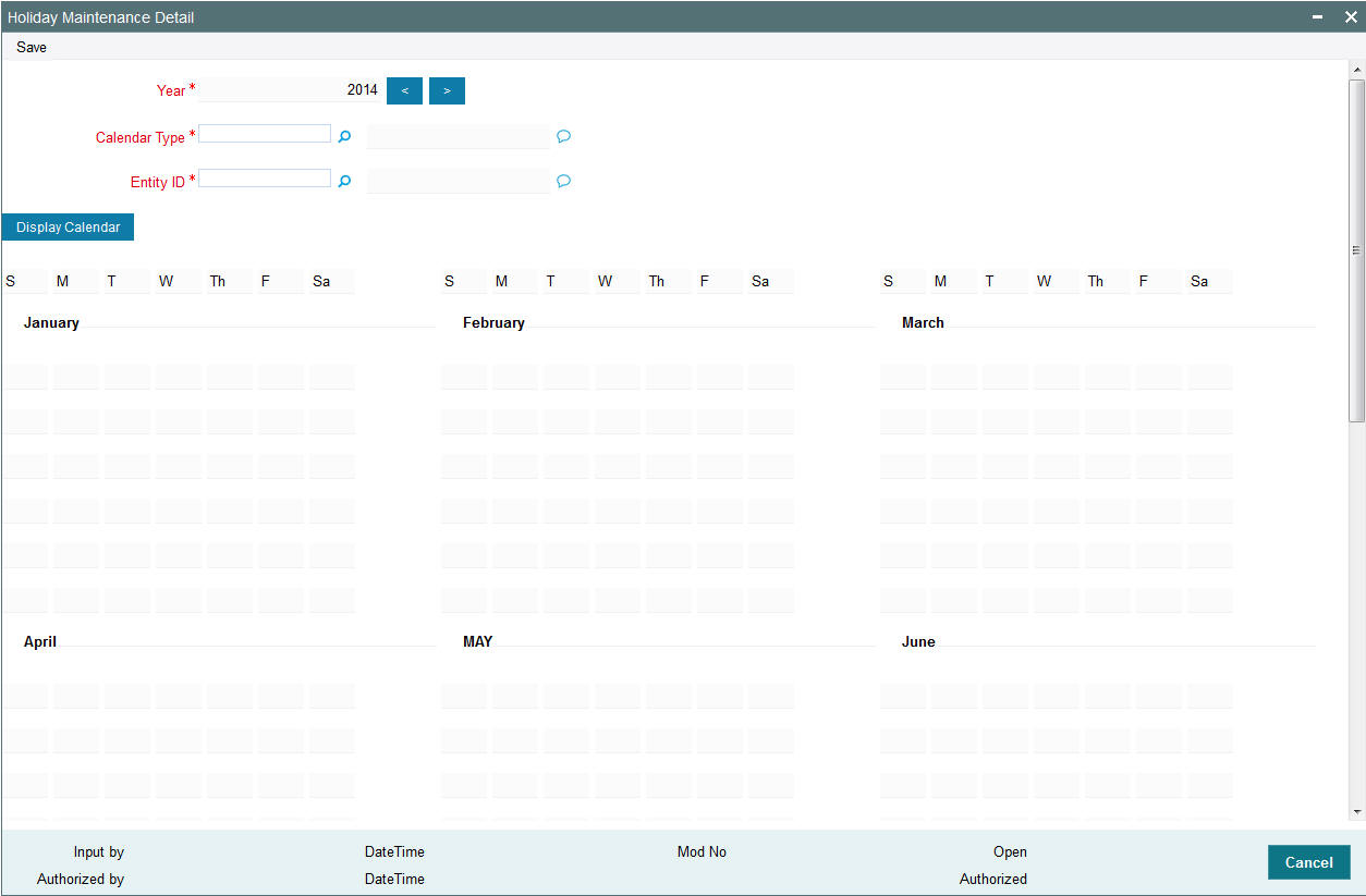

You must define the weekly holidays and yearly holidays in the holiday calendar for each year.
Different AMCs’ could have different holiday calendars. Further, for funds floated by a single AMC across different locations, the holiday calendar for specific funds could be different from the AMC holiday calendar. You may, therefore, need to designate holiday calendars separately for the following entities:
In the system, you designate holidays for any of the above, in the Holiday Maintenance screen. You must first designate the System Calendar, before you designate the other calendars. The system calendar, once designated, is taken to be the default AMC and fund calendar. You can make appropriate changes, if necessary, for each.
Invoke the ‘Holiday Maintenance Detail’ screen by typing ‘UTDHOLID’ in the field at the top right corner of the Application tool bar and clicking on the adjoining arrow button.
You can use this screen to:
On opening this screen, by default the system holiday calendar for the current year, which was set up at the time of installation, with the designated holiday dates checked off against their respective boxes in each month. You can use the Previous and Next links to navigate between years.
Select the day in the calendar and check the box alongside the date to add it to the list of Holidays. Select the day from the list of holidays and uncheck the box alongside it to remove it from the list of Holidays.
Click ‘Ok’ button to save your changes. The changes must be authorized by another user to be effective in the system.
To maintain an AMC holiday calendar, specify ‘AMC’ in the Calendar Type field, and select the AMC for which the calendar is being maintained, in the AMC field. Similarly, to maintain a fund holiday calendar, specify ‘Fund’ in the Calendar Type field, and select the fund for which the calendar is being maintained, in the Fund ID field, and the ISIN Code for the fund in the Fund ISIN field.
To maintain a currency holiday calendar, select the ‘Currency’ option in the Calendar Type field, and select the currency for which the calendar is being maintained in the Currency Code field.

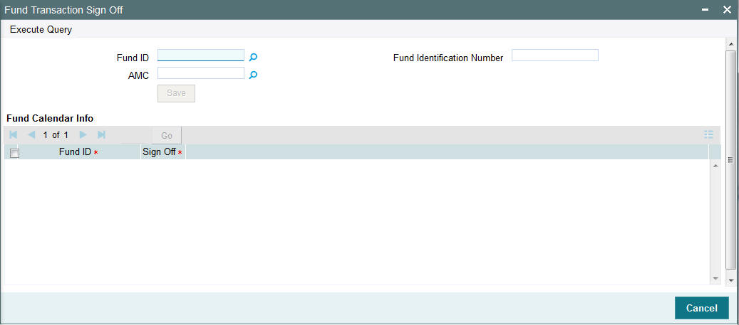

Specifying transaction sign off on a working day
On a working day for the fund, you can signal the end of transaction input on an ad-hoc basis, if necessary. The transaction date of any transaction that is entered after the sign off status has been marked for the day, will be defaulted to the next working day according to the fund calendar (if maintained) or AMC calendar (if maintained) or the system calendar.
You can mark the sign off status in the ‘Fund Transaction Sign Off’ screen. You can invoke this screen by typing ‘UTDTSOFF’ in the field at the top right corner of the Application tool bar and clicking on the adjoining arrow button. Select ‘New’ from the Actions menu in the Application tool bar or click new icon to enter the details.
In this screen, you can specify the Fund ID and Fund Identification Number of the fund for which you are marking the transaction sign off on the current (application) date. You can also specify the AMC to which the fund belongs.

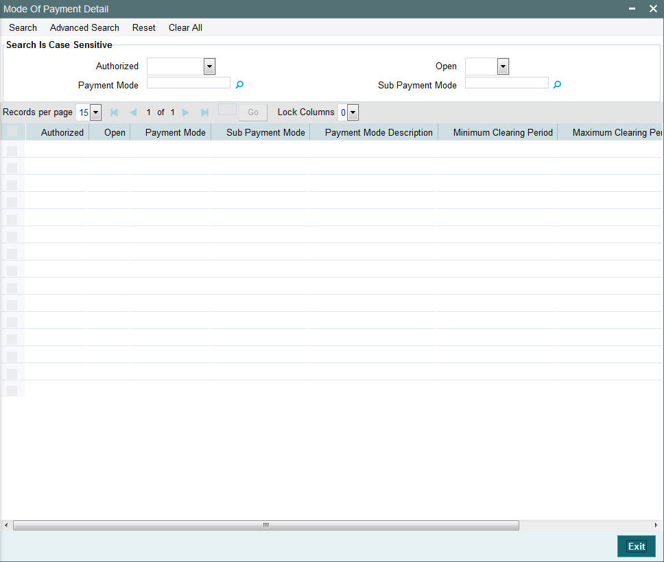

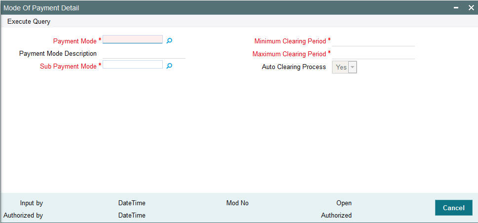

You can use this screen to set up the clearing options for the various modes of payments that are valid in the system. For each mode of payment, you can:
During installation, the modes of payment and the default clearing periods for each mode are entered into the system automatically. Subsequently, if you need to view or make a change to any of the clearing options, you can retrieve the record in this screen by clicking on ‘Ok’ button in this screen. All the clearing options maintained for each of the modes of payment are displayed in the lower portion of the screen.
You can invoke the ‘Mode Of Payment Detail’ screen by typing ‘UTDMPAYS’ in the field at the top right corner of the Application tool bar and clicking on the adjoining arrow button.
Payment Mode
Display Only
The system displays the different modes of payment. The different modes of payments can be Cash, Demand Draft, and Money Transfer and so forth.
Payment Mode Description
Display Only
A description of the mode of payment is displayed here. This could be any of the instruments such as Draft, Check, Transfer, Credit Card, etc.
Sub Payment Mode
Display Only
The code or short name given to any of the payment modes used in the system is displayed here.
Minimum Clearing Period
Numeric, Display (Can be altered)
Specify the number of days after which you will be able to clear the payment instrument for a particular mode of payment. You can alter the value that is displayed here.
For each mode of payment, the Minimum Clearing Period is the period after which you will be able to clear the payment instrument.
Maximum Clearing Period
Specify the number of days before which the payment instrument must be cleared for a particular mode of payment. You can alter the value that is displayed here.
For each mode of payment, the Maximum Clearing Period is the period before which you must clear the payment instrument.
Auto Clearing Process
Display
If you have ticked the check box under Auto Clear, the instrument automatically gets cleared if you do not clear the same before the max clearing period.

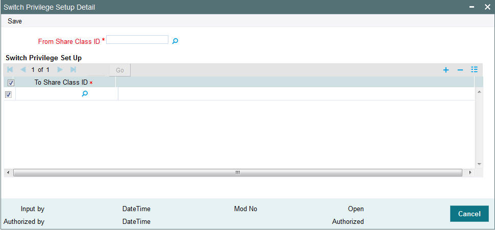

You can set up a restrictive list of switching between share classes for switch transactions, in the ‘Switch Privilege Setup Detail’ screen. You can invoke this screen by typing ‘UTDSWPRV’ in the field at the top right corner of the Application tool bar and clicking on the adjoining arrow button.
After you have set up a restrictive list of switching between share classes for switch transactions, you must have another user authorize it so that it becomes effective in the system.
Before the restrictive list is authorized, you can edit it as many times as necessary. You can also delete it before it is authorized.
After authorization, you can only change the switch period through an amendment.
The ‘Switch Privilege Setup Summary’ screen can be used for the following operations on restrictive (privilege) lists:
Invoke the ‘Switch Privilege Setup Summary’ screen by typing ‘UTSSWPRV’ in the field at the top right corner of the Application tool bar and clicking on the adjoining arrow button.
Note
You can also retrieve an individual record from the Detail screen by doing query in the following manner:-
For example, you can search the record for From Share Class Type ID by using the combination of % and alphanumeric value as follows:-
You can modify the switch privilege setup that you have already entered into the system, provided it has not been subsequently authorized. You can perform this operation as follows:
To view a switch privilege list that you have previously entered:
You can delete only unauthorized switch privilege setup in the system. To delete a switch privileges setup list:
An unauthorized switch privilege setup must be authorized in the system for it to come into effect. To authorize:
When the checker authorizes an entity, details of validations, if any, that were overridden by the maker of the transaction during the Save operation, are displayed. If any of these overrides results in an error, the checker must reject the entity.
After a switch privilege setup is authorized, it can be modified using the Unlock operation from Action list. To make changes to a switch privilege setup after authorization, you must invoke the Unlock operation which is termed as Amend Operation.
An amended switch privilege setup must be authorized for the amendment to be made effective in the system. The process of authorization is subsequently the same as that for normal transactions.
If you want to create a switch privilege having the same attributes of an existing setup, you can copy the attributes of an existing setup to a new setup.

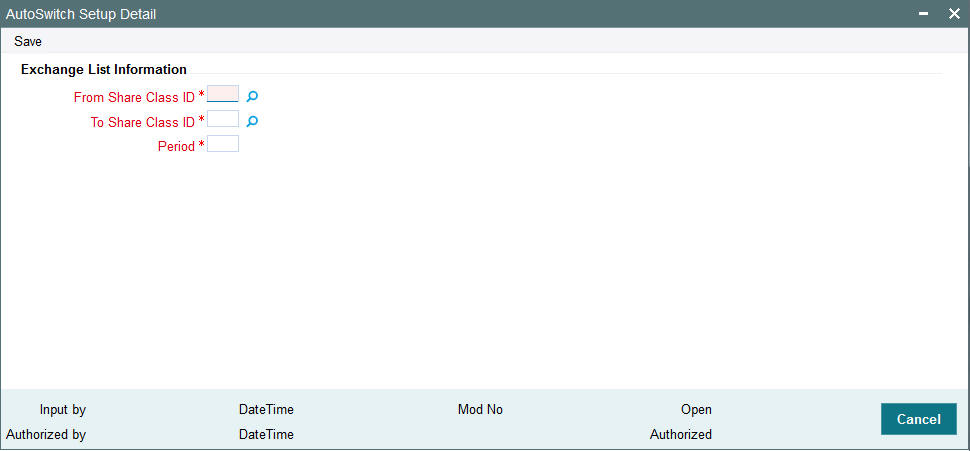

You can define a period for allowing switch transactions between share classes, in the ‘Exchange List Maintenance Detail’ screen. You can invoke this screen by typing ‘UTDASSSD’ in the field at the top right corner of the Application tool bar and clicking on the adjoining arrow button.
Select ‘New’ from the Actions menu in the Application tool bar or click new icon to maintain the list.
After you have designated a period for allowing switch transactions between share classes, you must have another user authorize it so that it becomes effective in the system.
Before the switch period is authorized, you can edit it as many times as necessary. You can also delete it before it is authorized.

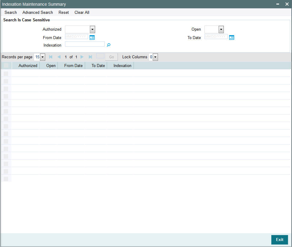

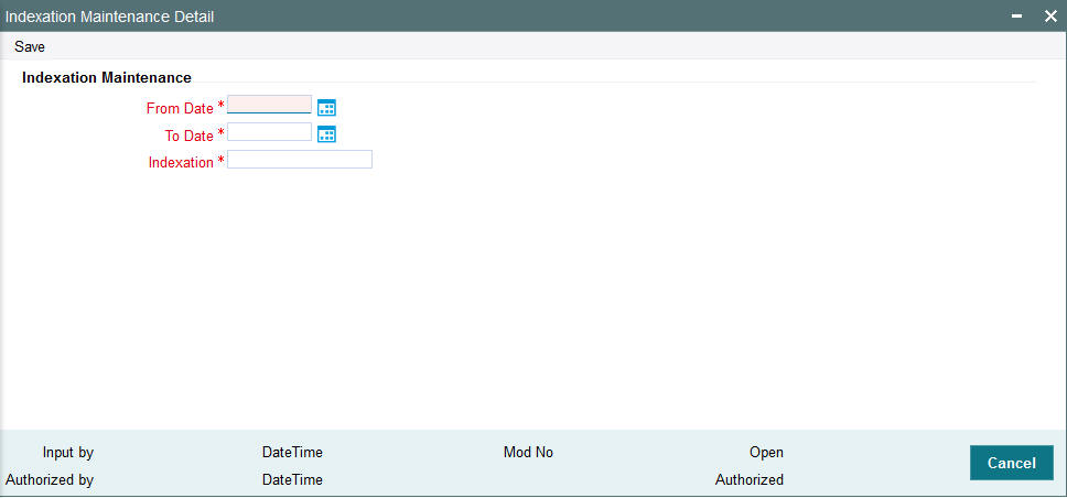

Investors may opt for indexation to be applicable for the computation of income or capital gains on earnings from investments, on which capital gains tax can be applied. You must maintain the indexation values to be applicable for specific periods, which can then be applied for the computation of capital gains income.
You maintain indexation values to be applicable within a specific period bounded by a ‘from’ and a ‘to’ date.
You can use the ‘Indexation Maintenance Detail’ screen to maintain indexation values. You can invoke this screen by typing ‘UTDINDEX’ in the field at the top right corner of the Application tool bar and clicking on the adjoining arrow button. Select ‘New’ from the Actions menu in the Application tool bar or click new icon to maintain the indexation.
You must specify the indexation value to be applicable between two given dates. Any transactions allocated between those two dates, which result in application of capital gains tax with indexation, will use these values for the tax computation.
From Date
Date Format; Mandatory
Specify the date on and following which the indexation value is to be applicable, for computation of capital gains income.
To Date
Specify the date up to which the indexation value is applicable for computation of capital gains income.
Indexation
5 Characters Maximum; (with a maximum of two decimal places) Numeric; Mandatory
Specify the indexation value that is to be applicable between the ‘from’ and ‘to’ dates that you have specified. You cannot specify duplicate indexation values for a period, and for a given range, you can only specify one value.
An indexation value you have specified for a given period must be authorized for it to be effective in the system. You can use the Indexation Summary screen to authorize the value.
You can also perform the following operations on an indexation value record in this screen:
When you amend a value specified for a period, it will come into effect when another user authorizes the amendment.
You can invoke the ‘Indexation Maintenance Summary’ screen by typing ‘UTSINDEX’ in the field at the top right corner of the Application tool bar and clicking on the adjoining arrow button.
Note
For example, you can search the record for Indexations ID by using the combination of % and numeric value as follows:-
You can modify the indexation parameters that you have already entered into the system, provided it has not been subsequently authorized. You can perform this operation as follows:
To view an indexation list record that you have previously entered:
An unauthorized indexation must be authorized in the system for it to come into effect. To authorize:
When the checker authorizes an entity, details of validations, if any, that were overridden by the maker of the transaction during the Save operation, are displayed. If any of these overrides results in an error, the checker must reject the indexation.
After an indexation is authorized, it can be modified using the Unlock operation from Action list. To make changes to an indexation after authorization, you must invoke the Unlock operation which is termed as Amend Operation.
An amended exchange list must be authorized for the amendment to be made effective in the system. The process of authorization is subsequently the same as that for normal transactions.
If you want to create an indexation having the same attributes of an existing indexation, you can copy the attributes of an existing indexation to a new indexation.

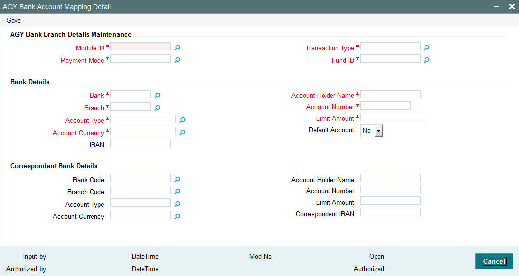

In the ‘AGY Bank A/C Mapping Detail’ screen, you can maintain collection center accounts for a combination of:
This would mean that you could maintain collection centers for each agency branch, to receive payments through any mode, from unit holders for subscriptions or IPO transactions into each fund.
Use the ‘AGY Bank A/C Mapping Detail’ screen to designate the collection centers and payout accounts. You can invoke this screen by typing ‘UTDAGYBN’ in the field at the top right corner of the Application tool bar and clicking on the adjoining arrow button.
For each collection center account, you need to specify the following information in the ‘AGY Bank A/C Mapping Detail’ screen:
You must maintain at least one default collection center account.
In the AGY Bank A/C Mapping Details Maintenance screen, you can maintain payout accounts for a combination of:
This would mean that you could maintain payout accounts for each agency branch, to direct payments to unit holders through any mode, for outflow transactions from each fund.
For each payout account, you need to specify the following information in the AGY Bank Branch Details screen:
To maintain correspondent bank details, click on the Details button. The Correspondent Bank Details Section screen is opened, where you can specify the details. You maintain the same details as for a payout account, with a limit amount.
Module ID
Select the module (agency branch) for which you are designating the collection center or payout account in this screen.
Transaction Type
Select the type of outflow transaction for which you are designating the payout account, or the type of inflow transaction for which you are designating a collection center, in this screen.
Payment Mode
Specify the mode of payment for which the collection center is applicable, for the selected module and transaction type. For redemption transactions, the payment mode is not applicable.
Fund ID
Specify the fund for which the collection center or payout account is applicable, for the selected module, transaction type and payment mode.
Bank
9 Characters Maximum; Alphanumeric; Mandatory
Specify the code of the bank that is being designated as a collection center or a payout bank. The collection account or the payout account must reside in this bank.
Branch
Specify the code of the branch of the bank that is being designated as a collection center or a payout bank. The collection account or the payout account must reside in this branch of the selected bank.
Account Type
Specify the type of the collection or payout account.
Account Currency
Specify the currency of the collection or payout account.
Account Number
Specify the number of the collection or payout account.
Account Holder Name
Specify the name of the owner of the collection or payout account.
Limit Amount
Numeric; Mandatory
Specify the value of the limit placed on payouts to the payout account. If the value of the payment exceeds this value, a demand draft payment must be made. For payments below this value, check payments may be made.
Default Account
Optional
You can use this field to indicate whether the specified account is deemed to be the default collection or payout account for the selected module, transaction type, payment mode and fund combination. Select this box to indicate that it is the default account, or leave it unselected to indicate that it is one of the other accounts.
IBAN
Bank Code
Specify the code of the bank that is being designated as a correspondent bank for the collection center or a payout bank. The correspondent collection account or the payout account must reside in this bank.
Branch Code
Specify the code of the branch of the bank that is being designated as a correspondent bank for collection center or a payout bank. The correspondent collection account or the payout account must reside in this branch of the selected bank.
Account Type
Specify the type of the correspondent collection or payout account.
Account Currency
Specify the currency of the correspondent collection or payout account.
Account Number
Specify the number of the correspondent collection or payout account.
Account Holder Name
Specify the name of the owner of the correspondent collection or payout account.
Limit Amount
Numeric; Mandatory
Specify the value of the limit placed on payouts to the correspondent payout account. If the value of the payment exceeds this value, a demand draft payment must be made. For payments below this value, check payments may be made.
Correspondent IBAN

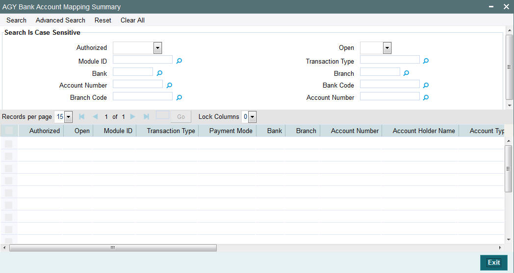

You can invoke the ‘AGY Bank A/C Mapping Summary’ screen by typing ‘UTSAGYBN’ in the field at the top right corner of the Application tool bar and clicking on the adjoining arrow button.
You can perform the following operations from this screen:
You can retrieve a previously entered record in the Summary Screen, as follows:
Click 'Search' to view the records. All the records with the specified details are retrieved and displayed in the lower portion of the screen.

You can modify the details of a AGY Bank A/C Mapping record that you have already entered into the system, provided it has not subsequently authorized. You can perform this operation as follows:
To view a record that you have previously input, you must retrieve the same in the AGY Bank A/C Mapping Summary screen as follows:
1. Invoke the Agency Branch A/O Summary screen from the Browser.
2. Select the status of the record that you want to retrieve for deletion.
3. Specify any or all of the details in the corresponding fields on the screen.
4. Click ‘Search’. All records with the specified fields are retrieved and displayed in the lower portion of the screen.
5. Double click the record that you want to delete in the list of displayed records. The Agency Branch A/O Detail screen is displayed.
6. Select Delete Operation from the Action list. The system prompts you to confirm the deletion and the record is physically deleted from the system database.
An unauthorized AGY Bank A/C Mapping record must be authorized in the system for it to be processed. To authorize a record:
When a checker authorizes a record, details of validation, if any, that were overridden by the maker of the record during the Save operation are displayed. If any of these overrides results in an error, the checker must reject the record.
After a AGY Bank A/C Mapping record is authorized, it can be modified using the Unlock operation from the Action List. To make changes to a record after authorization:
An amended AGY Bank A/C Mapping record must be authorized for the amendment to be made effective in the system. The authorization of amended records can be done only from Fund Manager Module and Agency Branch module.
The subsequent process of authorization is the same as that for normal transactions.
If you want to create an AGY Bank A/C Mapping record having the same attributes of an existing AGY Bank A/C Mapping record, you can copy the attributes of an existing AGY Bank A/C Mapping record to a AGY Bank A/C Mapping record.

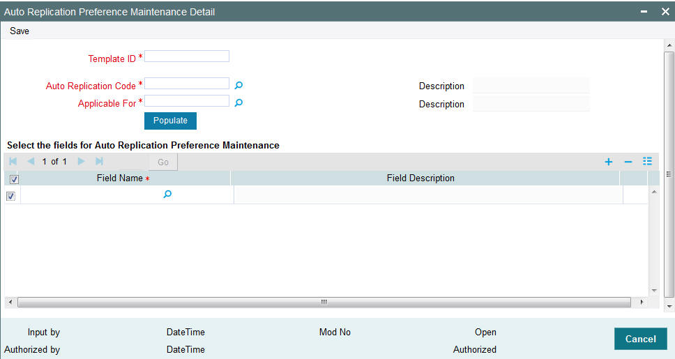

You can maintain a template that contains the fields in the Unit Holder New Account Maintenance, for which you require replication of any modifications that are made through an Information Change. The templates can be maintained at two levels – CIF level and Identification Type level.
To maintain the templates, use the ‘Auto Replication Preference Maintenance Detail’ screen. You can invoke this screen by typing ‘UTDAUTRE’ in the field at the top right corner of the Application tool bar and clicking on the adjoining arrow button.
In this screen, you must maintain the following details to maintain the template:
Alphanumeric; 6 Characters Maximum, Mandatory
Specify a unique identification for the automatic replication template being maintained.
Auto Replication Code
This field indicates the type of entity for which the automatic replication template preferences are being maintained. The entity types for which the automatic replication feature is available are pre-configured for your installation. The Unit Holder Information Change and Broker Info Change options are displayed in this field and cannot be changed. The appropriate description is displayed in the Description field.
Applicable For
Specify the level at which the automatic replication of changes made through Information Change is required – either CIF level or Identification Type level. Depending upon your choice, CIF-relevant fields or Identification Type fields are available for selection for automatic replication.
Note
If you select auto replication code as ‘BROKERINFOCHANGE’ and applicable for option as B-Broker and click on Populate button, the system displays the list of all available fields for creating a template.
Field Name and Field Description
Select the fields in the Unit Holder New Account maintenance, changes to which are to be replicated to all accounts under a CIF. You can choose either CIF-relevant fields, or fields pertaining to Identification Type, depending on the level at which the automatic replication is required, which you have selected in the Applicable For field.
The list of fields for which the automatic replication feature is available is pre-configured for your installation.
You can perform the following operations on a template for automatic replication:
Note
During edit or amend operations, the template ID cannot be changed. Only the fields tagged to the template, are allowed to be changed.

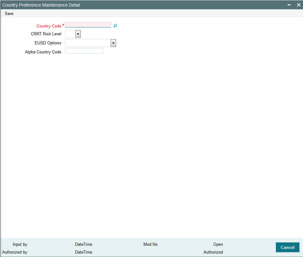

Before you associate any attribute with a country, it is desirable to ensure that the following information is already setup in the system:
Country Code
Select the country for which you wish to define preferences.
CRRT Risk Level
Optional
Specify the CRRT i.e. the Country Reputation Risk Table associated with the country. The reputation risk level may either be ‘High’ or ‘Low’. High implies that it is a high risk country while Low indicates cautionary risk country.
While creating a unit holder, if the unit holder domicile country is listed in the CRRT list, then system throws up an error depending on the country risk level.
EUSD Options
Optional
You need to associate a EUSD (European Union Savings Directive) option with each country. Based upon unit holder’s country of domicile, the corresponding EUSD option of that country will get defaulted during unit holder creation.
Alpha Country Code
Maximum 2 characters - Alphanumeric, Optional
You can assign a two character alpha code for the country.
After you have defined the preferences of a country, you must have another user authorize it so that it would be effective in the system.
Before the record is authorized, you can edit it as many times as necessary. You can also delete it before it is authorized.
After authorization, you can only make changes to the record through an amendment.
After you have set up the country preferences, you must have another user authorize it so that it would be effective in the system. Country preferences for an unauthorized record will not be used in the system

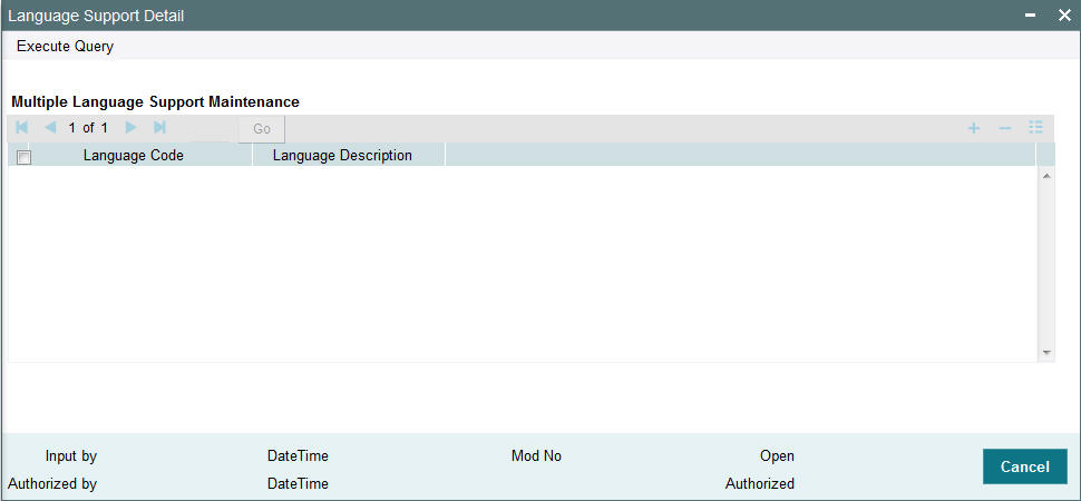

FCIS provides the facility to maintain multiple languages in the system. You may select different languages at the time of installation. However, you may select additional languages at a later stage. Existing Information entered in the default language gets copied to all the languages selected.
The ‘Multiple Language Support Maintenance’ screen allows you to select languages in which information is stored in the system apart from the default English language.
A list of factory shipped languages is provided. You may select the language codes that the system should support. You can capture information such as the currency name, fund name, etc. in the languages chosen in this screen.
The Multiple Language Support Maintenance screen can be used for the following operations on multiple languages:
You can invoke the ‘Language Support Detail’ screen by typing ‘UTDLNGSU’ in the field at the top right corner of the Application tool bar and clicking on the adjoining arrow button. The following screen is invoked.
Specify the following language support details:
Language Code
Specify the code of the language. The adjoining option list displays valid language codes maintained in the system. You can select the appropriate one.
Language Description
Display
Upon selection of the language code, the system displays the description of the specified language code.

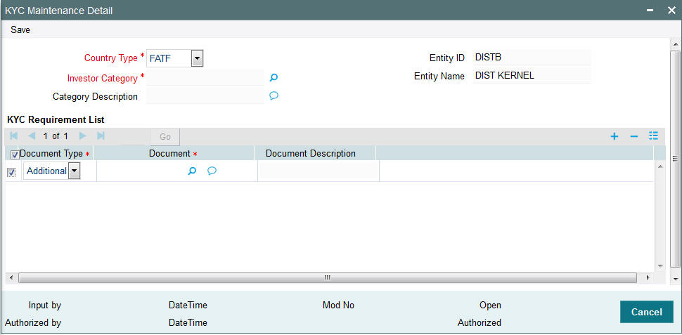

Use the ‘KYC Maintenance Detail’ screen to maintain the standard and additional lists of documents. You can invoke this screen by typing ‘UTDKYCMT’ in the field at the top right corner of the Application tool bar and clicking on the adjoining arrow button. Select ‘New’ from the Actions menu in the Application tool bar or click new icon to enter the KYC details.
The following screen is invoked:
The ID of the entity assigned to the agent and its corresponding description are shown when you invoke the screen.
You can specify the following fields in this screen:
You need to set up the following parameters:
Country Type
In FC-IS, countries are categorized into two types; FATF (Financial Action Task Force) and Non – FATF. FATF is an inter-governmental body for developing and promoting policies to combat money laundering.
Select FATF if you wish to maintain list of required KYC documents for investor account residing in a FATF country. Else, select Non - FATF.
Investor Category
Select the category of investor for whom the list of required KYC documents is to be set up, from the drop-down list.
Entity ID
Display Only
The system defaults the Entity ID linked to the selected country type.
Entity Name
Display Only
The system defaults the corresponding name of the defaulted entity here.
Document Type
You can either classify documents as Standard or as Additional. Documents marked as Standard will be marked as ‘Requested’ at the time of unit holder creation by default.
Requirement
Select this option to mark the selected document for deletion.

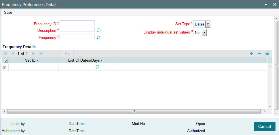

FCIS allows you to meet the following requirements related to rules for systematic plans:
The multiple frequencies provided for SI at Fund level are as mentioned below:
Frequency |
Available values for each frequency |
Explanation |
Weekly (A) |
1,8,15,22 2,10,20,28 3,6,16,27 4,7,18,29 5,10,15,20 |
You need to select any 4 dates from 1 to 31. There would be 5 such sets of dates at fund level. While capturing SI, you can select any of the sets available at the fund level and map it to the unitholder. |
Weekly (B) |
Sun/Mon/Tue/ Wed/Thu/Fri/Sat |
At the fund rules level, there are a set of values from Sunday to Saturday. Fund would map any day(s) as applicable. While capturing SI, you would be able to select any day from the set available at Fund level. |
Fortnightly |
1,22 2,28 3,27 4,29 5,20 |
You can select any 2 dates from 1 to 31. There would be 5 such sets of dates at fund level. While capturing SI, you can select any of the sets available at Fund level. |

The ‘Frequency Preferences Detail’ screen can be used to define setup of dates / days that can be used for mapping in Fund rules and Standing Instructions.
You can invoke this screen by typing ‘UTDFRQPR’ in the field at the top right corner of the Application tool bar and clicking on the adjoining arrow button. Select ‘New’ from the Actions menu in the Application tool bar or click new icon to enter the frequency preference details.
This section allows you to capture the following information
Freq. ID
10 Character Maximum, Alphanumeric, Mandatory
Enter a unique ID for the setup.
Description
255 Character Maximum, Alphanumeric, Mandatory
Specify the description of the setup.
Frequency
Mandatory
This drop down list displays the list of available frequencies, which are:
Set Type
Mandatory
This is applicable only if frequency selected is Weekly. The Applicable values being
For other frequencies, it would be defaulted to Dates and you will not be allowed to change it.
Display individual set values
If you check this option you can enter the set of options in the SET ID field, however if this is unchecked individual values in SI capture. For example, in case the frequency is fortnightly, the SI screen should display the set values as
Where as for weekly frequency by days, the values should be displayed individually for a set which would be (Mon/Thu/Fri) and thus this check box would be unchecked.
Set ID
Specify the unique ID for this set depending on the frequency specified.
Note
If Set ID is already mapped to the SI, you cannot delete the same during amendment. This will be checked by looking at the funds that are mapped to the Freq. ID for which SI has been setup for a particular Set ID
List Of Dates/Days
Specify the dates or days based on the ‘Set Type’.
Note
If the client country parameter is set to “SIRULEATFREQ” for your bank please refer to Annex_A.doc for further details.

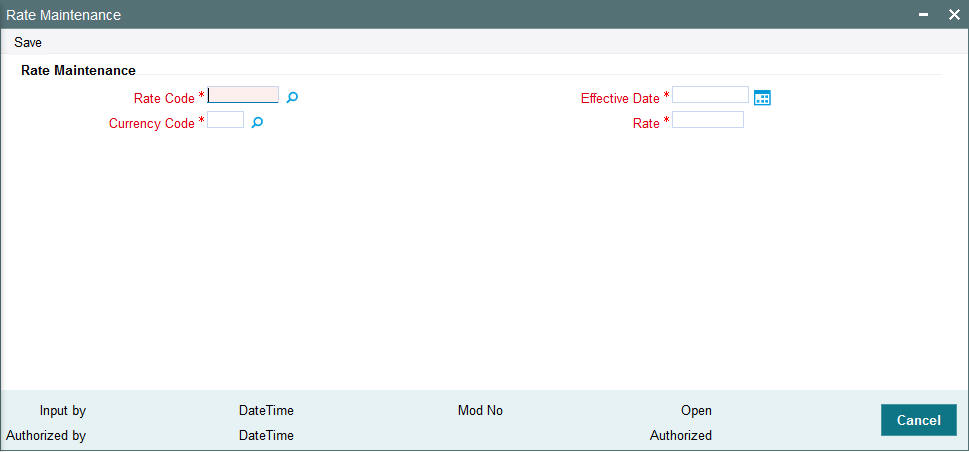

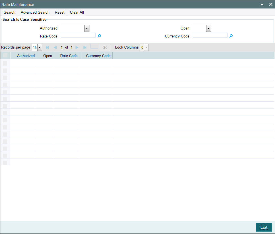

You can maintain the interest rate details for hedge funds in ‘Rate Maintenance’ screen. You can invoke this screen by typing ‘UTDRATES’ in the field at the top right corner of the Application tool bar and clicking on the adjoining arrow button.
Rate Code
Specify the rate code applicable for hedge fund or select the rate code from the option list provided. All rate codes maintained for the system parameter ‘RATECODE’ get displayed in the option list.
Currency Code
Specify currency code related to the hedge fund or select the same from the option list provided. All valid currency codes maintained in the system get displayed in the option list.
Effective Date
Date, Mandatory
Specify the date on which the selected rate code becomes effective in the system. You can select the date by clicking the ‘Calendar’ icon provided.
Rate
Numeric, Mandatory
Specify the interest rate to be applied for hedge funds. The rate specified here becomes effective on the ‘Effective Date’ indicated previously.
You can perform the following operations on an interest rate record.
You can invoke the ‘Rate Maintenance Summary’ screen by typing ‘UTSRATES’ in the field at the top right corner of the Application tool bar and clicking on the adjoining arrow button.
You can perform the following operations in this screen:
To view a record that you have previously input, you must retrieve the same in the Rate Maintenance Summary screen as follows:
You can modify the details of a Rate Maintenance record that you have already entered into the system, provided it has not been subsequently authorized. You can perform this operation as follows:
An unauthorized Rate Maintenance record must be authorized in the system for it to be processed. To authorize a record:
After a Rate Maintenance record is authorized, it can be modified using the Unlock operation from the Action List. To make changes to a record after authorization:
Invoke the Rate Maintenance Summary screen from the Browser.

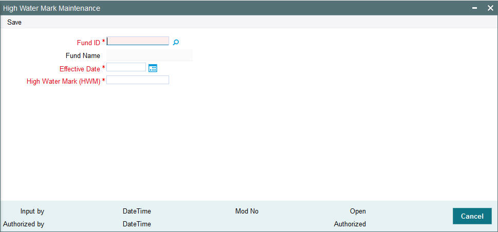

You can maintain the details related high water mark for a fund in ‘High Water Mark Maintenance’ screen. You can invoke this screen by typing ‘UTDHWM’ in the field at the top right corner of the Application tool bar and clicking the adjoining arrow button.
Fund ID
Specify the fund Id for which you wish to maintain high water mark or select the fund Id from the option list provided.
Fund Name
The name of the selected fund gets displayed here.
Effective Date
Date, Mandatory
Specify the date on which the high water mark value becomes effective for the fund. You can also select the date by clicking the ‘Calendar’ icon provided.
High Water Mark
Numeric, Mandatory
Specify the high water mark value for the selected fund, beyond which if the fund value increases, the performance fee gets collected. You need to capture this value only for the first valuation period for the fund. For subsequent periods, the system will automatically populate the highest net asset value previously achieved by the fund.
You can perform the following operations on a high water mark record.
You can invoke the ‘High Water Mark Summary’ screen by typing ‘UTSHWM’ in the field at the top right corner of the Application tool bar and clicking on the adjoining arrow button.
To view a record that you have previously input, you must retrieve the same in the High Water Mark Summary screen as follows:
You can modify the details of a High Water Mark record that you have already entered into the system, provided it has not been subsequently authorized. You can perform this operation as follows:
An unauthorized High Water Mark record must be authorized in the system for it to be processed. To authorize a record:
After a High Water Mark record is authorized, it can be modified using the Unlock operation from the Action List. You will not be allowed to amend the record if fund price is maintained for the day later than or equal to HWM effective date.

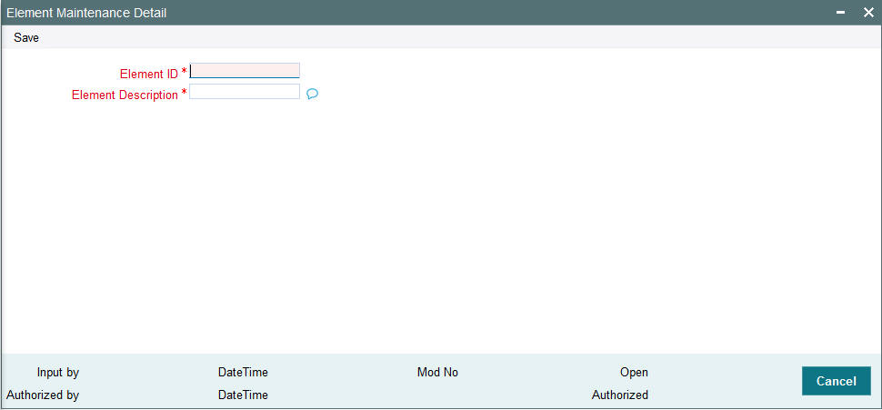

You can capture the details related to derived data elements in ‘Element Maintenance’ screen.
You can invoke this screen by typing ‘UTDENMNT’ in the field at the top right corner of the Application tool bar and clicking the adjoining arrow button.
Element ID
Specify a unique code to identify the data element.
Element Description
Specify a suitable description for the element.

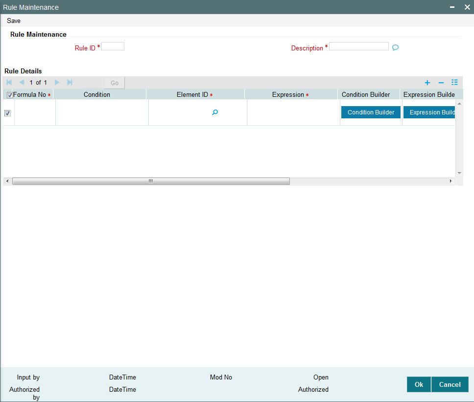

You can maintain the formulas and expressions used to set up the rule for performance fee calculation in ‘Rule Maintenance’ screen. The derived and non derived data elements are used to create expressions and formula while setting up the rules.
You can invoke ‘Rule Maintenance’ screen by typing ‘UTDHDRUL’ in the field at the top right corner of the Application tool bar and clicking the adjoining arrow button.
Rule ID
Numeric, Mandatory
Specify a unique code to identify the performance fee calculation rule.
Rule Description
Specify a suitable description for the rule.
Formula No
Numeric, Mandatory
Specify the line number associated with the rule.
Condition
Click ‘Condition Builder’ to specify the condition to be associated with the rule. The condition specified in the ‘Condition Builder’ screen is displayed here.
Element ID

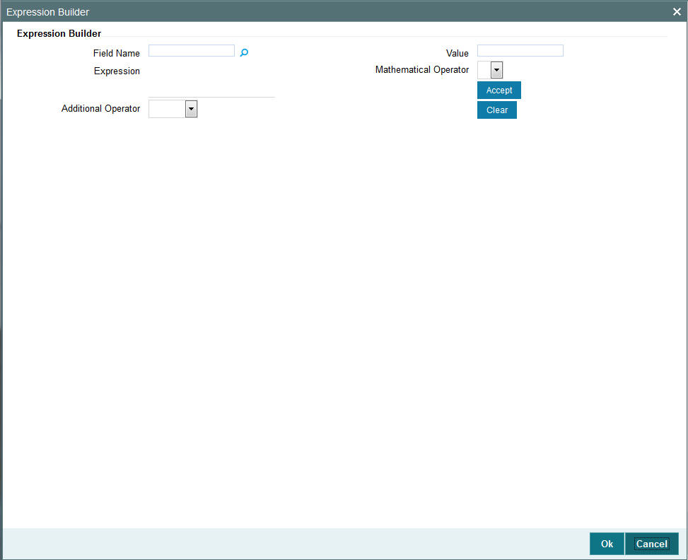

The result obtained from the ‘Expression Builder’ screen is displayed here.
Expression
Click ‘Expression Builder’ to specify the expression to be used to derive the performance fee. The condition specified in the ‘Expression Builder’ screen is displayed here.
Rounding Basis
Optional
Select the basis for rounding from the options provided in the drop-down list. The following options are provided:
Rounding Option
Optional
Select the rounding options from the drop-down list. The following options are provided:
No of Decimals
Numeric, Optional
Specify the number of decimals to be applied during rounding.

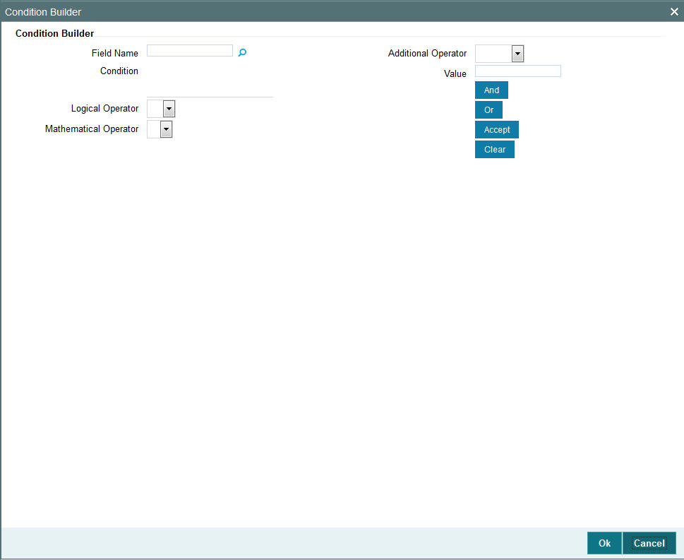

Click ‘Condition Builder’ to invoke the ‘Condition Builder’ screen where you can specify the condition to be checked for performance fee calculation.
You can specify the following details in this screen:
Field Name
Specify the data element to be used to derive the condition for the rule or select the element Id from the option list provided.
Logical Operator
Mandatory
Select the logical operator to be used to derive the condition for the rule from the drop-down list provided.
Mathematical Operator
Mandatory
Select the mathematical operator to be used to derive the condition for the rule from the drop-down list provided.
You can use the ‘And’ or ‘Or’ button to join the conditions, if required.
Click ‘Accept’ to add to the existing value in the condition and click ‘Clear’ to clear the condition.
You can specify the expression to be evaluated to derive the performance fee in the ‘Expression Builder’ screen. Click ‘Expression Builder’ in ‘Rule Maintenance’ screen to invoke the ‘Expression Builder’ screen.
In this screen, you can specify the expression to derive performance fee in the same manner as condition builder. The result obtained from the ‘Expression Builder’ screen gets displayed at the ‘Element Id’ field.
If the system encounters predefined factory shipped elements like RED_AMT, SUB_AMT, RED_UNITS or SUB_UNITS as expression element, then the system generates the transactions as indicated below.
For outflow transactions, the elements ‘PF_VAL’ and ‘CL_VAL’ are used for the performance fee calculation.

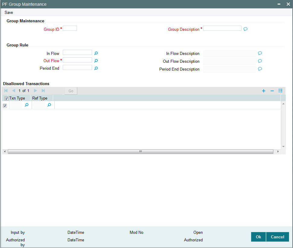

You can define a Group ID and map the default Rule Ids for a given event like Inflow, Outflow or Period End in ‘PF Group Maintenance’ screen.
You can invoke ‘PF Group Maintenance’ screen by typing ‘UTDHRGMP’ in the field at the top right corner of the Application tool bar and clicking the adjoining arrow button.
Group ID
Specify a group Id for mapping the rules or select a group Id from the option list provided.
Group Description
Specify a suitable description for the group.
Inflow Rule
Specify the default rule to be used for inflows for the given group Id. You can also select the rule Id from the option list provided.
Outflow Rule
Specify the default rule to be used for outflows for the given group Id. You can also select the rule Id from the option list provided.
Period End Rule
Specify the default rule to be used for period end for the given group Id. You can also select the rule Id from the option list provided.
In this section you can indicate if you wish to disallow any transaction based on the transaction type and reference type.
For e.g., If you map Rule ID ‘001’ to the event ‘Inflow’ and choose to disallow this rule for transaction type ‘02’ (subscription transaction) and if the reference type is ‘RE’ (Reinvestment), then during processing the system will not apply this rule for reinvestment transactions generated as a result of dividend processing.
Disallowed transaction type is applicable for all the rules maintained for the group.
Transaction Type
Optional
Specify the transaction type for which you wish to disallow the transaction or select the transaction type from the option list provided.
Reference Type
Optional
Specify the transaction reference type for which you wish to disallow the transaction or select the reference type from the option list provided.
You can perform the following operations of a group-rule mapping record.

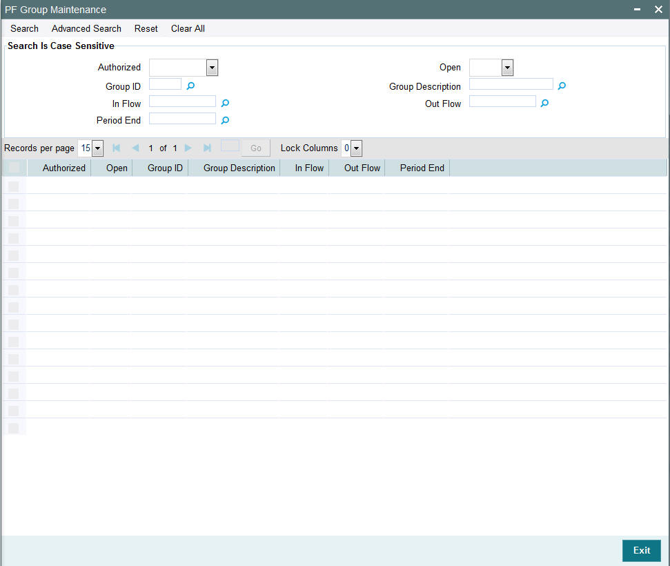

You can invoke the ‘PF Group Maintenance Summary’ screen by typing ‘UTSHRGMP’ in the field at the top right corner of the Application tool bar and clicking on the adjoining arrow button.
To view a record that you have previously input, you must retrieve the same in the Group Maintenance Summary screen as follows:
You can modify the details of a Group Maintenance record that you have already entered into the system, provided it has not been subsequently authorized. You can perform this operation as follows:
An unauthorized Group Maintenance must be authorized in the system for it to be processed. To authorize a record:

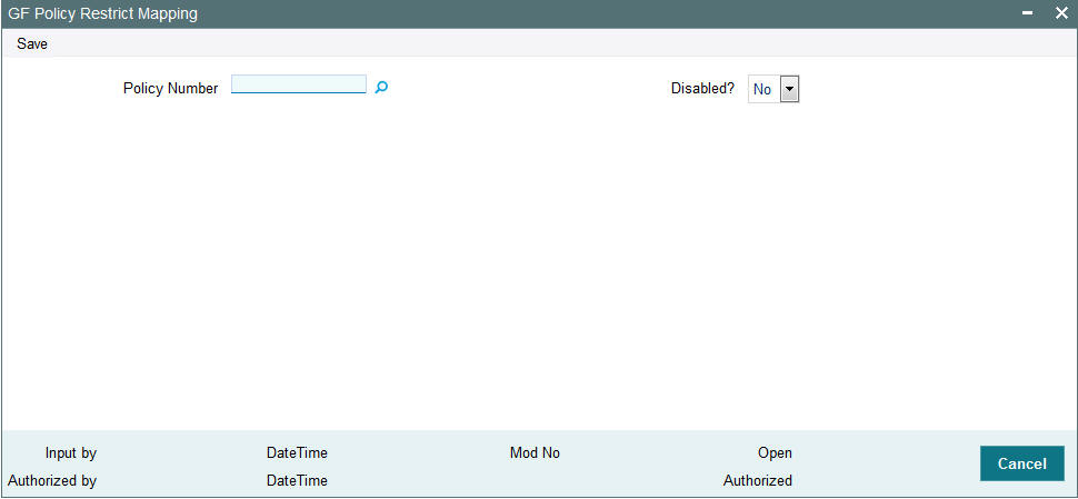

You can maintain a list of policies that you wish to either include or exclude for GF Correction run. You can do this by enabling (disabling to exclude) the policies in the ‘GF Policy Restrict Mapping‘ screen.
You can invoke this screen by typing ‘UTDGFPLR’ in the field at the top right corner of the Application tool bar and clicking the adjoining arrow button
Policy Number
Mandatory
Specify the policy for which you wish to indicate the correction run preferences. You can also select the policy number from the option list provided.
Disabled?
Optional
Select the option to indicate whether you wish to enable or disable correction run for the policy number specified.
You can indicate your preferences for both Simulation run and Final run. For any GF Correction run, the system considers only those policies which have this option enabled.
