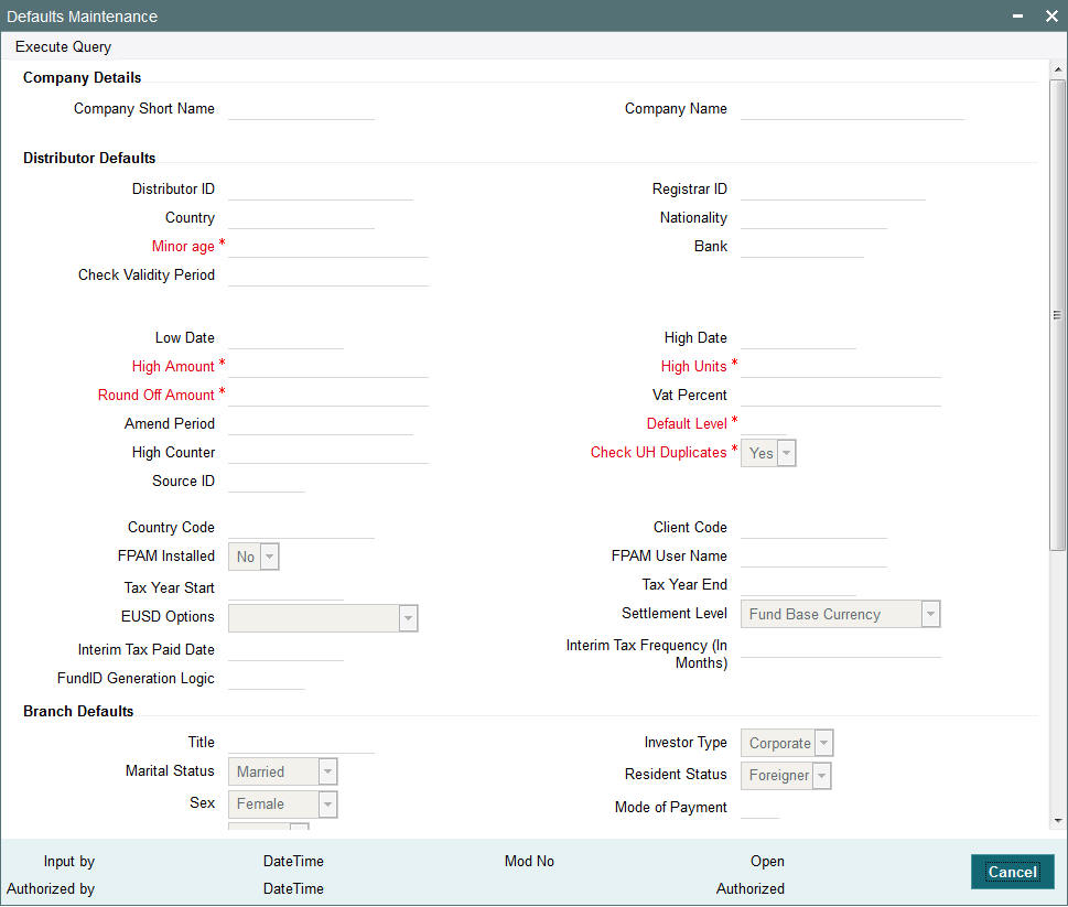

To set up system default information, use the ‘Defaults Maintenance’ screen. You can invoke this screen by typing ‘UTDDEFMT’ in the field at the top right corner of the Application tool bar and clicking on the adjoining arrow button..
In this screen press F7/F8 to query the data. You need to unlock and then modify the data if required.
Company Name
60 Character Maximum, Alphanumeric, Mandatory
Enter the full name of the Company that is using Oracle FLEXCUBE Investor Servicing. The system will print this as the company name in all the reports.
Company Short Name
10 Character Maximum, Alphanumeric, Mandatory
Enter the short name of the Company that is using Oracle FLEXCUBE Investor Servicing.
In this section, define the default information applicable for the AMC, in any maintenance operation in the system.
Distributor ID
6 Character Maximum, Alphanumeric, Mandatory
Enter the ID of the default distributor for the installation.
Registrar ID
Enter the ID of the default Registrar for the installation.
Nationality
15 Character Maximum, Alphanumeric, Mandatory
Enter the default Nationality of the unit holder.
Country
20 Character Maximum, Alphanumeric, Mandatory
Enter the default Country of the unit holder.
Minor Age
Numeric, Mandatory
Enter the default age limit for the Minors.
Bank
Numeric, Mandatory
Enter the code of the default Bank for the system.
Check Validity Period
Numeric, Mandatory
Enter the number of days for which a Check is valid, by default during transactions.
Low Date
Date, Mandatory
Enter the default Low date value for the system.
High Date
Date, Mandatory
Enter the default High Date Value for the system.
High Amount
Currency, Mandatory
Enter the default high amount value.
High Units
Numeric, Mandatory
Enter the default high unit value.
Round Off Amount
Currency, Mandatory
Enter the default value for round off amount.
VAT Percent
Displays the default value of Value Added Tax (VAT) Percentage.
Amend Period
Numeric, Mandatory
Enter the default Amendment period for the Fund Rule/Transactions.
Default Level
2 Characters Maximum, Numeric, Display
This displays the hierarchy default number in the fund. For example, if the existing fund has a parent fund, then the default level will be ‘2’.
High Counter
Numeric, Mandatory
Enter the default high counter value.
Check UH Duplicates
1 Character Maximum, Boolean, Mandatory
Select Yes or No to check for unit holder Duplicates.
Source ID
From the list, select the default exchange rate source for the AMC.
Country Code
15 Characters Maximum, Alphanumeric, Optional
Displays the code given to the country where the client site is located.
Client Code
Displays the code given to the client where Oracle FLEXCUBE Investor Servicing has been installed.
FPAM Installed
If Oracle FLEXCUBE Asset Management has been installed at the client site, it is indicated here.
FPAM User Name
The name of the user where Oracle FLEXCUBE Asset Management has been installed is displayed here.
Tax Year Start
Date Format, Optional
Specify the start date from which the tax payment should be considered.
Tax Year End
Specify the date till which the tax payment should be considered.
EUSD Option
Select the default EUSD (European Union Savings Directive) option for the segment. The options available are:
By default, the option is left unchecked. If you do not indicate any EUSD option, then EUSD option will not be applicable for the segment.
Note
This functionality is applicable only for the Fund Manager module.
Settlement Level
Mandatory
Indicate whether the payment amount must be compared with the fund base currency amount or the transaction currency amount while processing transaction settlements.
Interim Tax Paid Date
Date, Format (DD/MM/YYYY)
Specify the tax payment date here. This is only applicable for non-pensions funds.
Note
It is mandatory to specify the interim tax for funds where IOF/IRRF is applicable.
Interim Tax Frequency
Numeric
Specify the tax payment frequency here. This is only applicable for non-pensions funds.
Note
It is mandatory to specify the interim tax frequency for funds where IOF/IRRF is applicable.
Fund ID Generation Logic
6 Characters Maximum, Optional
Indicate the pattern using which the fund ID needs to be generated, where the first two characters represent the ISO Country Code (except for any jurisdiction with distributor schemas where the 2nd character will designate whether it is "R"egistrar-world or "D"istributor-world) and the following four characters are auto generated numerals.
In this section, define the default information applicable for any branch of the AMC, in any maintenance operation in the system.
Title
Enter the Title to default during unit holder Data Entry. You can make a blank specification so that a blank entry may be accepted as a title by the system.
Investor Type
1 Character Maximum, Alphanumeric, Mandatory
Enter the default Investor Type, whether Individual or Corporate, during unit holder data entry.
Marital Status
Enter Single or Married as the Marital Status to default during unit holder data entry.
Resident Status
Enter Resident or Non-Resident as the Resident Status to default during unit holder data entry.
Sex
Enter Male or Female as the Sex to default during unit holder Data Entry.
Mode of Payment
Enter Cash, Check or Transfer as the Payment Mode to default during Transaction data entry.
Redemption Mode
Enter Amount or Units as the Redemption Mode to default during transaction acceptance.
Account Type
Enter Current, Savings or Fixed as the Payment Mode to default during Transaction data entry.
Language
Enter English or Non-English as the default language in which the system should display messages.
Password Valid For (in days)
Numeric, Mandatory
Enter the minimum number of days after which the Users will have to change the Password. At the end of this retention period, the system will automatically prompt the User at login time to change the password.
System General Reference Number
Enter the option of using a System General Reference Number. If yes, then the Reference Number for all the transactions will also be generated by the system. If not, the Reference Number must be specified at the time of entering the transaction.
Error Level
Numeric, Mandatory
Enter the Error Messages Level.
Online
Display
The online status of the branch, at the time of viewing this record, is displayed here.
Default Time Zone
Optional
Select the default time zone from the values available. All time zones you have maintained through the Time Zone Maintenance screen are displayed in the option list.
Auto Clear Provisional Balance
Indicate whether 100% outflow transactions include provisionally allotted units. You can specify any of the following options:
Auto Clear Reinvestments
Indicate whether 100% outflow transactions include freeze held and reinvestment units.
In this section, define the other default information applicable for the AMC, in any maintenance operation in the system.
Database
Enter the name of database that contains all the objects (tables, stored procedures, etc.) used by the system. This will be displayed at the footer of all the screens at run time. This field cannot be edited after it has been entered for the first time.
When you are in Edit mode, this is a Display Only field.
Agent
Numeric, Mandatory
Enter the code of the default Agent for the system.
Branch
Numeric, Mandatory
Enter the code of the default Agency Branch for the system.
When you are in Edit mode, the Agent and Branch fields are Display Only fields.
Component
Enter the default Component of the system for the installation.

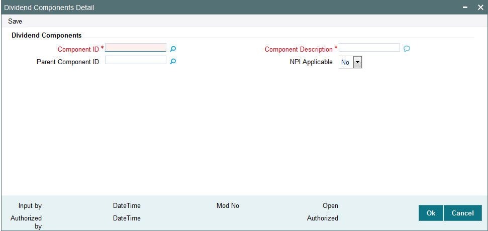

You must define the various components required for validating Prudential Investment Guidelines/Foreign Exchange Compliance under the parameter code “INVESTMENTCOMP”. This is a necessary maintenance required if you have selected Prudential Investment Guidelines as part of the Fund Product categories. The procedure for specifying the investment component code is the same for any other Parameter value to be maintained.

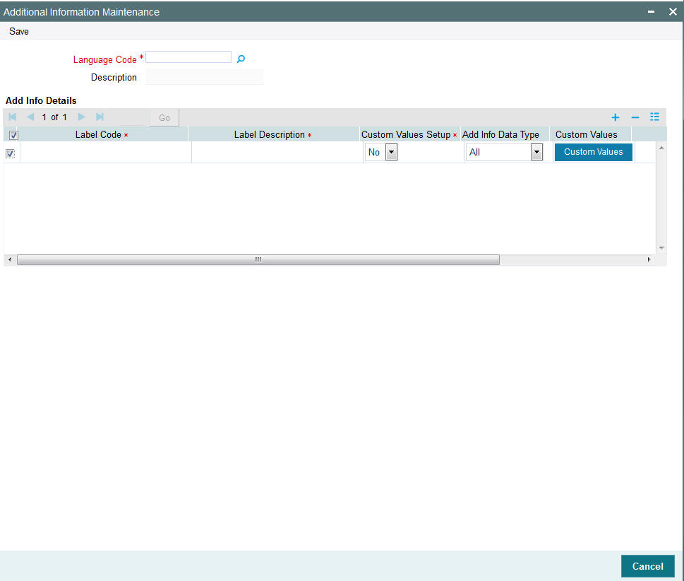

The Oracle FLEXCUBE Investor Servicing system gives you the facility of defining heads under which you can capture any additional information pertaining to any entities that you set up in the system, especially unit holders and brokers.
You can also set up a list of acceptable, valid values for each information head.
To define these additional information heads and their valid values, use the ‘Additional Information Maintenance’ screen. You can invoke this screen by typing ‘UTDADINF’ in the field at the top right corner of the Application tool bar and clicking on the adjoining arrow button.
Select ‘New’ from the Actions menu in the Application tool bar or click new icon to enter the details.
When you open the screen, choose the language for which you want to define the additional information heads, in the Language field.
All previously defined heads for the selected language are displayed in the grid portion of the screen, in the Label Details section, as a list. The following information is displayed for each information head:
To add a new information head, click the Add link in the Additional Information Maintenance screen. A new row is inserted at the bottom of the list.
For each information head you add in this manner, you must specify the following information as mandatory:
To define a set of valid values, click the Valid Values button.
After you have defined the applicable valid values for the information head in the List of Values screen, click the Save button in the Additional Information Maintenance screen to save your changes.

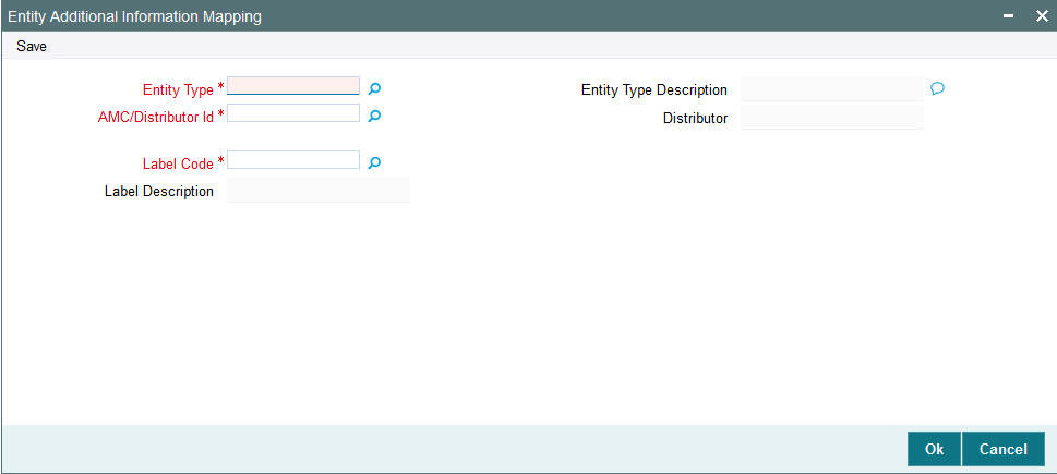

You can also specify the following information for an additional information head:
Linking an additional information head to a system parameter
You can use the Link to Param field to indicate whether the additional information head that is being maintained is linked to a system parameter that has been maintained for the installation. Check this box to indicate such a linkage.
If a linkage is indicated, you must also enter the code of the specific system parameter to which the additional information head is linked. The values maintained for the linked parameter are also applicable for the additional information head. When you click on the Valid Values button, you can select the system parameter to which the additional information head must be linked.
You cannot maintain a restrictive list for an additional information head that is linked to a system parameter.
In the system, when the additional information field that is linked to a parameter code is displayed for data entry, a list of values button is provided for selection of the values defined for the linked parameter code.
Specifying the Param Code to which the Additional Information Head is linked
If the additional information head being maintained is to be linked to a system parameter that has been maintained for the installation, you must also enter the code of the specific system parameter to which the additional information head is linked. The values maintained for the linked parameter are also applicable for the additional information head. When you click on the Valid Values button, you can select the system parameter to which the additional information head must be linked.
Specifying the data type
Select the type of data that can be entered into the additional information field. This specification can be made only for those additional information heads that are not linked to a system parameter.
In the system, when a value is entered into the additional information field, the data type of the entered value is validated by the system.
When you click the Custom Values button for a selected information head in the Additional Information Maintenance screen, the List of Values screen is opened.
The selected Label Code and Label Description are shown in the header portion of the screen.
Any maintained values are listed in the lower grid portion of the screen, in the Valid Value Details section. When you are defining valid values for a new information head, this section is blank, and all the fields are enabled. The information maintained for each value is as follows:
Adding a value to the list
The Add link is available at the bottom of the list, to enable any additions to the list. To add a value, click the Add link. A new row is inserted at the bottom of the list.
For each value you add in this manner, you must specify the following information as mandatory:
Click ‘Ok’ button. Your changes are saved, the List of Values screen is closed, and you are returned to the main Additional Information Maintenance screen.

After you have defined the additional information heads with their valid values in the Additional Information Maintenance screen, you must map them to be applicable during the maintenance of entities.
To do so, use the ‘Entity Additional Information Mapping’ screen. You can invoke this screen by typing ‘UTDENMAP’ in the field at the top right corner of the Application tool bar and clicking on the adjoining arrow button. Select ‘New’ from the Actions menu in the Application tool bar or click new icon to enter the details.
In the Entity Additional Information Mapping screen,
At the time of installation of Oracle FLEXCUBE Investor Servicing, the implementers set up codes for fee categories that will be deemed applicable for specific investor categories. They also set up a list of fee sub-categories that would be considered valid for each fee category.
The implementers set up these codes and values based on the requirements at each installation.

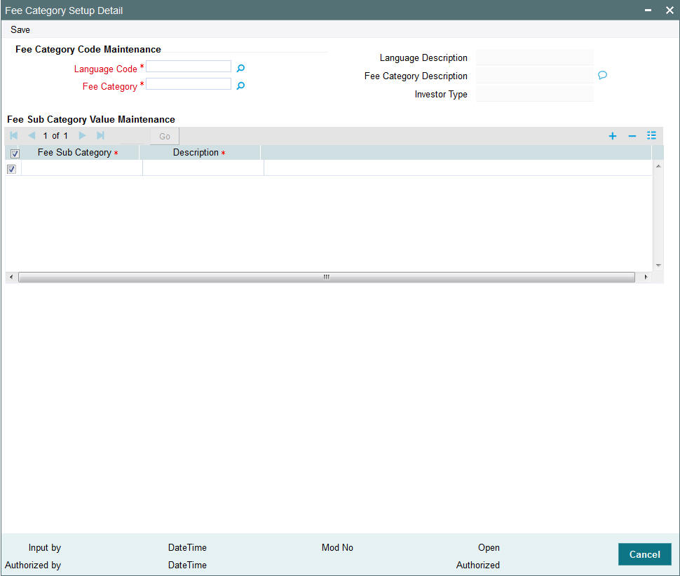

You as a user will be able to add to a list of fee sub-categories for a fee category code. However, you cannot set up any new fee categories.
To view a list of defined fee category codes or add any new fee sub-categories, use the ‘Fee Category Setup Detail’ screen. You can invoke this screen by typing ‘UTDFEECA’ in the field at the top right corner of the Application tool bar and clicking on the adjoining arrow button.
When you open the screen, choose the language for which you want to view the defined fee category codes, in the Language field.
All defined fee categories for the selected language can be viewed on clicking the option list for the Fee Category Code. The following information is displayed on clicking:
The selected Fee Category Code and Fee Description are shown in the header portion of the screen.
Any maintained values for fee sub-category are listed in the lower grid portion of the screen. The information maintained for each fee sub-category is as follows:
Adding a new fee sub-category to the list
The Add link is available to enable any additions to the list. To add a fee sub-category, click the Add link. A new row is inserted at the bottom of the list.
For each fee sub-category you add in this manner, you must specify the following information as mandatory:
Click ‘Ok’ button. The Fee Sub Category Value Maintenance screen is closed, and you are returned to the main Fee Category Code Maintenance screen. Here, click the Save button to save your changes.

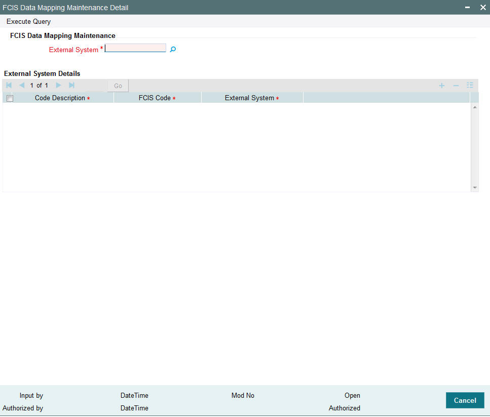

You can map data from external systems to FCIS using the ‘FCIS Data Mapping Maintenance Detail’ screen. You can invoke this screen by typing ‘UTDDMAP’ in the field at the top right corner of the Application tool bar and clicking on the adjoining arrow button.
External System
2 Character Maximum, Mandatory
Select the external system from which the data needs to be mapped. The options being:
Code Description
Select the category of codes from factory shipped values available.
FCIS Code
Select the corresponding factory shipped value available in FCIS for the specified category code.
External System Code
Specify the external system code here.
Note
If the code description selected from the available list is linked to any existing PARAMS, system would display all valid codes irrespective of the maintenance.

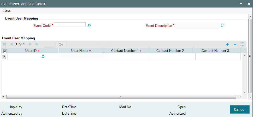

FCIS provides the facility to map the users responsible for each event that can be raised during the End of Day (EOD) process. You can also capture the user’s telephone numbers.
To map an EOD operator with an event, use the ‘Event User Mapping Detail’ screen. You can invoke this by typing ‘UTDEUMAP’ in the field at the top right corner of the Application tool bar and clicking on the adjoining arrow button. Select ‘New’ from the Actions menu in the Application tool bar or click new icon to enter the details.
Event Code
Select the event for which you wish to map a user from the drop-down list. The list contains all the valid event codes maintained in the system.
Event Description
Display Only
On selecting the event code, the system displays the description of the event code.
User ID
Select the User Id of the person who is to be mapped to the chosen event. The list contains all the valid users maintained in the system.
Contact Numbers 1 – 3
Alphanumeric, Contact Number 1 is Mandatory
Enter the contact telephone numbers of the user. You can enter up to three contact numbers.
Earnings from a dividend can be classified as permissible or non permissible. As per Shariah laws, non permissible income cannot be reinvested into the fund.
You can maintain dividend component details in the ‘Dividend Components Detail’ screen. You can invoke this screen by typing ‘UTDDVCOM’ in the field at the top right corner of the Application tool bar and clicking on the adjoining arrow button. Select ‘New’ from the Actions menu in the Application tool bar or click new icon to enter the details.
You can specify the following fields in this screen:
Component ID
2 Character Maximum, Alphanumeric, Mandatory
Enter a unique identifier for the dividend component that is to be classified as Non permissible income.
Component Description
Enter a description of the component.
NPI Applicable
Check this option to indicate that income from this component is non permissible.
Parent Component ID
Mandatory if the component is NPI Applicable
If the component has been classified as NPI Applicable then specify the parent dividend component. The parent component specified here will be used for reporting purposes. The option list contains the valid dividend component Ids maintained in the system.

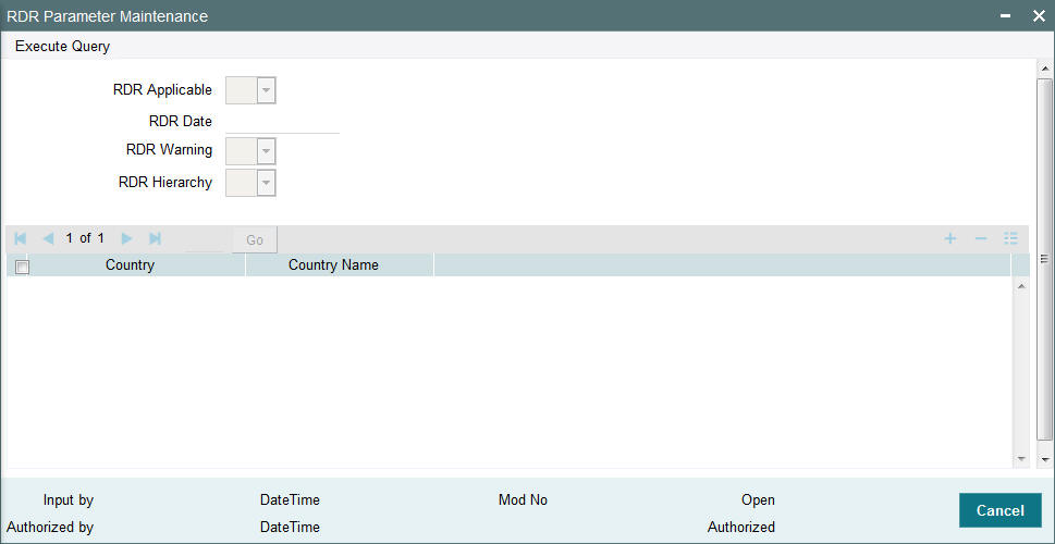

You can maintain RDR Parameters using ‘RDR Parameter Maintenance’ screen. You can invoke this screen by typing ‘UTDRDRPM’ in the field at the top right corner of the Application tool bar and clicking on the adjoining arrow button.
You can specify the following details:
RDR Applicable
Optional
Select if RDR is applicable or not from the adjoining drop-down list. Following are the options available:
RDR Date
Date Format; Optional
Specify RDR date.
RDR Warning
Optional
Select if RDR warning is applicable or not from the adjoining option list. Following are the options available:
RDR Hierarchy
Optional
Select if RDR hierarchy is applicable or not from the adjoining option list. Following are the options available:
Country
Alphanumeric; 8 Characters; Optional
Specify the country code. This adjoining option list displays all valid country code maintained in the system. You can choose the appropriate one.
Country Name
Display
The system displays the name of the country for the selected country code.
