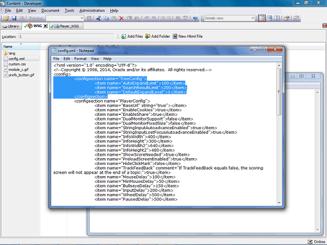

We want to copy the ShowFrameID element, which is near the end of the section; however, we also need the PlayerConfig section tags.
Rather than copy the entire section for just one tag, we are going to copy the beginning section tag and the element tag separately.
You can copy the entire line if you want to preserve the indentations. As long as elements are under the correct section name, they do not have to be indented, but the indentations help to group and organize them. After pasting an element, you can use the TAB key to indent tags.
