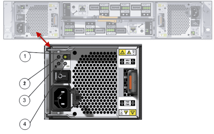

The following figure shows the power cooling module LEDs.
Figure 1 Power cooling module LEDs Power cooling module LEDs
Legend
1 Status indicator 3 Fan fail indicator
2 AC fail indicator 4 DC output fail indicator
