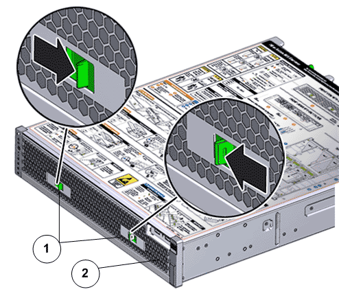

front of the Controller chassis,
locate the air filter release tabs.
- Press the release
tabs inwards at the same time to unlock the tabs and disengage the
air filter.
Figure 1 Air filter
release tabs
- Legend
1 Release
tabs |
2 Air
filter |
