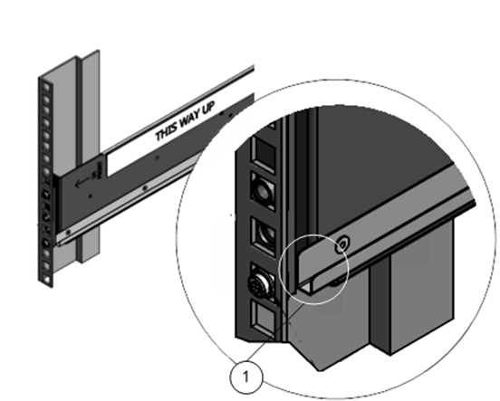

| 1 Left rail channel |
Using a flashlight, visually check to see that the sliders on both sides of the Drive Enclosure are in the rail channels on both sides of the rack. If the Drive Enclosure side sliders are not in the rail channels, then the Drive Enclosure is not seated. You must reinsert the Drive Enclosure.
Ensure that the Drive Enclosure slides smoothly into the rack and out of the rack. If the Drive Enclosure does not slide smoothly in and out of the rack, then the Drive Enclosure is not seated. You must reinsert the Drive Enclosure.

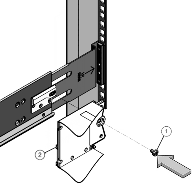

Ensure that the screw hole at the back of the Drive Enclosure aligns with the screw hole on the rail. Do not secure the screw, yet. If the screw hole at the back of the Drive Enclosure does not align with the screw hole on the rail, then the Drive Enclosure is not seated. You must reinsert the Drive Enclosure.
| 1 Phillips Number 2 pan head screw with patch lock | 2 Back of the Drive Enclosure |

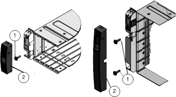

| 1 Phillips 13mm head hex flange screw | 2 Left front-side cap |
