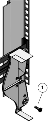

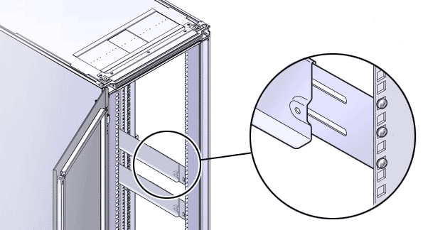

The DE2-24C Drive Enclosure rails have a ledge along the bottom of the rail to allow you to slide the Drive Enclosure into the rack. To verify that the Drive Enclosure is seated correctly in the rails, ensure that the bottom edges on both sides of the Drive Enclosure slide along the left and right rail ledges.
| 1 Phillips Number 2 pan head screw with patch lock |
| 1 Phillips 13mm head hex flange screw | 2 Left front-side cap |
