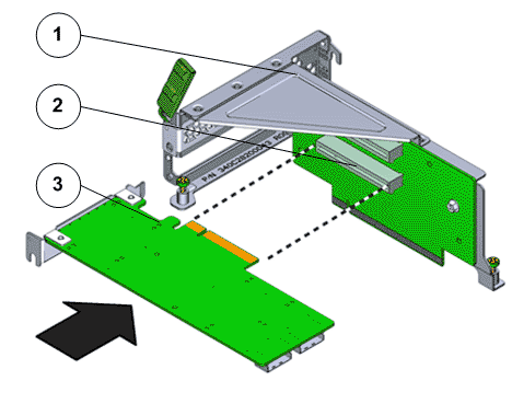

  2. Orient the HBA so that the brackets of the HBA align with the alignment pin in the PCIe slot of the riser.
    Important! Hold the HBA by the edges. Do not touch the metal contacts on the bottom of the card.
  3. Push the connectors on the edge of the HBA into the PCIe slot by pushing firmly to seat the card.
    Figure 1 Insert HBA into riser slot Insert HBA into riser slot
    Legend
    1 Riser
    2 Riser slots
    3 HBA

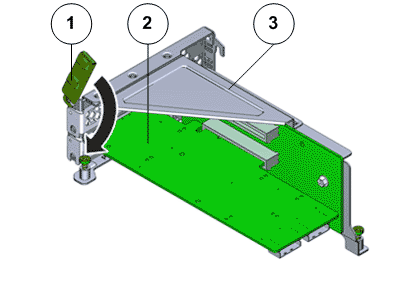

  5. When all HBAs have been installed in this riser, swing the retainer latch to its fully closed position. If there is resistance, check the alignment of the HBA and try again.
    Figure 2 HBA retainer latch HBA retainer latch
    Legend
    1 Riser retainer latch
    2 HBA
    3 Riser
