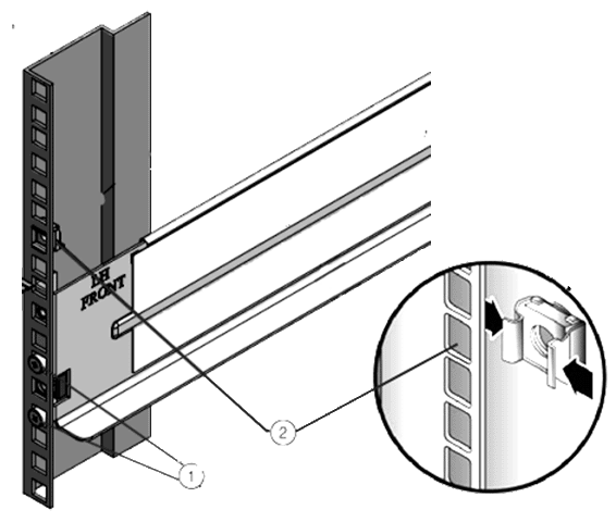

To locate the eighth rack hole, count eight holes upward from the bottom rail location peg.
| 1 Rail-location pegs | 2 Cage nut |

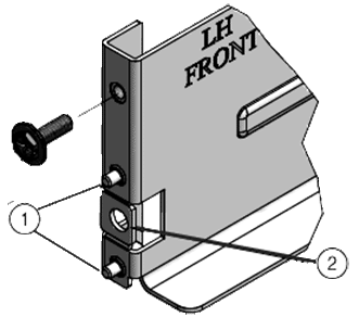

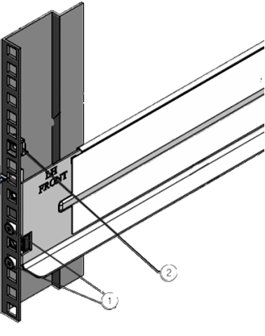

| 1 Rail location pegs from inside of the rail flange | 2 Clip nut |
Make sure the rail flange aligns with the inside of the rack flange and the rail label faces the inside of the rack.
