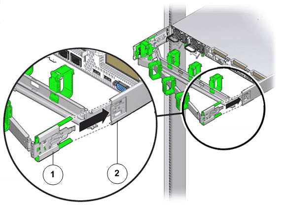

  4. Insert the CMA’s mounting bracket connector into the back of the right slide rail until the connector locks into place with an audible click.
  5. Insert the right CMA slide rail connector into the back of the right slide rail assembly until the connector locks into place with an audible click.
    Figure 1 CMA slide rail connector inserted into the back of the right slide rail CMA slide rail connector inserted into the back of the right slide rail
    Legend
    2 Right slide rail
    Note: The CMA in the graphic is for representation only. The CMA shipped with your Pilot might be slightly different.
