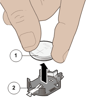

Remove a Battery
  1. Remove the battery by placing your finger or a pointed tool like a screwdriver under the battery on the side nearest to the back of the Pilot and gently lifting the battery out of the retainer.
    Figure 1 Pilot battery removal Pilot battery removal
    Legend
    1 Pilot battery
    2 Battery socket
  2. Place the battery on an antistatic mat.
    Note: Replacing a battery usually resets the CMOS settings to a default value.
