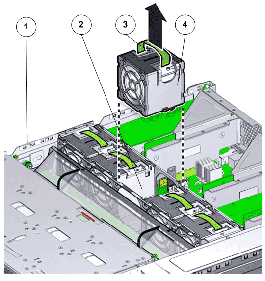

Remove a Fan Module
  1. Using your thumb and forefinger, grasp the removal tab and gently lift the fan module from the fan compartment.
    Figure 1 Remove fan module  Remove
fan module
    Legend
    1 Controller chassis
    2 Fan compartment
    3 Removal tab
    4 Fan module
    Note: Pulling the green tab from the middle releases the locking tab for each individual fan.
    Note: When removing a fan module, do not rock it back and forth. Rocking the fan module can cause damage to the motherboard connectors.
  2. Set the fan module aside.
    Note: The fan compartment might come out when the last fan module is removed.
