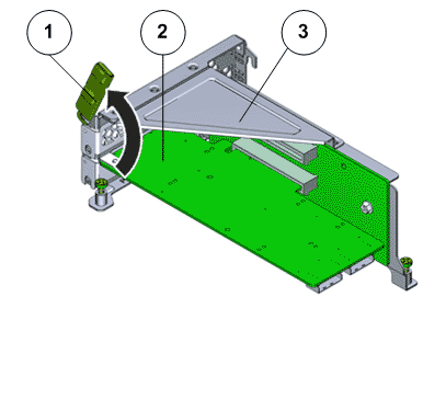

  2. Swing the riser retainer latch (for riser 3) to its fully open (180 degrees) position.
    Figure 1 Unlock riser retainer latch to release HBA Unlock riser retainer latch to release HBA
    Legend
    1 Riser retainer latch
    2 HBA
    3 Riser
