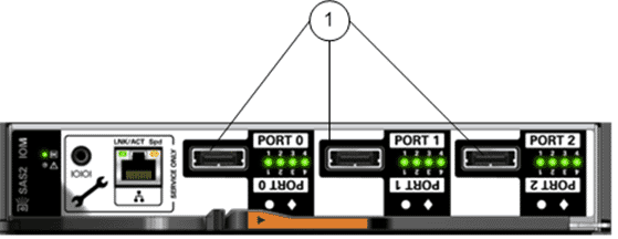

  1. When Guided Maintenance prompts you to remove the component, label and disconnect the SAS interface cables that are attached to the I/O module.
    After replacing the I/O module, you will be required to restore the SAS interface connectors to the same configuration as prior to replacement.
    Figure 1 I/O module SAS connector ports I/O module
SAS connector ports
    Legend
    1 SAS connector ports

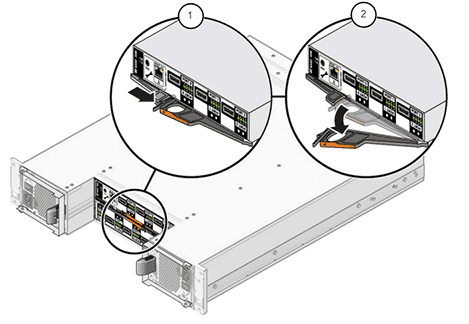

  2. Using your thumb and forefinger, squeeze the release button toward the lever hole to release the lever.
    Figure 2 Remove the I/O module Remove
the I/O module
    Legend
    1 Release button 2 Lever
  3. Pull the lever and remove the I/O module from the Drive Enclosure.
    Note: Be careful not to damage the connector pins.
