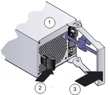

  4. Release the attachment lever.
    To release the attachment lever, squeeze together the latch and the opposite side of the failed power cooling module.
    Figure 1 Attachment lever and latch on the power cooling module Attachment lever and latch on the power cooling module
    Legend
    1 Power cooling module 3 Attachment lever
    2 Latch
