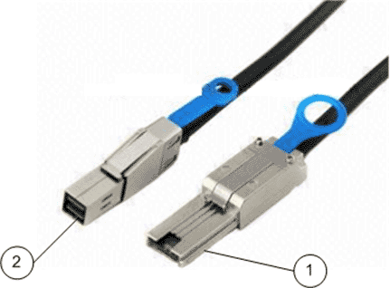

Mini-SAS to mini-SAS HD |
Black |
Connects a Controller to a Drive Enclosure in the same rack |
Varies based on the configuration of the system |
9.84 feet (3 m) |
Black |
Connects a Controller to a Drive Enclosure that is in a separate rack |
19.69 feet (6 m) |
| 1 Mini-SAS connector | 2 Mini-SAS HD connector |
