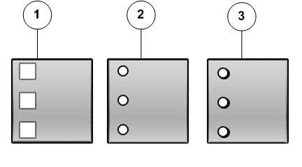

Controller rail kits can be installed in the Sun ™ Rack 900, the Sun Rack 1000, and third-party ANSI/EIA 310-D-1992 or IEC 60927 compliant racks with the following types of holes:
Figure 1 Examples of supported rack holes
- Legend
1 Square holes |
2 Round holes |
3 Threaded holes |
