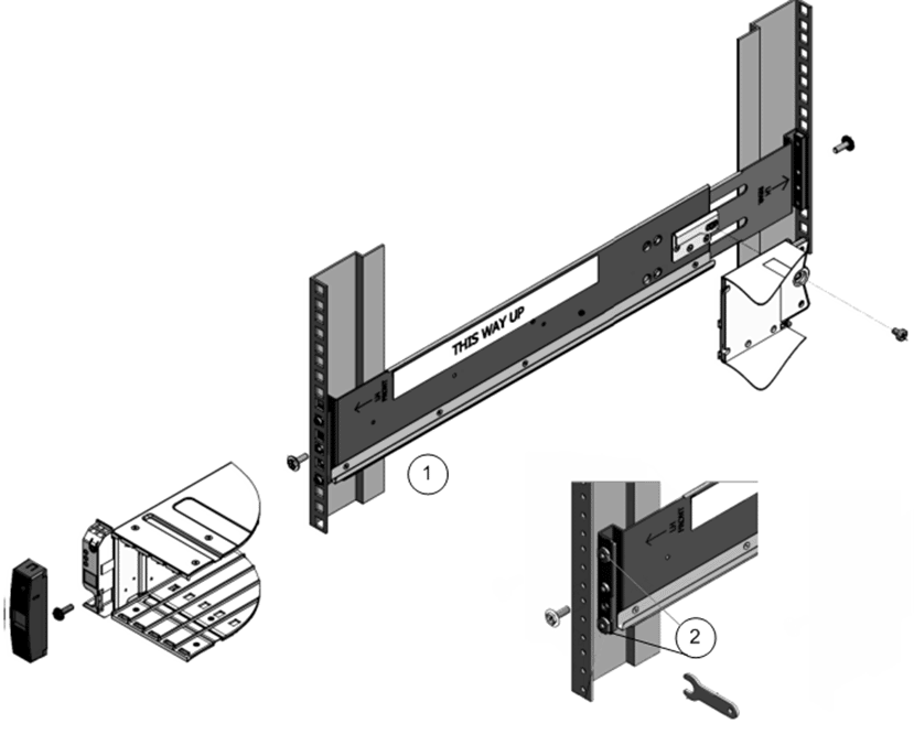

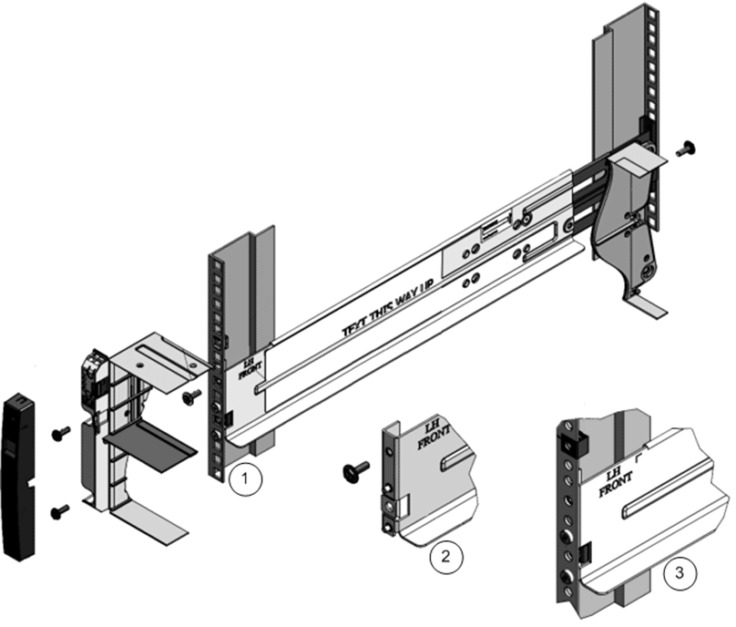

To prepare a rack for adding Drive Enclosures to the Oracle Flash Storage System, you must install rails in the rack for each Drive Enclosure that you plan to add. Oracle includes rail kits in the Drive Enclosure packaging.
Use one of the following racks for the Drive Enclosure:
Sun Rack II 1042/1242 rack
Any 19-inch wide, four-post, EIA-compatible rack with a front-to-back depth between vertical cabinet rails of 24 inches to 36 inches (61 cm to 91 cm)
Drive Enclosures rail kits can be installed in racks with the following types of holes:
Square
Round
Threaded (must be M6 or 10-32 racks)
1 Square holes | 3 Threaded holes |
2 Round holes |
1 Left-side rail for square-hole and round-hole racks | 2 Adaptor pins for threaded-hole racks |
1 Left-side rail for square-hole racks | 3 Round-hole racks |
2 Threaded-hole racks |
