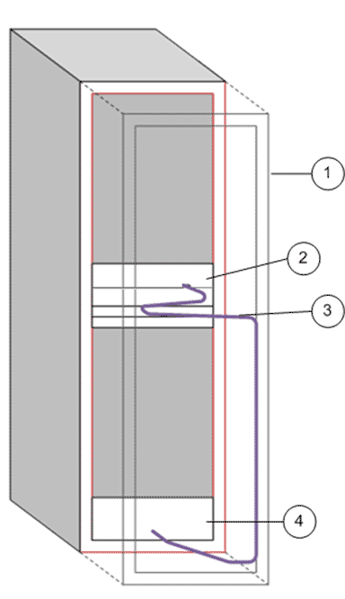

The following figure shows an example of routing a cable from a Controller to a Drive Enclosure, both of which are located in the same rack.
Figure 3 Routing a cable same rack (Controller to Drive Enclosure) Routing a cable same rack (Controller to Drive Enclosure)
Legend
1 Back of a rack 3 CMA
2 Controller 4 Drive Enclosure
