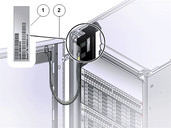

  1. Attach one SSN label to the top left at the back of the rack.
    Figure 1 SSN label location: (top of the left PDU in the rack) SSN label location: (top of the left PDU in the rack)
    Legend
    1 SSN label
    2 Rack

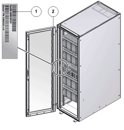

  2. Attach one SSN label on the door jam towards the middle on the left frame at the front of the rack.
    Figure 2 SSN label location: (middle of the left frame at the front of the rack) SSN label location: (middle of the left frame at the front of the rack)
    Legend
    1 SSN label
    2 Rack

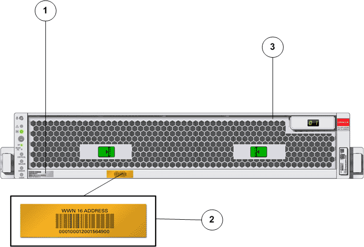

  3. Attach the World Wide Node Number (WWnN) label on the chassis of the bottom Controller at the front to the right of the Controller product serial number label.
    Figure 3 WWnN location: (Controller front next to SSN label) WWnN location: (Controller front next to SSN label)
    Legend
    1 Pre-existing Controller SSN label on the chassis
    2 WWnN label
    3 Controller front
