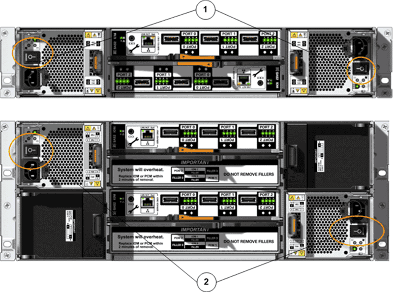

- Ensure that the power switches on the Drive Enclosures are switched on.
Figure 1 Power switches on the Drive Enclosures
- Legend
| 1 The power switches on the DE2-24P Drive Enclosure |
2 The power switches on the DE2-24C Drive Enclosure |

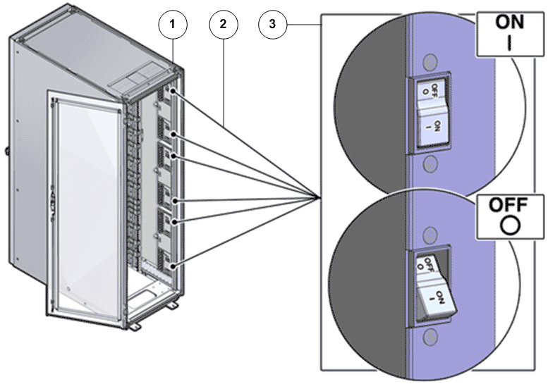

- Power on the PDU circuit breakers to apply power to the system.
Figure 2 PDU circuit breakers (example)
- Legend
| 1 Rack |
| 2 Example of PDU circuit breakers |
| 3 Toggle switch |
Note: The Controllers and the Pilots automatically power on when you apply power to the system.
