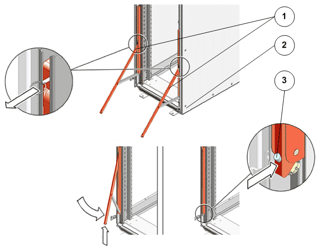

Retract the anti-tilt legs on the rack when you have completed installing or servicing a component inside the rack to ensure that no one trips over the anti-tilt legs.
- Pull on the anti-tilt leg release pin to unlock the anti-tilt leg and lift it off of the floor.
Tip: If necessary, retract the anti-tilt leg’s leveling foot by turning it counterclockwise.
Figure 1 Retract anti-tilt legs
- Legend
| 1 Anti-tilt legs |
| 2 Rack |
| 3 Release pin |
- Push the anti-tilt leg securely into the rack.
Note: The anti-tilt leg should lock into place.
- Repeat steps 1 to 2 to retract the other anti-tilt leg.
